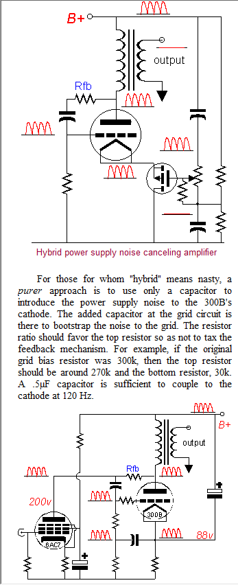

In a certain way this is still a "brute force" approach. In tubecad was an article that used AC fed into the cathode or the grid of the power tube to cancel PSU noise (not necessarily only 100/120Hz).

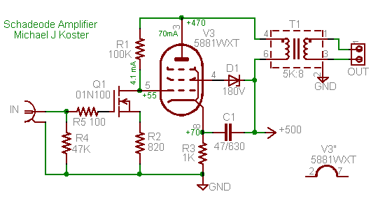

I'm familiar with that approach, and have used it with great success in the Schadeode hybrid design attached.
http://www.diyaudio.com/forums/tube...ar-triode-strapped-pentode-7.html#post2204502
You need to apply the power supply noise more or less equally to cathode and grid, and g2 if it's a pentode, to match the noise on the plate. Since it's the same signal, it doesn't matter what the shape of the noise/ripple waveform is. It's also important to keep any of the injected noise from intermodulating with the signl in the driver.
In the Schadeode circuit, the same PS noise that appears on the plate is injected to the cathode through "ultrapath" capacitor C1, injected to the g2 through zener string D1, and to the control grid through the 100K feedback resistor R1, which works into high impedance. The high impedance of the MOSFET Q1 prevents intermodulation of the noise with the grid drive signal.
Michael
PS the circuit would work as well with a pentode in place of Q1, but would need more voltage, a g2 supply, heaterpower...

I can only answer the OC3 question:
In this schematic the g2 current is less than the minimum amount required by the voltage regulator so it will not work reliably. (Gas voltage regulators need a lot more current than a zener to operate properly.)

It works only when the tube is idle. When it works it's transconductance changes, that causes intermodulations between signal and ripples (often is characterized by audiophilitics as lack of details and fuzzy soundstage).
Right, 5 mA minimum. So a resistor to ground will be needed.

PS: but I personally would prefer to connect VR tubes between screen grid and cathode, such a way a resistor will limit max current through the screen grid, and dynamic resistance of the screen grid source in respect to cathode would be minimal.

What I propose, is completely different.
2 tubes in series connected between screen and cathode. A resistor from B+ to screen sets the current (40 mA max). No capacitor in parallel with VR tubes, so they are happy.

I published FFTs down to -100 db. There is no intermodulation with the ripple because there is no current path between the ripple and signal.

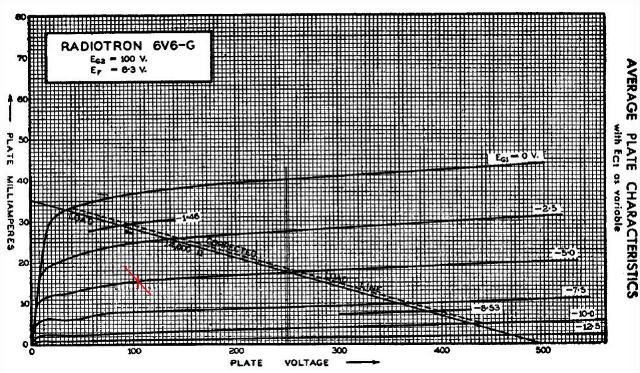

The input tube serves as a V-to-I converter and only needs plate swing equal to the output tube grid swing, so gm is the metric rather than gain. Only a couple of mA/volt is needed so the 6V6 would do the job. A pentode driver would be more linear with a little additional idle current through a separate branch e.g. a plate resistor in addition to the feedback resistor.

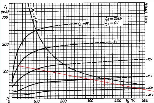

6V6 and EL34 is a combo I would like to try. I would run the 6V6 at 100V g2 and the EL34 at 60mA/350V with 250V on g2. For the driver idle point I think somewhere around -5Vg and 16mA would be a start. With a 330 ohm Rk the driver slope would be about 1.8mA/V input. Assuming 2VRMS desired sensitivity, the feedback resistor would want to be about 75K. At 365V P-G the current through the feedback resistor is about 5mA, requiring another 11mA through a plate resistor of about 36K ohms for a total of 16mA. The 6V6 works into about 3K ohms load.
The cathode resistor for the EL34 could be 2K ohms for about 120V on the cathode which would put the grid and 6V6 anode a little over 100V. Some g2 supply will be needed for the 6V6. Looks like B+ would need to be about 500V.
It sounds reasonable. I forgot to add in the fixed plate resistor load to the sensitivity calculation but it's close enough to show feasability.
