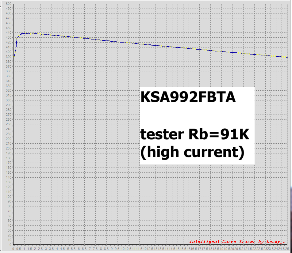

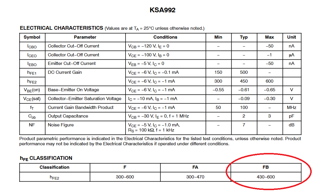

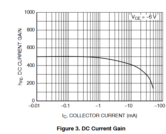

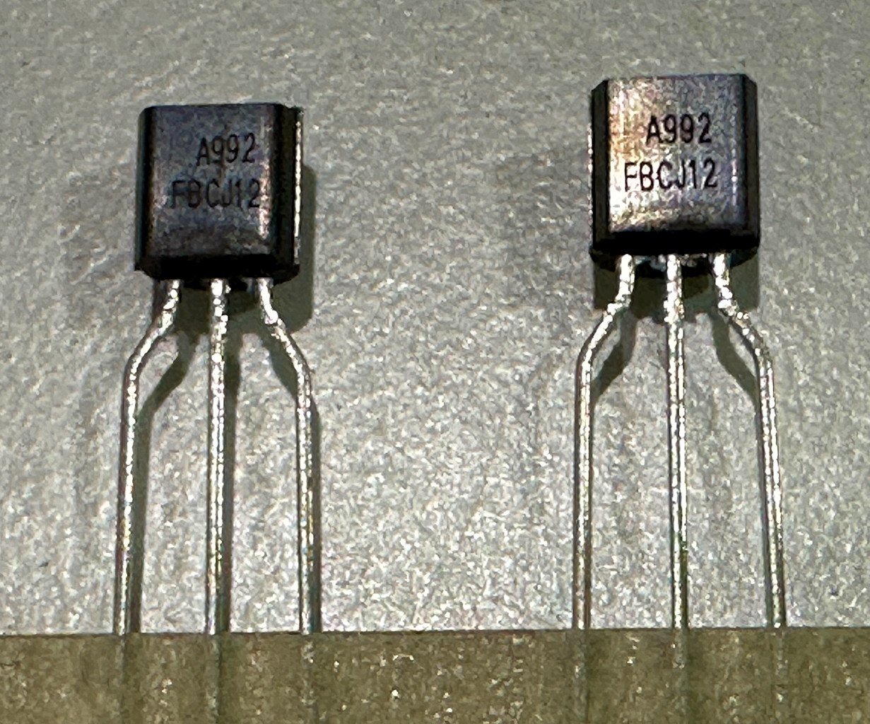

The Locky-Z curve tracer's Hfe -vs- Icollector function is a little wonky at very low currents, and unfortunately a high-Beta PNP has extremely low base current when Icollector is less than a milliamp. So the far left edge of the attached plot, is not terribly trustworthy. Rb=91K was selected so that I could plot all the way out to 25mA of collector current. Measurements were taken this morning.

In this context (early voltage), KSC1845/KSA992 are not bad at all.
Those Toshiba ones are very close to their SC2240BL -SA970BL.
The hFE is flat up to 30mA.
Even the GR ones are 200 - 400.
