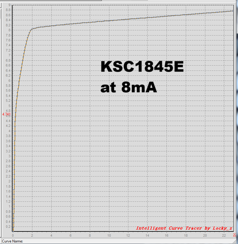

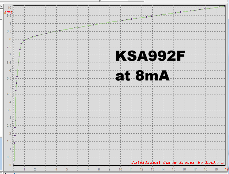

[Re: KSC1845F/KSA992F] ... From the datasheet, their early effect looks wild. They won’t work well in VAS.
I curve traced those a while ago. KSC1845E { 400 < Beta < 800 } and KSC992F { 300 < Beta < 600 } . Plots attached.
The software insists on plotting PNPs in the first quadrant instead of the third, sorry about that. Horizontal axis is abs(Vce) in volts, vertical axis is abs(Ic) in milliamps.

Using two data points from the measured Ic vs Vc curve, we can extrapolate to find the Early voltage
  • Vearly = [ I1 * (V2 - V1) / (I2 - I1) ] - V1
For the plots in post #28, I get
  • KSC1845E Early Voltage = 269V
  • KSA992F Early Voltage = 82V
Among the PNP small signal transistors I've tinkered with, the ones with the highest (Beta * Vearly) product {a figure of merit championed by Bob Cordell and others}, were high voltage devices from Zetex / Diodes Inc. Vce_max ratings of 300V and higher. Only measuring TO-92 and E-LINE, not TO-126 or TO-225.
Thus, if the bias point is 20v 10ma, the output impedances are about 30K/10K.
And the "mu" values (maximum possible voltage gain with an ideal constant current load: mu = gm * rout) at 10 mA, are
KSA992F: mu= (0.010 / 0.0260) * 10K = 3,800 volts per volt
KSC1845E: mu= (0.010 / 0.026) * 30K = 11,500 volts per volt
Don't remember the others except I do recall that the MJEs from Diodes Inc were noticeably better than Onsemi and ST. But Diodes Inc only sold them in surface mount DPAK.
edit - just for fun -
The voltage gain of a KSA992F PNP common emitter amplifier at 10mA and Vce=20V, when loaded by a NPN constant current source built with a KSC1845E, is (0.010 / 0.026) * (10K || 30K) = 2,885 volts per volt. Assuming that neither one has an emitter degeneration resistor. The arithmetic is delightfully symmetric, the gain is the same when the amplifier is NPN and the constant current source is PNP. I think a stage gain of 2885 is acceptable.
