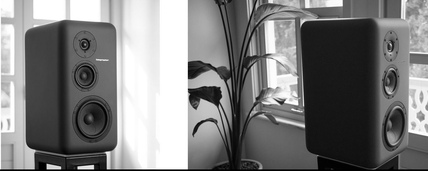

The "Telegrapher Studio 20" is a three-way, active, near-field monitor, designed for critical mixing and mastering applications. This bookshelf speaker uses a cabinet with large radius edge rounds for low diffraction distortion, and ScanSpeak Illuminator 1"+4"+7" drivers.
Studio 20 - Telegrapher Loudspeakers

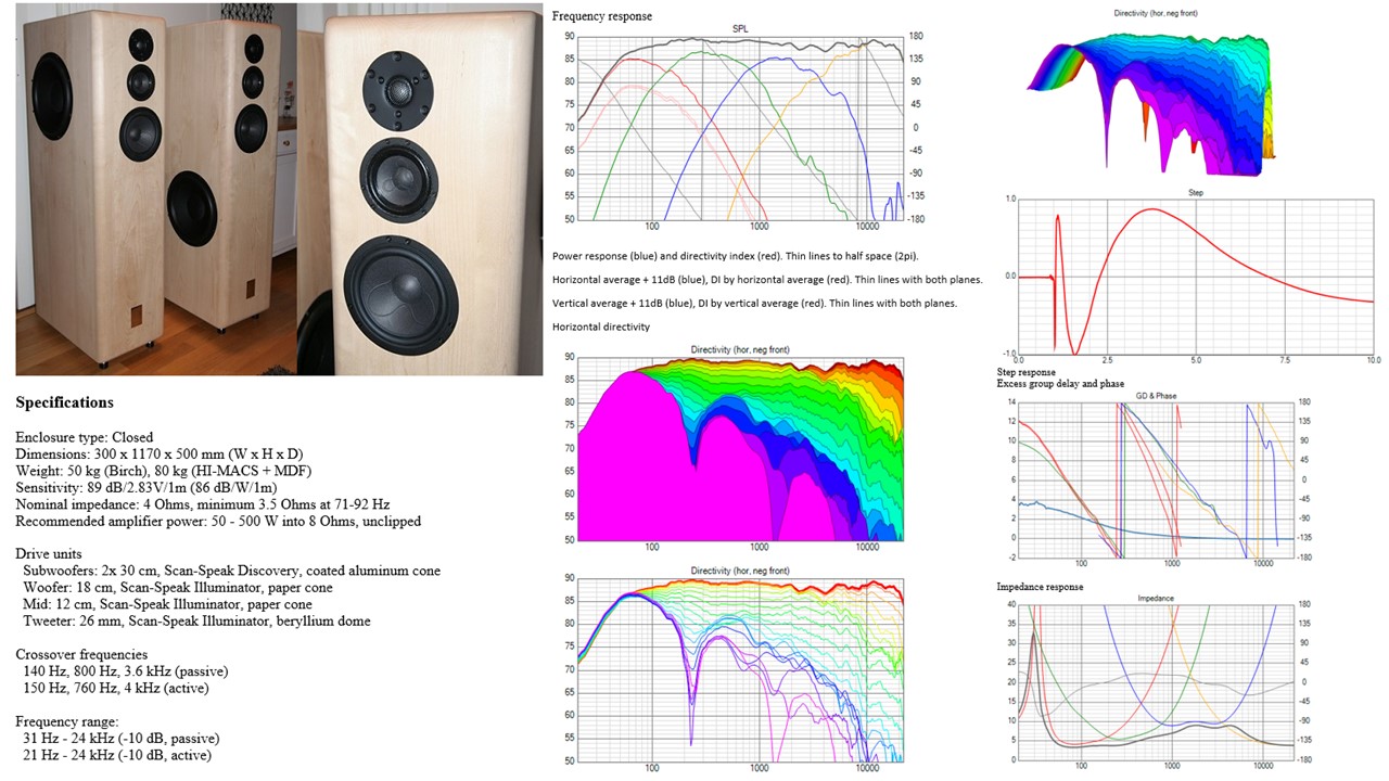

The Taipuu 4-way active speaker extends large edge rounds into a floor standing cabinet with ScanSpeak Illuminator drivers.
Taipuu Speakers - Taipuu Speakers
