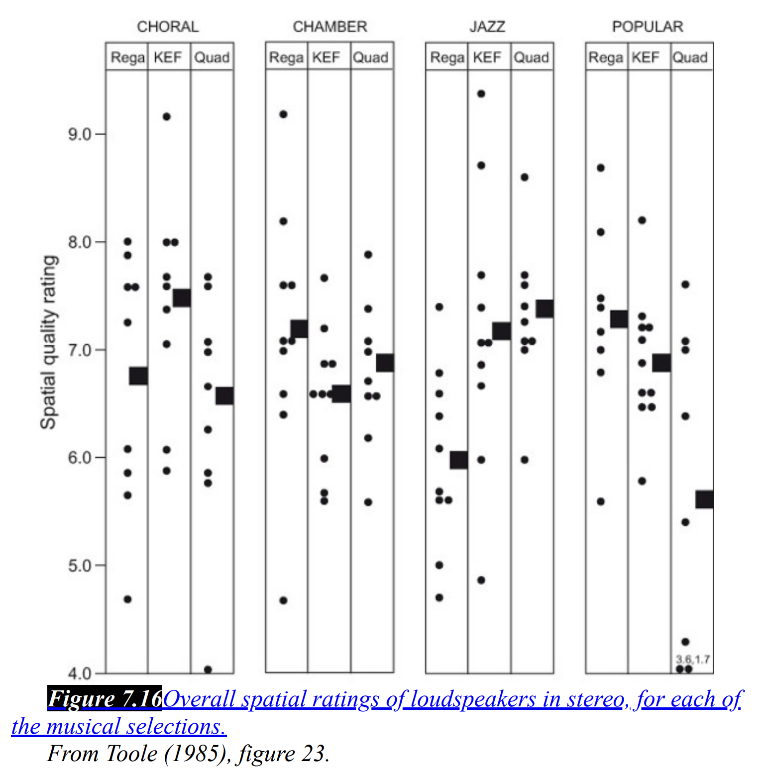

I'm using DSP to experiment with a midrange module where waveguides/horns are impractical because they get too large. Active noise cancelling from 150Hz to 500Hz then a transition to cardioid/dipole up to 1,000Hz. None of that is settled because I'm experimenting. I might wind up with active noise cancelling all the way to 1,000Hz.
I'm designing it for HiFi listening not music editing. But, I can turn the active noise cancelling on and off as well as shift the frequencies around because it is DSP. If I wanted to hear the mid-bass region clearly -- or listen for flaws that might be masked by lower frequencies -- I'd turn on noise cancelling. If I wanted to hear what a typical speaker sounded like in that region I'd turn off the noise cancelling. The neat thing is the ability to do it on the fly.
I'm going to build a flexible module above 1,000Hz as well. The reason I am creating flexible modules is because Floyd Toole demonstrated how different styles of music sound better or worse with different types of directivity.
I'm not suggesting doing any of this because I have no idea how to edit music. And it might be ridiculous in the context or creating music rather than listening.

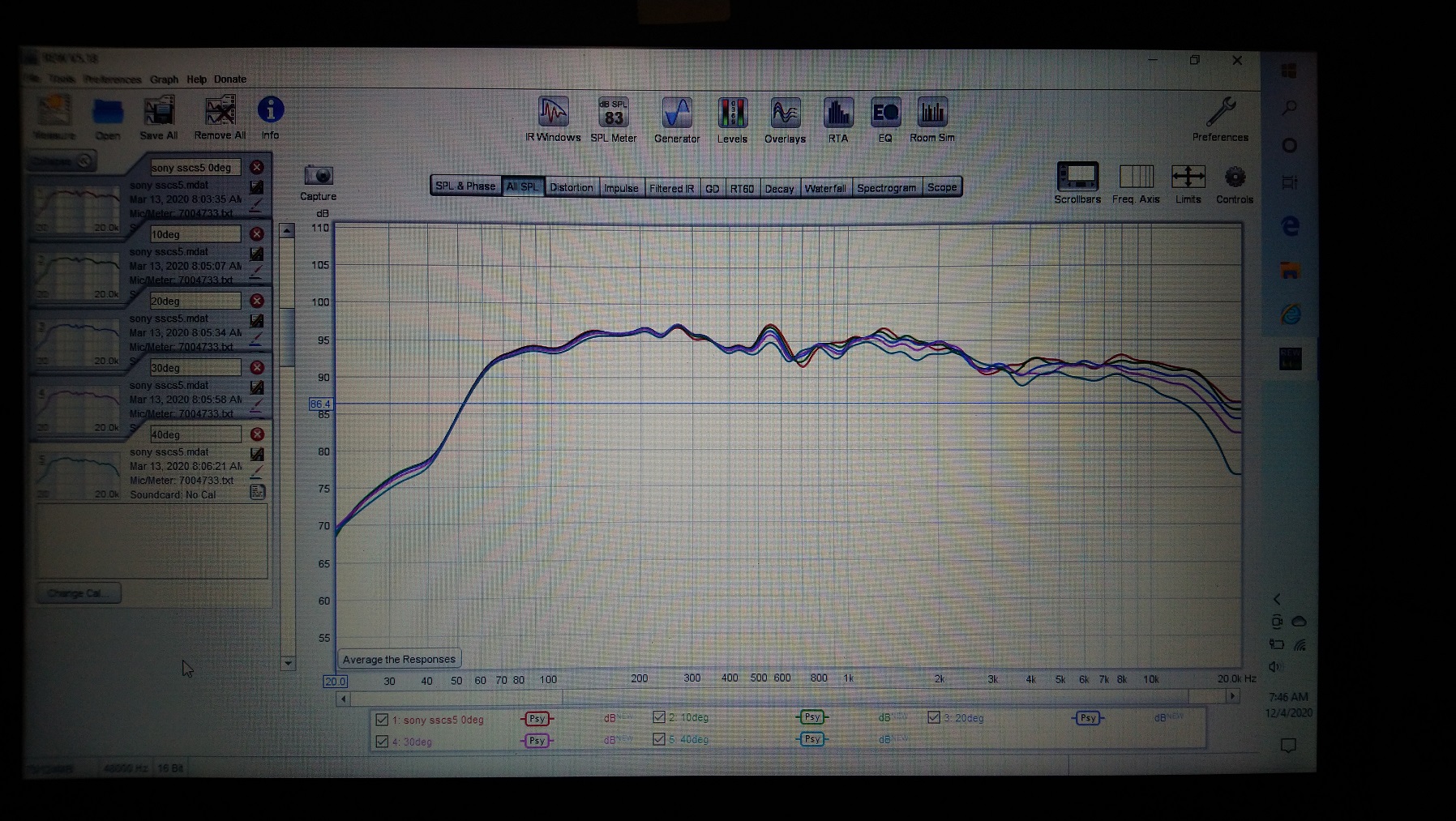

A friend of mine dropped his bookshelf speakers at my place. Sony ss-cs5. Three way with two domes and small midbass. I listen to them, i like what i hear. I measured them, they have impeccable spec, ruler flat response and great of axis behavior.
They need sub though.

Just from the photo I knew the vertical off-axis was going to be garbage. Why have a 3/4" tweeter with a 1" tweeter, and at a substantial c-c distance no less?

are you listening vertically?
