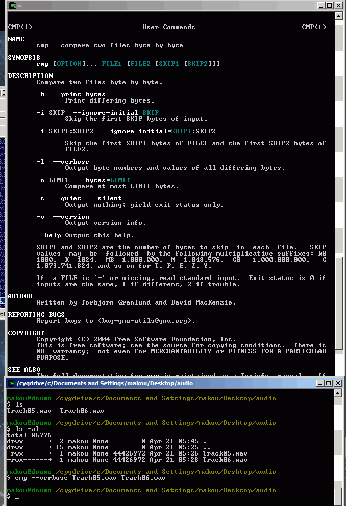

mako1138 said:The files are absolutely identical, as expected.
Well, finally an open source tool that I am confident provides correct information. Generally, I do not believe 100% that closed-source tools do exactly what their authors claim.
I've used both like Hugo found the Audition method lets you see and "listen" 🙂 to the result. How on earth would Audition/CoolEdit know you are loading two identical files to compare?
I once wrote a file compare utility for checking hard drive backups to CD, it could find one wrong bit in 650MB of data, it surely can't be that difficult to compare two wav files

Not if you are checking two datasets for identity - there is no more reliable method than bit by bit.
