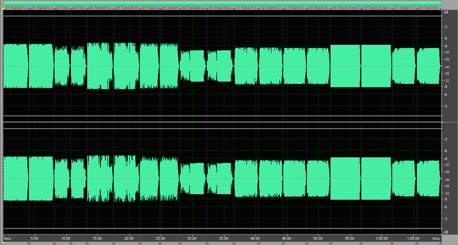

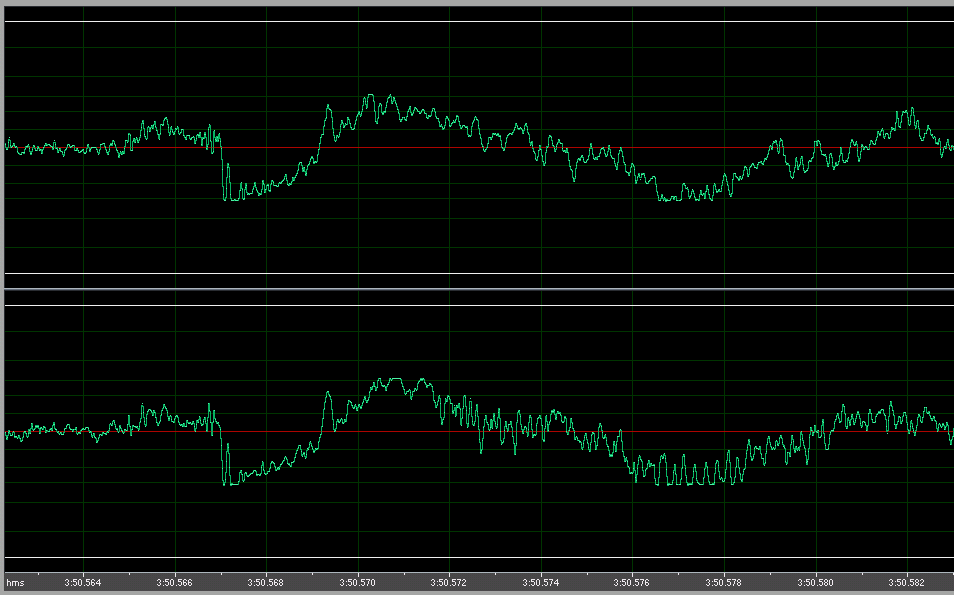

Gentleman, I repeat: If you agree that 1 minus 1 equals zero, you will agree that if the result from two detracted files is zero, the files are identical. Failing to do so is not only deluding yourself but dismissing one of the very first things we learned in school.
Apart from listening, I did just that with the CD I got from SandyK.
The net result was silence. I have listened to that silence too and heard nothing.
Audition is utterly precise in detracting files and if only one single bit were different, it would have been visible. I believe that is the ultimate way to make the difference between two files visible and audible.
There is however one thing that should be mentioned:
The music on the CD is highly compressed and distorted. It could be that SandyK’s high resolution playback system behaves unstable when it get fed clipped music.
/Hugo
