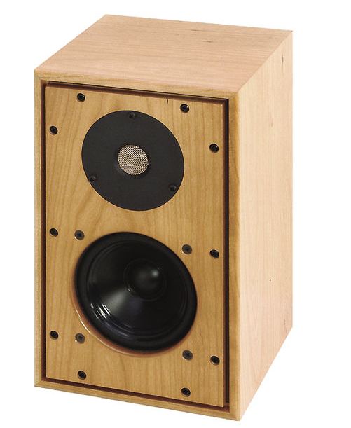

As an engineer, I noticed the LS3/5A was a negative polarity solution on a recessed baffle, here a Harbeth homage:
310915d1352432198-read-found-lossy-cabinet-designs-harbeth-harbeth_hl_p3_outer-jpg
Very unusual.

Worst thing about the Harbeth version Steve, is the grille.
The LS3/5A I'm used to have the recessed grill, not the best thing for diffraction, but BIG caveat being, at least it has heavier 1/2" square felt on all edges.
That Harbeth has none. I didn't think it was possible to deal with that baffle aspect WORSE than KEF, Goodman's, Roger's, but it looks like they do.

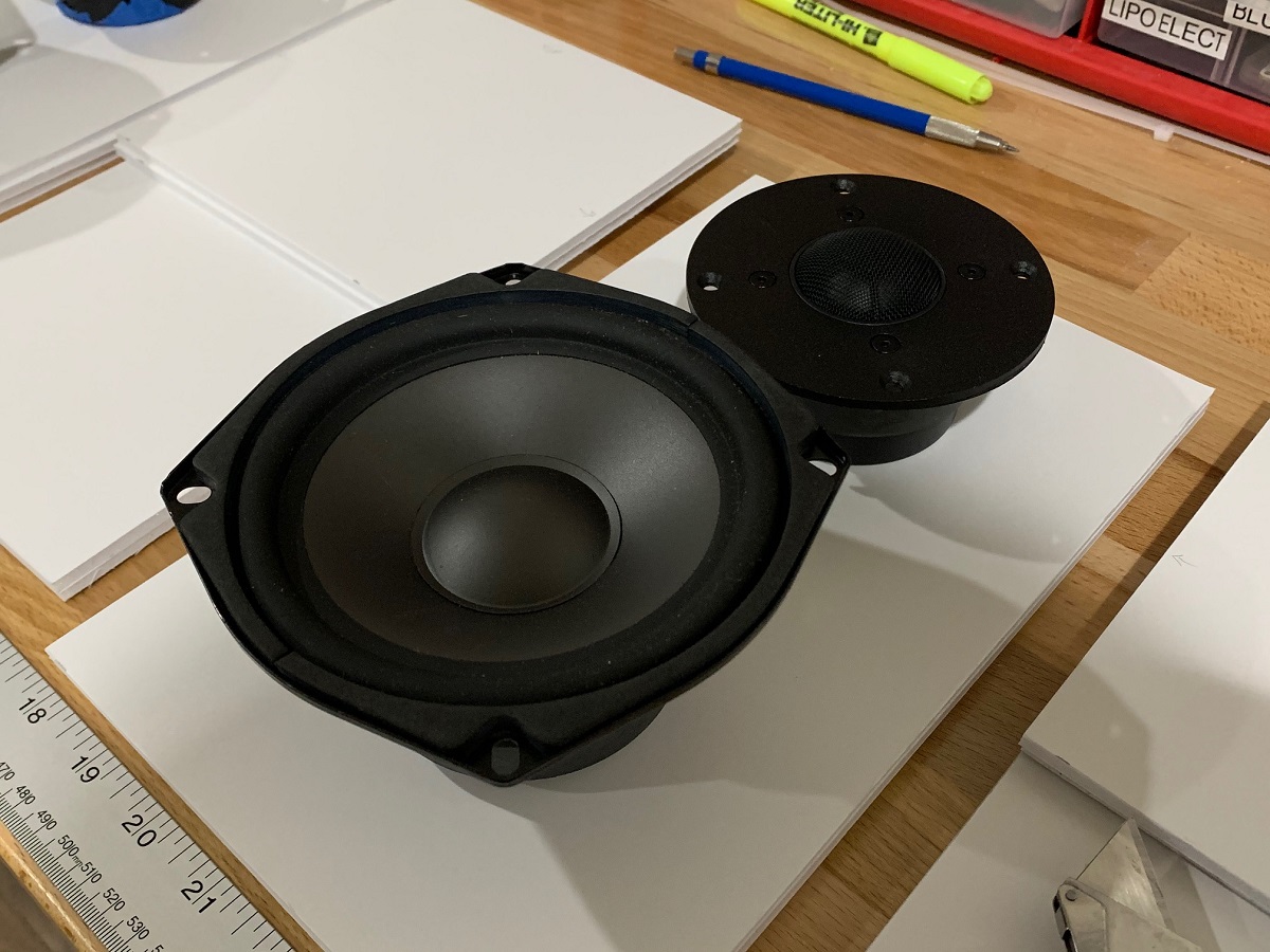

Foamcore homage to the LS3/5A. Well I like the idea of a small mini monitor, so I am making a foamcore 2-way in the standard 12in tall x 7.5in wide x 6.5in deep format using a 5.25 in polycone HP-5210 woofer and an RST28F silk dome tweeter. With some double layer CLD panels, some bracing, I think it might work out well. In any case, I'll have fun tweaking a crossover to replicate the response of an LS3/5A. The HP-5210 is a blowout sale woofer from P.E. that I got years ago. I just ran it through DATS and got ~57Hz fs, Qts of ~0.44 and Vas of 7~.7L and sensitivity of 87 to 88dB dB. I know, these are CHEAP woofers, how can they possibly compare to the B110's which sell for about $400 a pair... 🙂 The sealed box sim for 7.5L (that's bigger than 5L since my walls are only 3/16in thick except the front which is double) gives a F3 of 95Hz. I just finished cutting up the foamcore sheets and will glue up later tonight. The rear-mounted woofer poses an extra challenge of making the front baffle removable with drywall screws on ledgers. In case you are wondering if foamcore speakers can sound any good, check out the different projects here:
Foam Core Board Speaker Enclosures?
Advantages are quick and low cost materials and can cut on a kitchen table or work bench without power tools and no sawdust. Can be glued instantly with hot melt glue for making speakers in several hours or 1 night vs days or weeks.

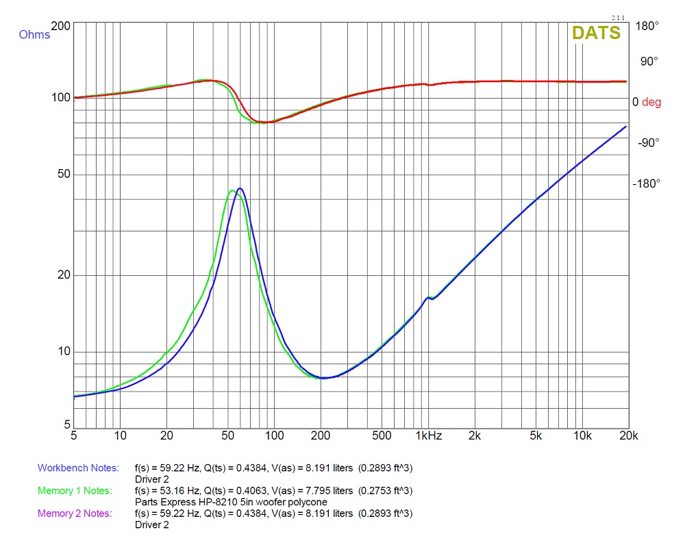

Here is the DATS T/S param measurement on the HP-5210's:

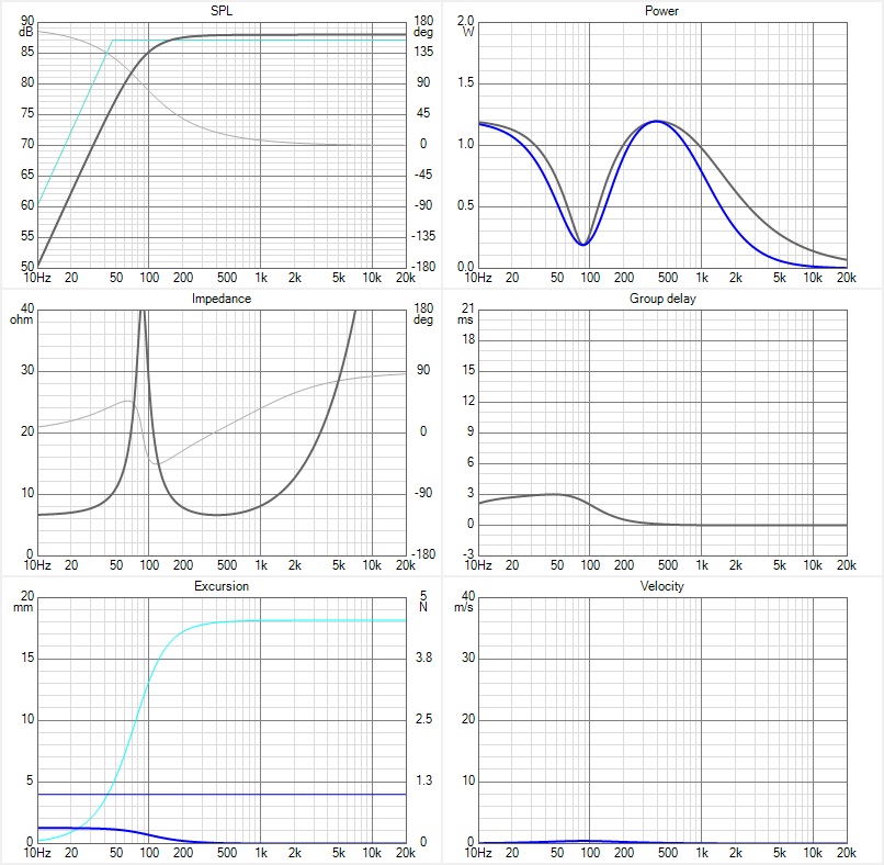

Box simulation for 7.5L sealed in VituixCAD (my first use of this very cool program):

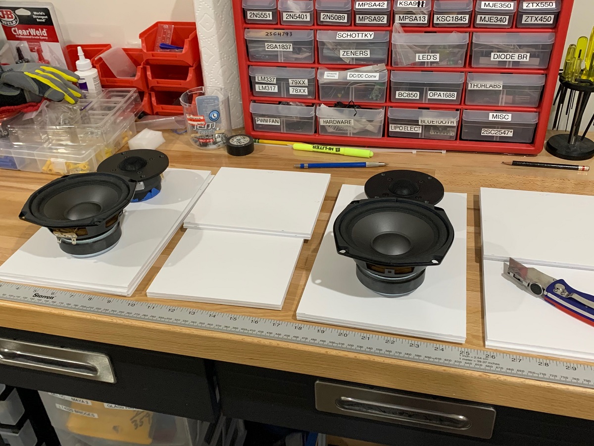

Foamcore sheets all cut and waiting to be assembled:

Similarities: rubber surround on woofer, polymer based cone, mesh/grille on tweeter, same general size:
