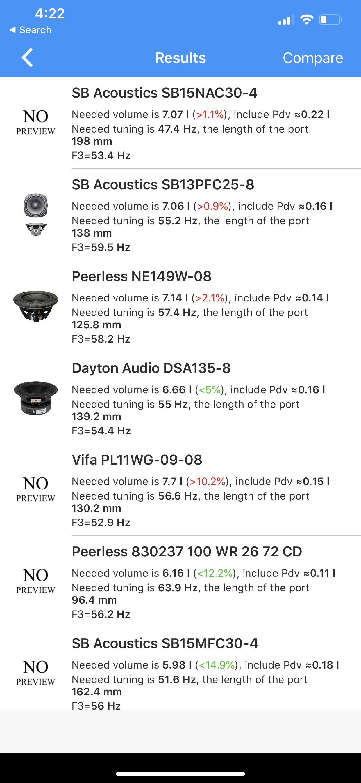

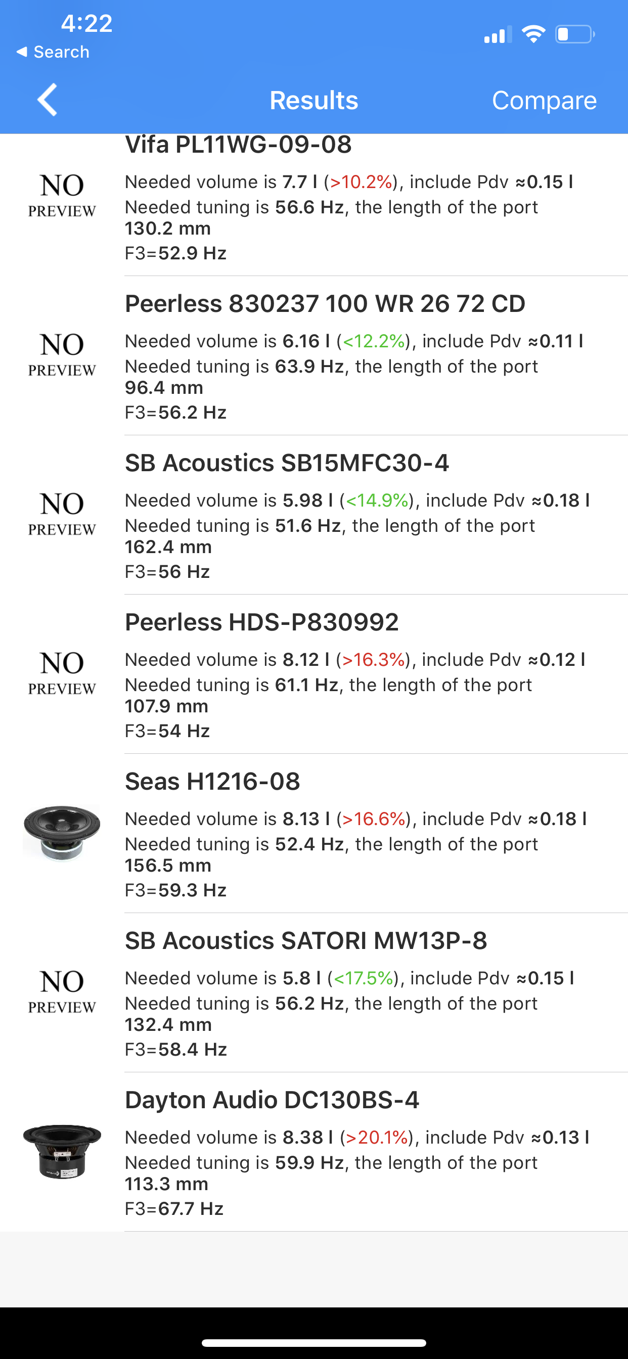

One option is to use a enclosure modeller that does reverse T/S parameter lookup.
ie. specify enclosure size, type eg. Sealed vs vented, frequency of box tuning (Eg, by FB Hz or port dimensions) ; manufacturers, and size
And let the software search up all drivers of a specific category
Eg.
7L
Vented
Port diameter 38mm; needing turning 55Hz
Brands: Scan-Speak, SEAS, Dayton Audio, Peerless, Vifa, Tymphany
Driver status: In production
Speaker Box suggestions:
