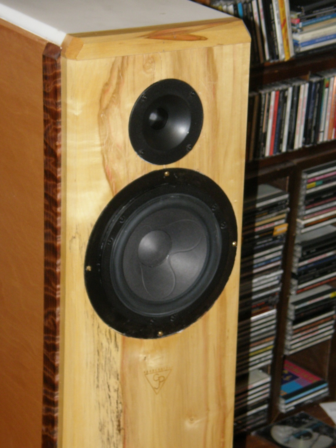

I hope that I am giving some info that you might be able to use. I built a set of back loaded horn cabinets (actually two different sizes, first set were smaller). So, I have tried a few different drivers out there, but since the Alpair 10P and 12P have both been mentioned, I will add that I used the 10P in first set of cabinets and the 12P in larger cabinets. Although I liked both in the mids and even the treble, I moved on to a Scan Speak 7" mid-woofer, meaning that I had to make the speaker system a two way. Bass is there in the 10 and 12P, but I missed the impact that I now have in the upper bass on down.
It has been a journey over a couple of years, and though I am happy with the end results, it took a lot of time to get what I really like.
Good luck in your journey and trust your ears.
