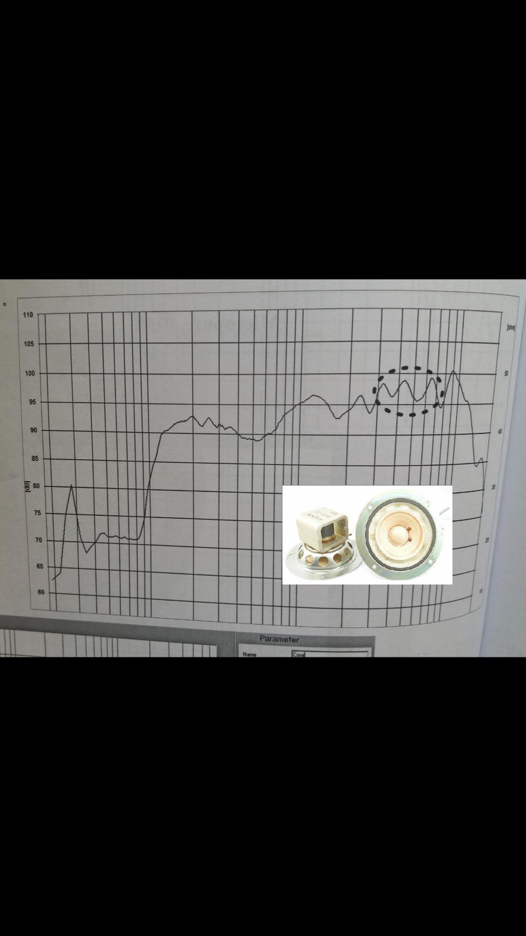

How about the Sony Holey basket with a 2.5" cone? 😀

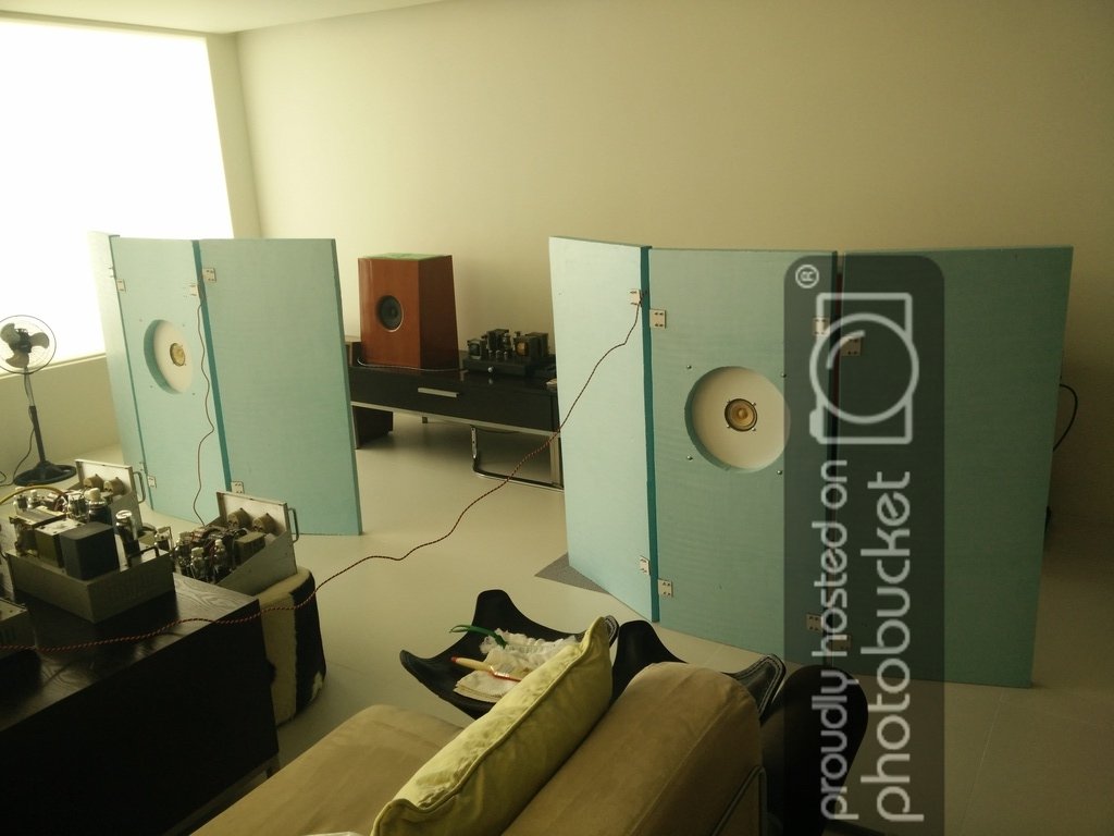

Please see posts #145, 146 below as how its fared with other modern and vintage full range drivers (including Altec 755A and 755C as seen in the background in the photo) in my view, tested on a big open baffle.

Attached is a set of the Sony measurements done by my friend. 😀

That sony would need eq for the rising esponse,no buenoHow about the Sony Holey basket with a 2.5" cone? 😀

Please read post #145 in the link I provided... 😀
Yes, it paper cone, keep in mind measurements were done on axis.
