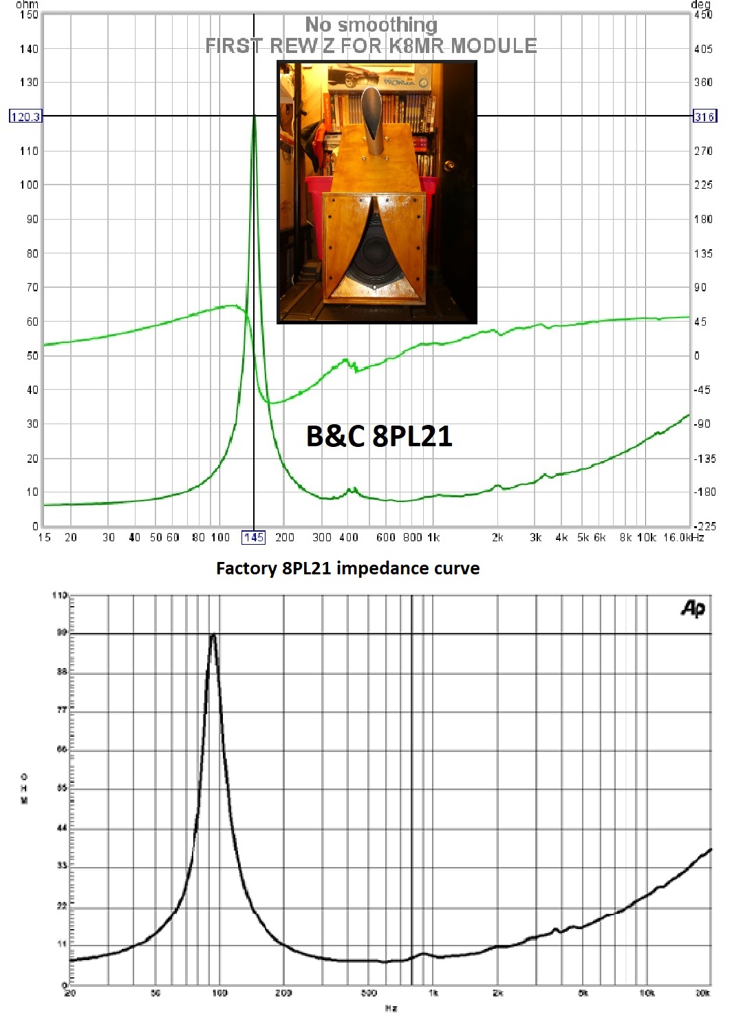

do you think any significant reduction of the Z peak in my little midrange can be accomplished with a few damped holes?
hi planet10 - what do you figure would be a good start for hole diameter - number and resistive material ? The rear chamber looks roughly 6 liters and lined with one layer of melamine "bricks". Maybe a brick would make a good hole damper.
(I probably should try to reduce that rear chamber w. rigid foam but kinda had to be like so to accommodate the leaning driver.)

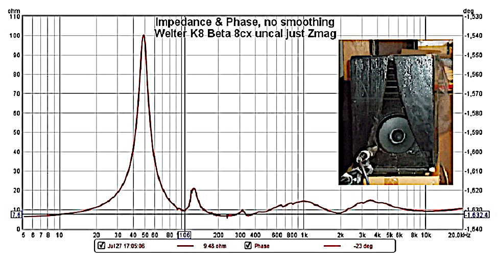

Here's small signal input impedance of a Beta 8cx speaker in a Karlson type, tuned with 5 - 6" by 0.375" slots. Its got a healthy first Z peak 😀

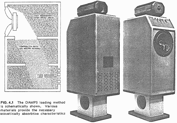

This is an image of the most advanced aperiodic box i have seen, i use the holes on the back as a reference.
91089d1187371189-legendary-speakers-perkinspr-2-sm-gif
I have used it successfully a couple times, this 4.5 litre FR125 box used similar. I did not get a picture of the holes, not in the plans (basic sketches).
946224d1619416249-dealing-drivers-wave-energy-fr125-aperiodic-jpg
Hole size is somehwta dependent on how big the boc is. ⅜”, ½” on a grid similar to the PEARL, then damping pushed up against the holes on the inside. I use open cel foam. Thicker provides greate rdamping.

that's great info Dave - many thanks. I'm guessing the 1/2" thick plywood box rear chamber to be around 400 -450 cubic inches before driver displacement.
how many 3/8" holes , what spacing the between holes and what position on the cabinet's back might be favorable for starters?

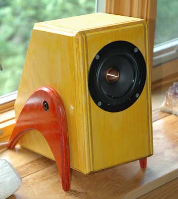

the cabinet is basically like the sketch below.

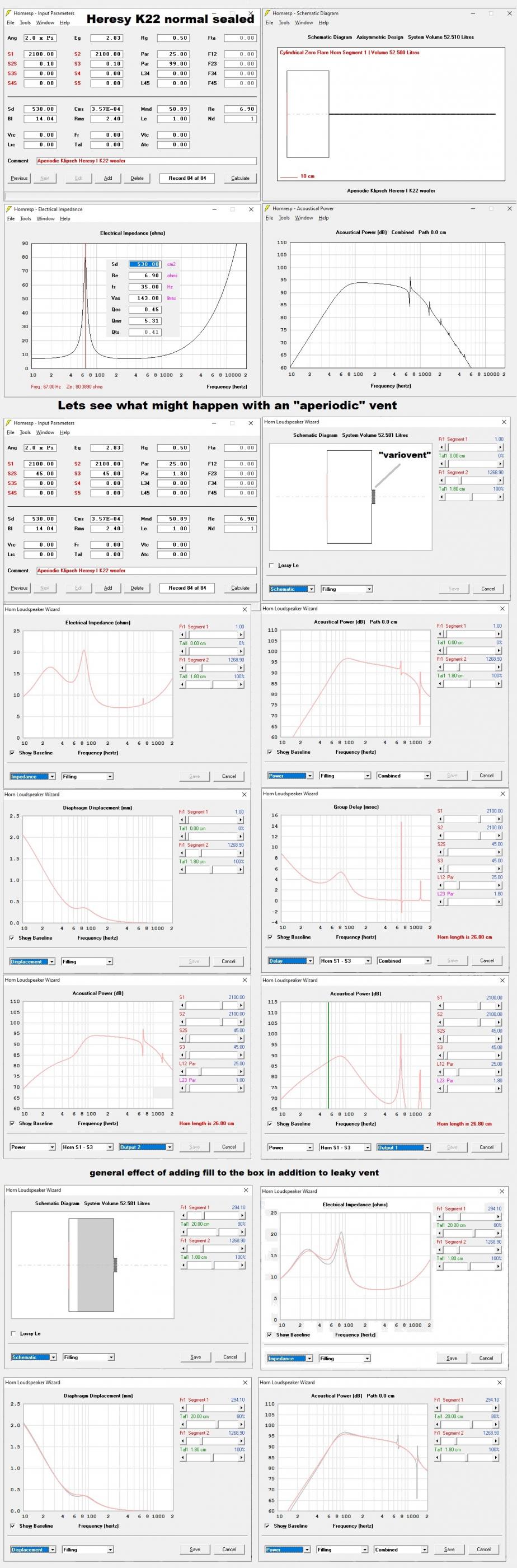

Is "this" a fair sim of a Klipsch Heresy I/K22 w. "variovent" and if so ?
will the response be elevated in the region of the center of the flattened impedance peak due to more current* being pulled ? (* ~constant voltage driving source)
I doubt if the damped vent would radiate much (??)
If the impedance graph with aperiodic vent were plotted on the same scale as the sealed case, it would be obvious by how much the single resonance peak is reduced in amplitude.
It would look like Dave's graph in post #31, and the dip in the centre that concerns you would not be so obvious.
You are correct that there would be little audible output from the resistive vent.
Usually when we are working with an aperidoic bass enclosure we are starting with a response near resonance that has a higher Q than we would like. If you are wholly successful with the aperidoic damping, then the response will be flattened, if not you will still have a bit of rise before roll-off.
The aperiodic vent dhould have little or no real output.
dave
I'll have to ask David McBean for how to set hornresp for these situations. Normally a Klipsch Heresy I with K22 isn't underdamped and the mod as I inputted is creating an underdamped output.
