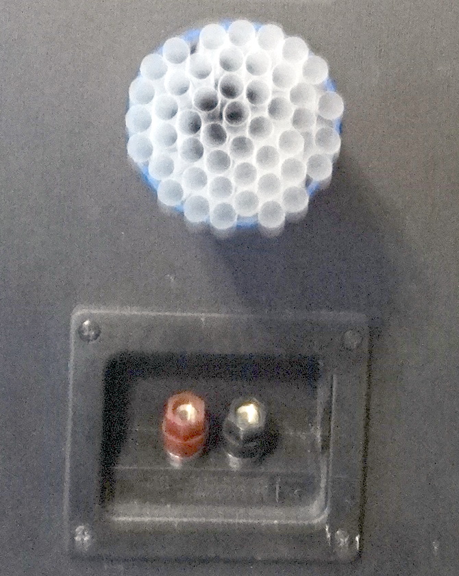

Depending on how hard people want to get after modeling that, instead of needing to do resistivity measurements or just fly by impedance alone, it might (?) be possible to "back into" useful filling resistivity values by just measuring spl & phase because you can export that from the filter wizard and have filling included. FWIW. HR port models are cylindrical and the high aspect ratio stuff like slits needs different modeling so my hunch is that slits are a no-go for modeling, but that's what I'd try before going full-airflow-measurement in case it's close enough. Might work well enough for less severe AR (?).
Ive been using several layers of grille cloth sandwiched with aluminum screening to create a "flow resistor" to put in place of the opening in my A26 Seas Dynaco clones. It seems to sound better than the fiberglass damping material and creates less audible air flow noise at higher cone excursions. As with anything, there is an efficiency tradeoff and you can hear it in earlier low end rollof, but the bass that is there sounds alot more resolving and tighter.

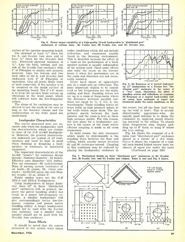

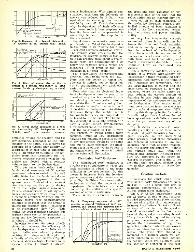

I'd like to experiment with a larger enclosure using a large higher Qts driver. I'm a little concerned with air flow noise using the DP enclosure tuning method. This looks alot like a very lossy port to me and likely could be calculated this way by overlaying the actual results with a specific loss factor for practical correction.
