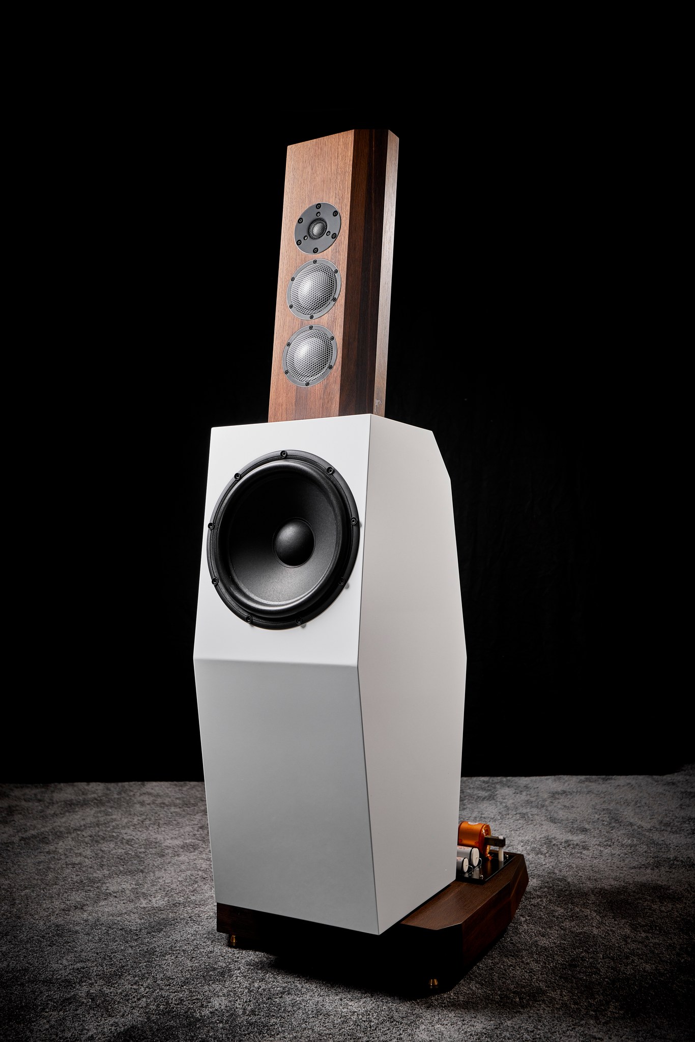

That’s the way to do it……imaging at its finest! If only more folks would get on board with the narrow baffle…….interesting case here is actually no baffle requiredIn the light of discussion what is possible with 3 inch midranges...Joachim Gerhard made new speaker with two beryllium Bliesmas. Interesting that he chose ScanSpeak 6640 tweeter instead of Bliesma brothers...and only one bass unit...

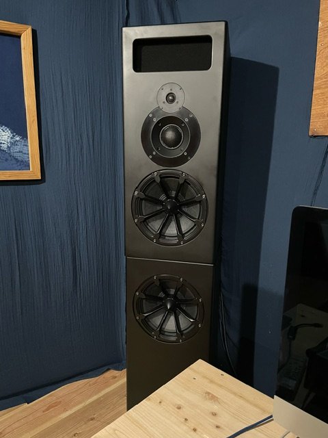

Im building as we speak a 100l ported cab
dual 12br70
dual hivi dm 7500
hivi rt2c
wmtmw
first order xo 500/5000
dual 12br70
dual hivi dm 7500
hivi rt2c
wmtmw

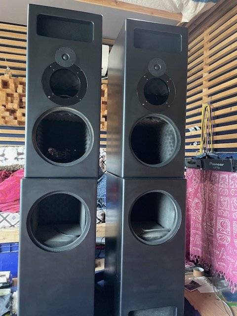

Hello everyone, this is slightly moving away off topic so apologies, I have a PMC MB2S XBD project I've been working on for the last few years. I managed to build the cabs and I'm in the process of designing the crossover filters using the Hypex FA 503 amps. However I cannot seem to find the frequency crossover of the original MB2S XBD , I have all the driver specs but i am trying to get as close as posable to the PMC speakers crossover set up .Dose anyone know where I can pull this info from ? thanks again , all the best ,,
I dont sorry, but I wouldn't worry much about it. Just buy some cheap second hand 4 ways active xovers and play around with the frequencies. I would start at 300 not knowing the drivers. Sell xovers when done or keep them for future projects. Btw. Actually dbx and other crossovers are cheaper on AliExpress than second hand.

So? Up to 1/4 wavelength distance is impossible without coaxial arrangement, so all else is a compromise and the 3.8kHz may not as bad as it looks at first sight. For example ATC uses 3.5kHz with success since decades.Wow!…..those two domes are quite a distance apart for a 3.8k cross.
Yes indeed. At crossover frequencies above 3k, it is relatively easy to achieve a CtC distance of 1.2x wavelength. A ratio between 1.1 and 1.4 helps with the power response, and 1.2 seems about optimum.
If a 125 mm frame mid and a 105 mm frame tweeter are mounted so close they are touching, the 1.2xwavelength crossover frequency is 3.6k. If they are spaced out with a 20 mm gap between them, the 1.2xWL frequency is 3k.
not really.So? Up to 1/4 wavelength distance is impossible without coaxial arrangement, so all else is a compromise and the 3.8kHz may not as bad as it looks at first sight. For example ATC uses 3.5kHz with success since decades.
for example: https://www.morelhifi.com/en/products/raw-drivers/classic-advanced-37/tweemid-tm-4055-8-452
Okay, it's possible
Okay, it's possible, but requires a special midrange and tweeter. Although that Morel have only a 2" mid dome, it requires 1400Hz or lower crossover to get the 1/4 wavelength frequency of the ctc distance. Not every 1' dome are happy with a crossover frequency that low.
so i am looking for the original crossover frequency's for the PMC MB2s Xbd monitors .. As you can see my project is almost complete and i am programming the amp filters and it would be cool to find out the original crossover points .. all the best everyone ..
I wouldn't even bother. Based on the data I've seen on many PMC speakers, their filtering choices are often very poor to the point that I'd consider the results to show incompetence in driver integration.
Much, much better off measuring and develop your own filters, pretty easy if you're active, end result is likely better than anything PMC could come up around the time the speakers were made, and depending on what they're putting out today, might even be better than that.

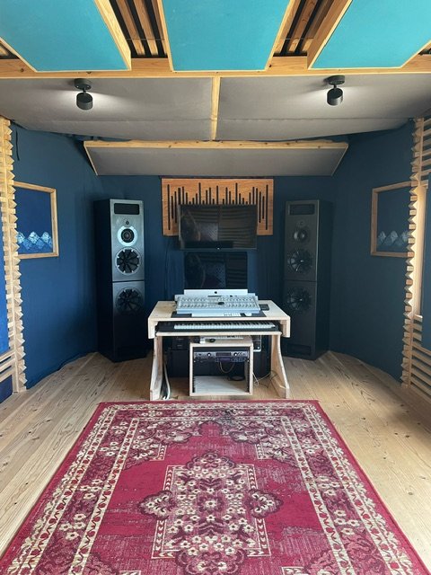

That's a really cool project, cabs look great.
Looks like a serious monitoring effort 😊.
Are they intended for listening while standing/walking around? My newbie eyes sees it as bottoms should be laid on their sides to get ear-height down to seated listening? -Well I've recently been introduced to the idea that placing above ear-height has benefits. I wonder if that takes tilting tops forward as opposed to the old fashioned backwards tilting speaker feets for low floorstanders. Did you verify 380 and 3,8k as original xo?

- What's possible with a modern 3" Midrange ... 3way Prototype
