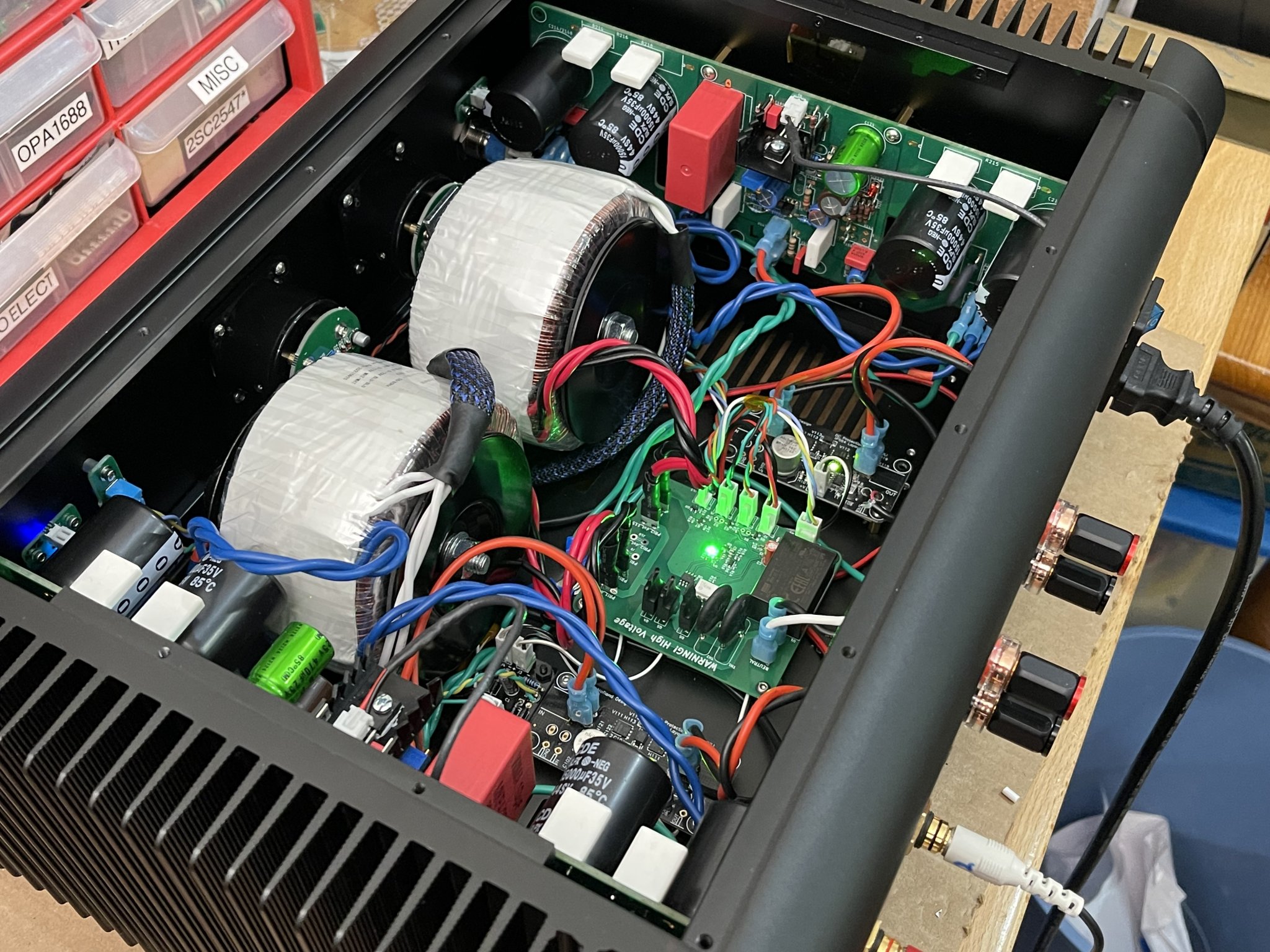

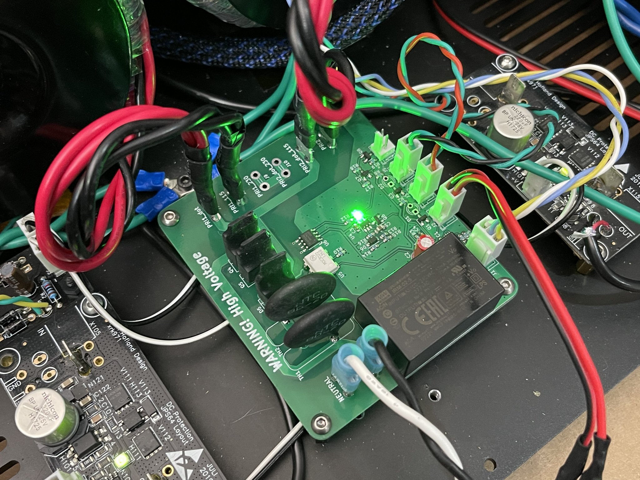

On the bench was a rebuild of a new soft start with remote on/off and thermal shutdown. I got new solder paste. The last one used old solder paste and I think I had a bad joint somewhere and logic was not working. It’s working fine now. Installed in amp and cleaned up wiring. Letting amp burn in.

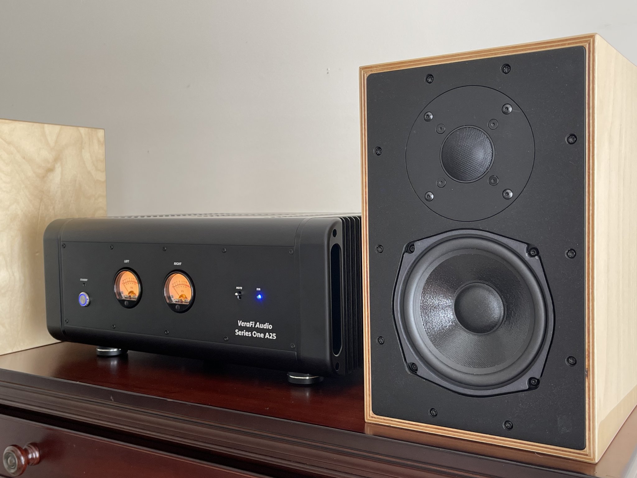

I brought the A40 upstairs to test it out in bedroom with a set of gloss blonde birch Vangiards.
They sound really great together. A perfect combo.

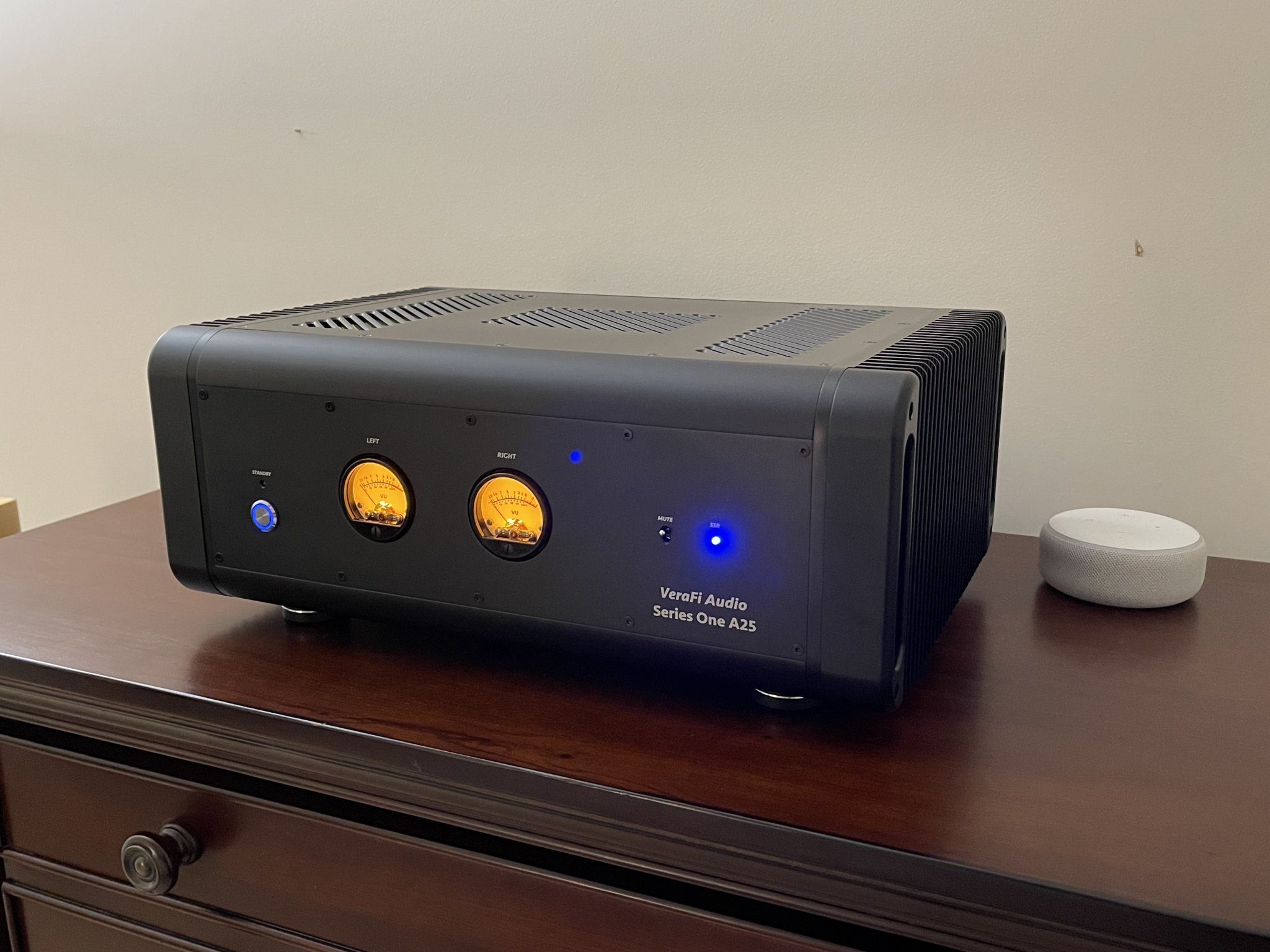

Nice X!
Any chance you’ll sell the VU meter + pcb circuitry to support it on your Etsy?
Best,
Anand.
Best,
Anand.
Hi Anand,
Glad you like the VU meters. There is no extra circuitry with these - they are purely passive (self powered by the signal connection) and a separate circuit for the LED. PM coming your way.
On the dresser tonight is the A40 amp and Vanguard speakers. Bringing it upstairs gives me a good chance to test sound quality and functionality, user interface etc. This combo is sounding very nice.
