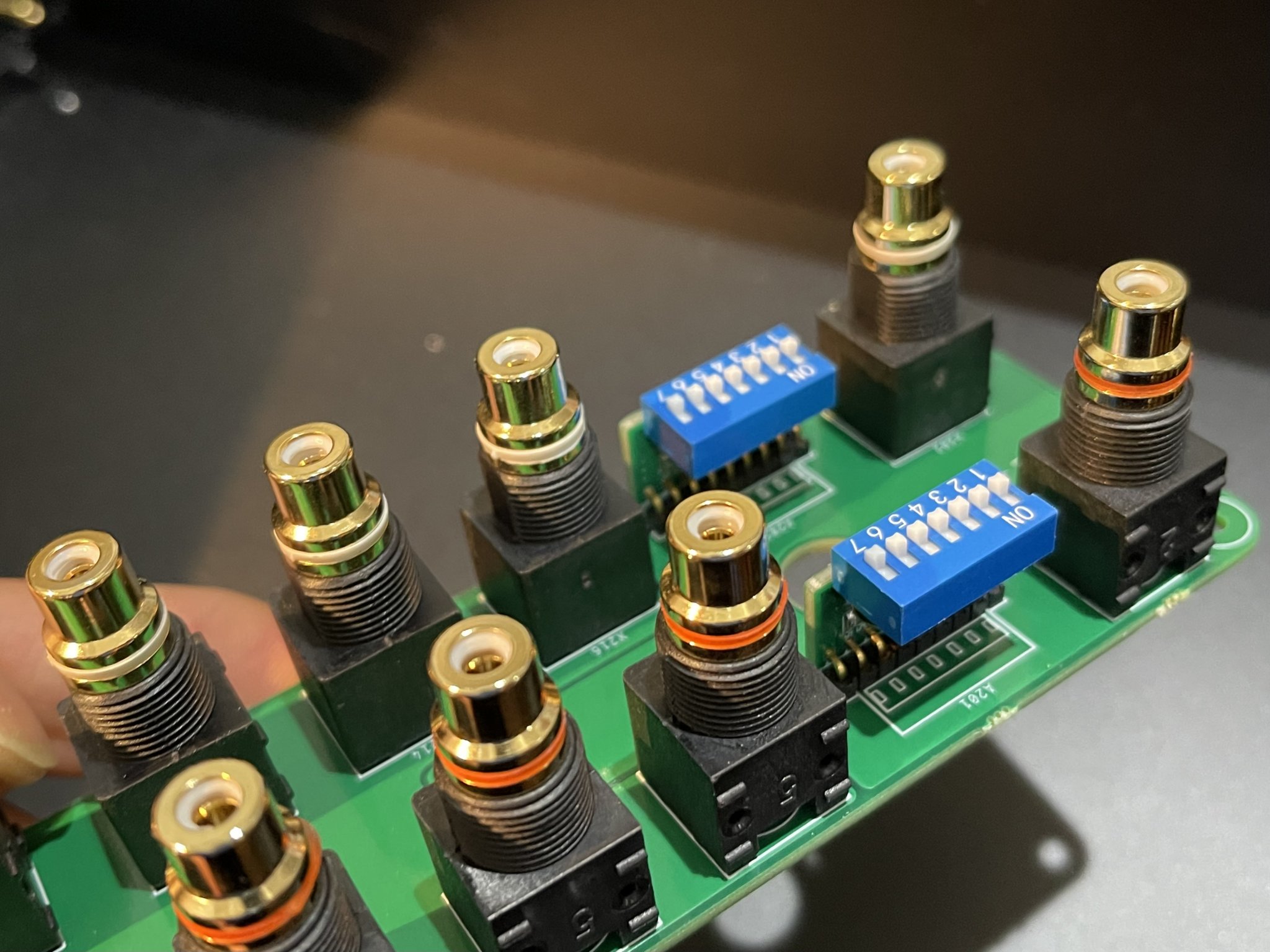

OTB tonight are some RIAA loading selectors for MM/MC configurations on the Bob Carver preamp V12. 0.5% Susumu 0603 resistors and nice NP0 caps to select gain and input capacitance and impedance.
Mounts like this:
Fits on rear panel like a glove:

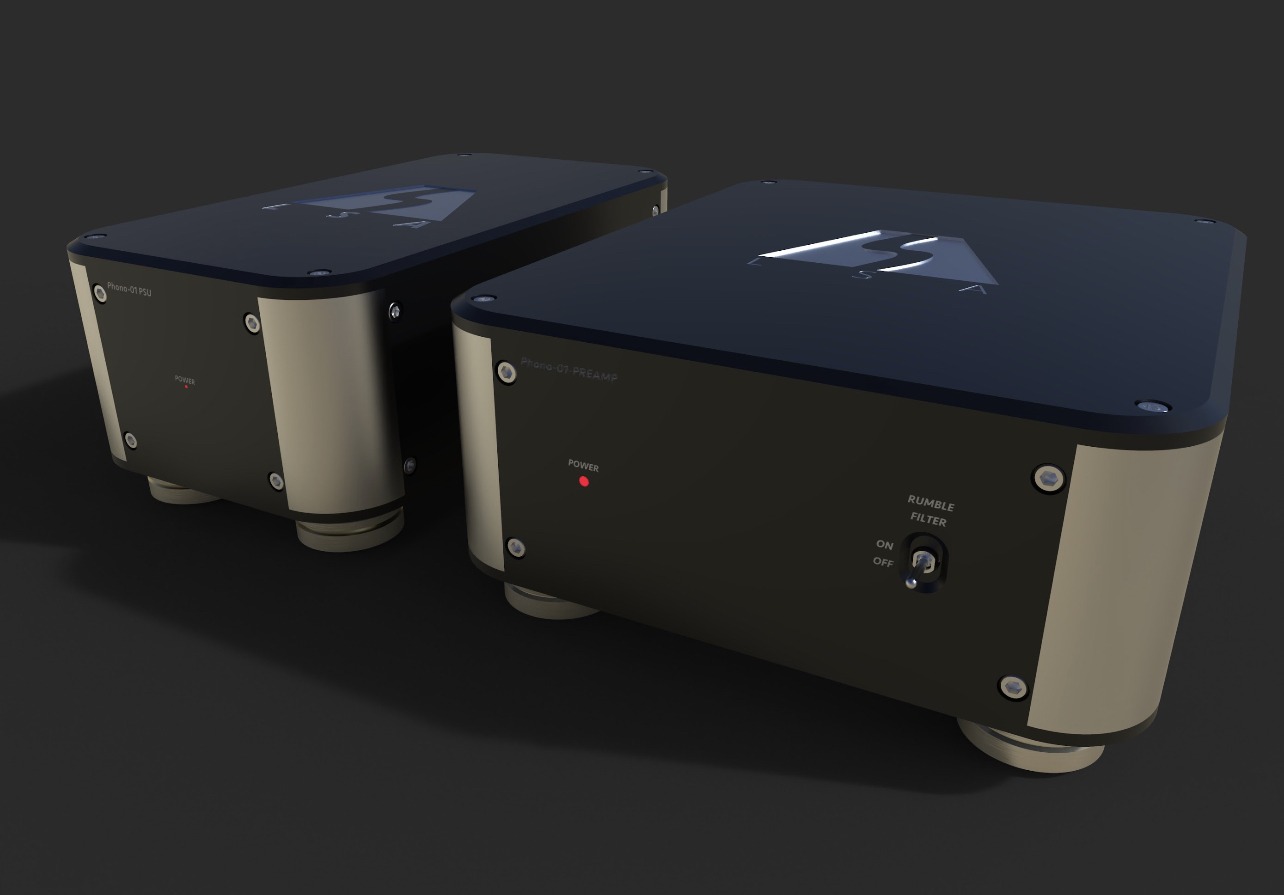

Interestingly, I’m starting to work on driving the LSA Phono-01 MM/MC preamp into production. It has a similar DIP switch for setting input impedance, capacitance and gain.

Those are similar to Elecaudio but I get mine from an OEM in bulk for production. I have a few left in my shop.Where are those rca jacks from?

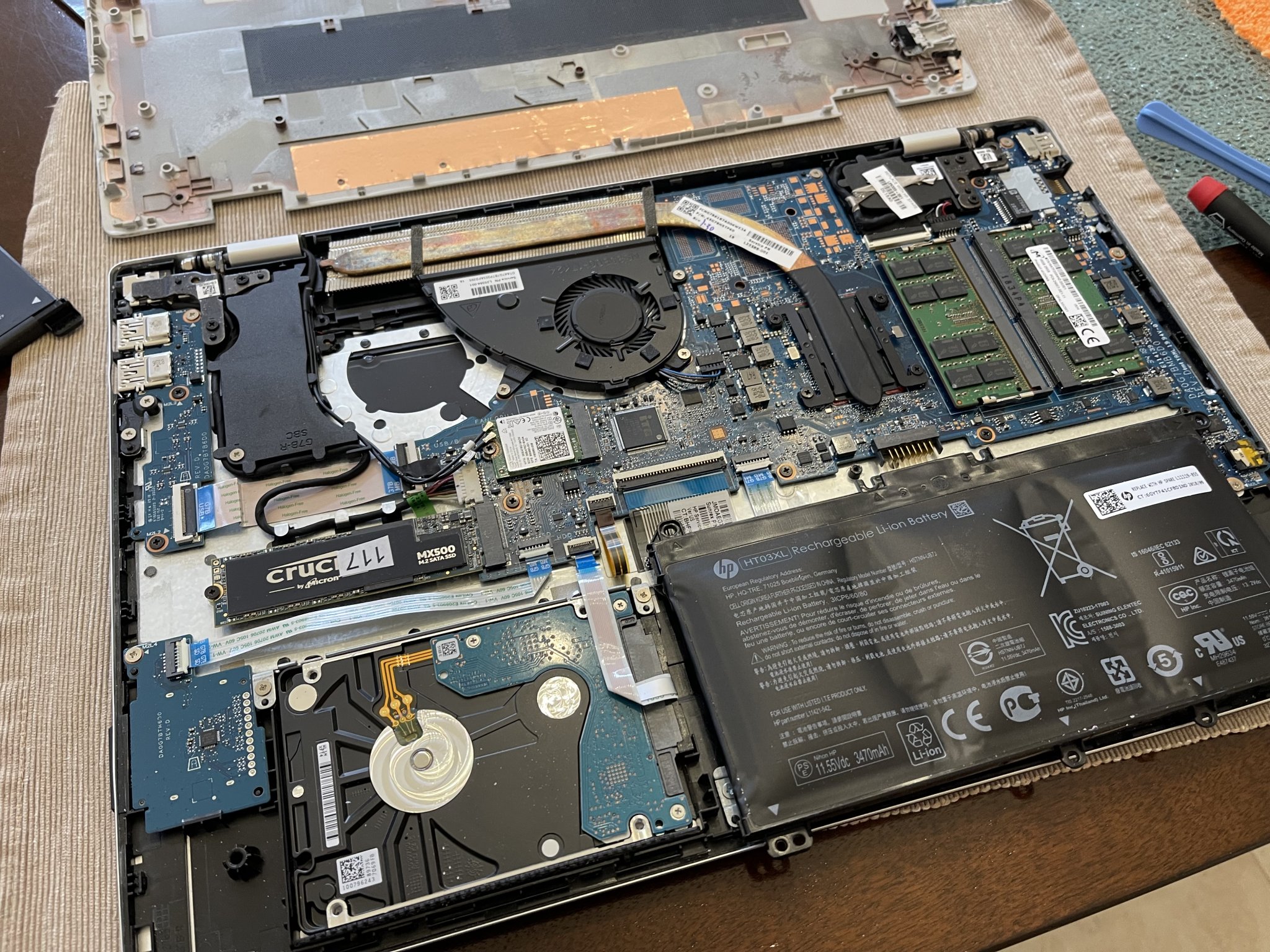

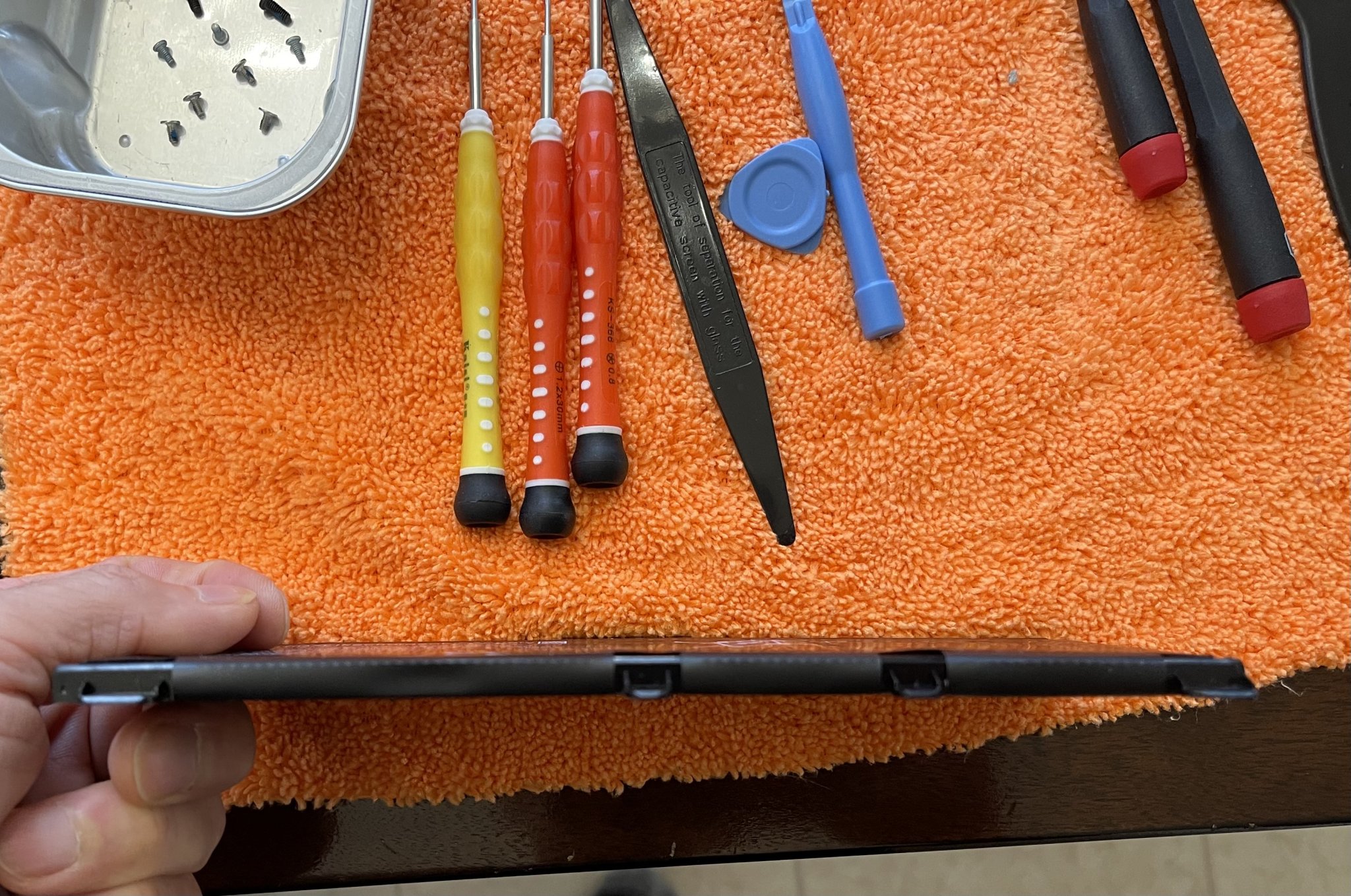

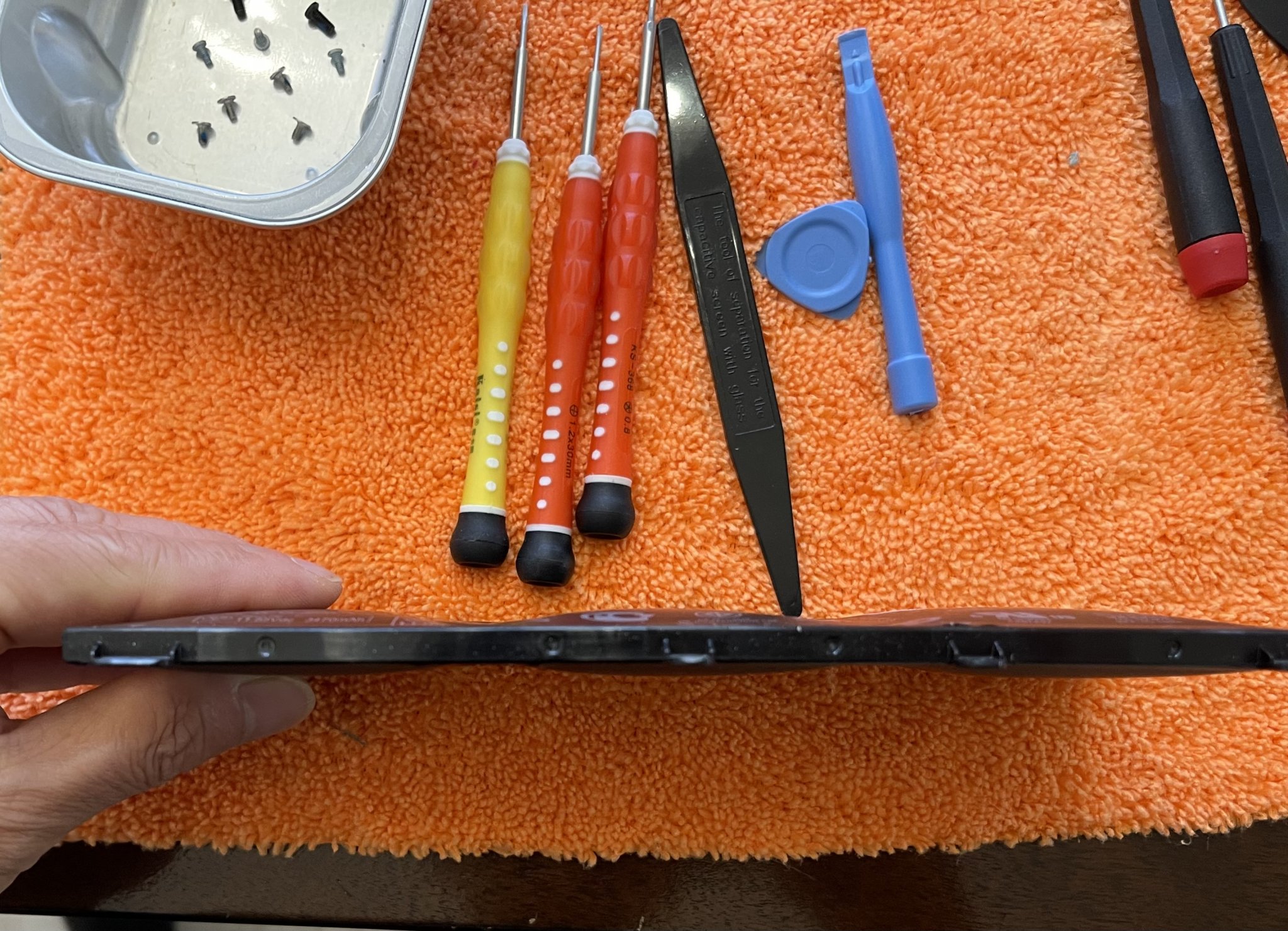

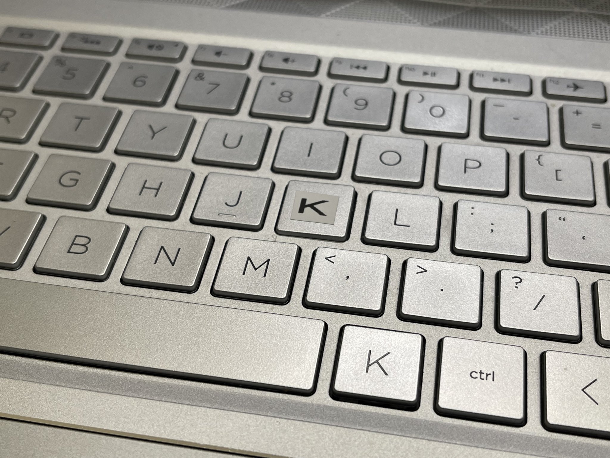

On the bench tonight is some computer repair. My laptop battery was bulging and pressed against the trackpad making inoperable. The K button key was broken. So it was a simple matter to open the case once you know where the screws are. You can see the old puffy balloon-like battery vs the new slim flat one. The bad K key button was swapped with a redundant ALT key. A label maker came in handy. My 2 year old HP laptop with Core i7 and 32GB RAM and 1TB SSD has been given a new lease on life.
I got all these tools out but turns out all you need is a small Philips and a guitar pick pry tool.
The insides are amazing feat of packaging:
Old battery:
New battery:
Keyboard fix:

That motherboard looks almost like my i5 8th gen dell 7000 Inspiron 2in1’s did intel give these guys some reference design ? Will share my motherboards pic a little later.

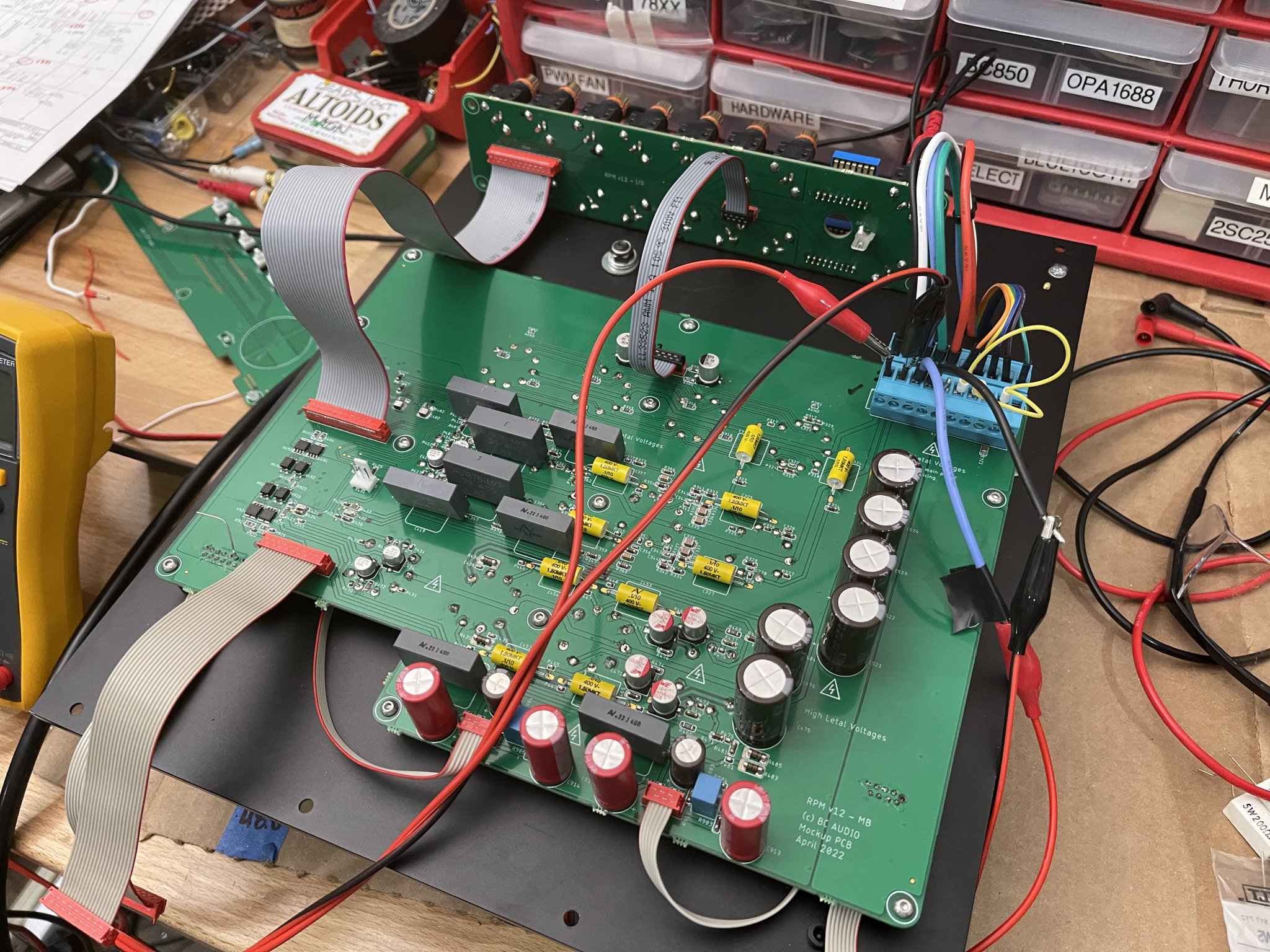

On the bench tonight is the RPM V12 preamp testing with the main board and 12AX7 tubes. Slow and methodical. Will report back later.

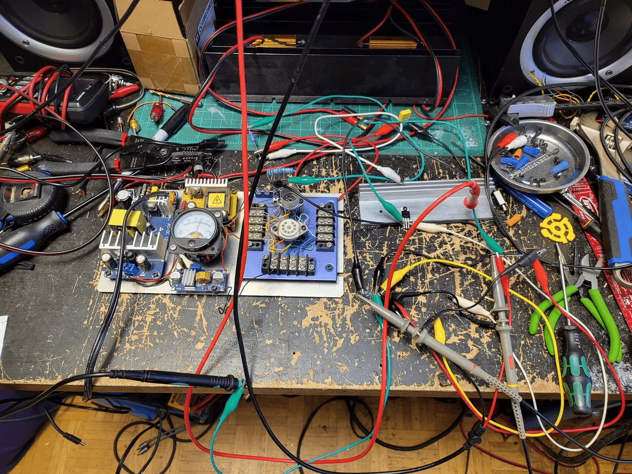

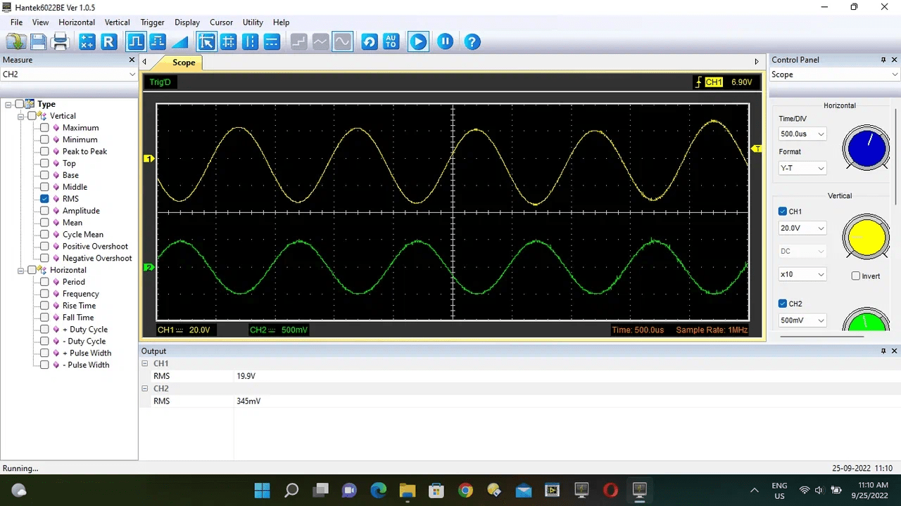

I've started to play with depletion MOSFET. IXTP08N100D2. 280V B+ with a 33k load resistor and 600R source resistor, I get µ=60. The scope wobbles a bit because the thing is so Jerry-rigged.
CH2 is input from DDS, CH1 is output from drain.

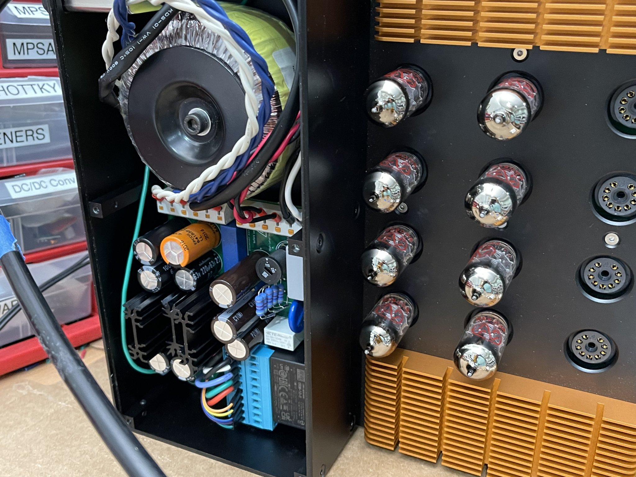

Nice work. I like to use the Meanwell AC/DC modules that make 5v for the soft start logic and to power MCU.Working on simple soft start with dual auxiliary supply which also powers my micro and a relay.
Need to get better relays - marking erased with IPA 😬, will test further with TOROID , dry run worked.
Love your bench!I've started to play with depletion MOSFET. IXTP08N100D2. 280V B+ with a 33k load resistor and 600R source resistor, I get µ=60. The scope wobbles a bit because the thing is so Jerry-rigged.
