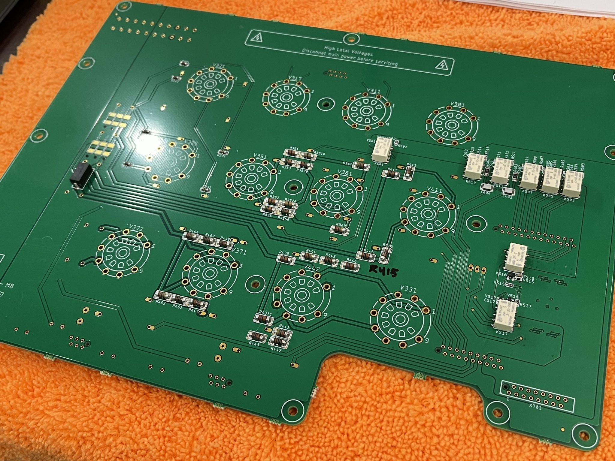

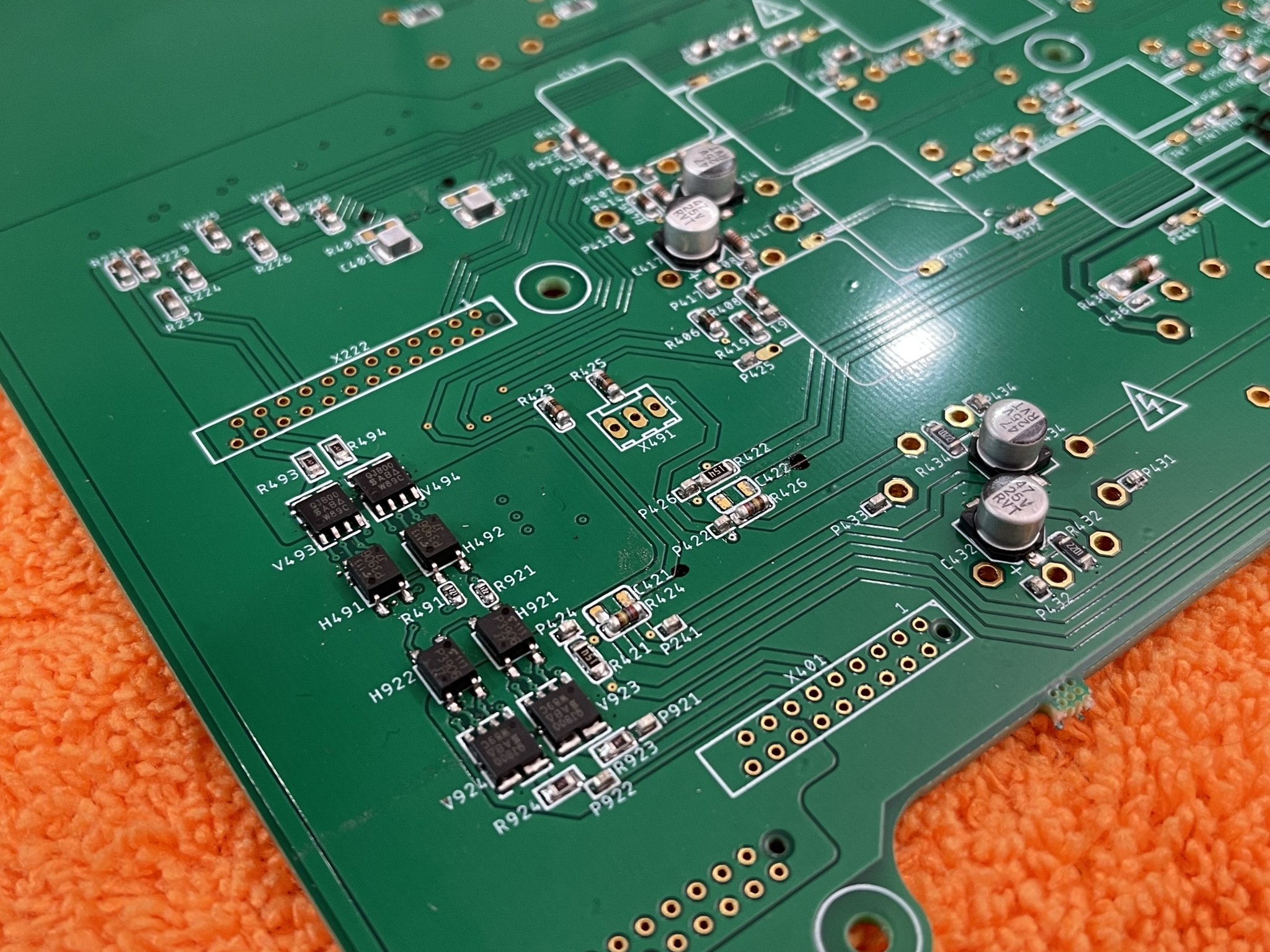

On the bench is the Bob Carver RPM V12 preamp main PCB. Populating the SMT parts (and there are about 300 of them) was kind of epic.
This is a detail of the solid state anti-thump relays:

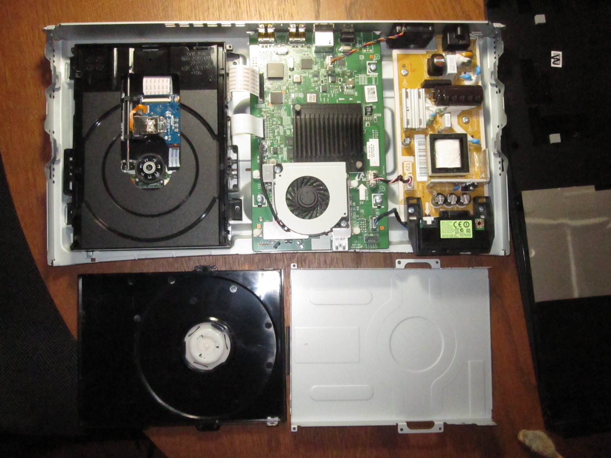

On the bench is our now malfunctioning 4K Blu-Ray player, the Samsung K8500.
Issues:
Well, it can still stream Netflix and Youtube at 4K...
I have zero idea of what is wrong. The tray isn't physically restricted since I opened the drive itself, and after it doesn't recognise the disc it will eject it automatically. Pressing the eject button does nothing though.
This first started with no manual eject. The 'disc not recognised' thing is a new one.

Belt is probably loose and the limit switch needs to be checked if it’s giving a proper close signal. If it’s there, use a audio cd firstOn the bench is our now malfunctioning 4K Blu-Ray player, the Samsung K8500.

There's definitely a lifetime thing going on with laser diodes. Sometimes with skipping/not reading players, you can attempt increasing current to them a little (not so much that they burn up rapidly) and that sorts things out.

Then again, it's been five years, so it could be the laser diode thing, or something else. I still don't get why the manual eject doesn't seem to do anything. Maybe a check of the power lines is in order.

This is the Samsung 4K Blu-ray player, the first to ever be released commercially in the world. A really small and simple affair in three parts: 4K Drive, CPU/Decoder/Processor board with connectors and SMPS to power everything.
Below that you see the top plastic cover for the drive. Putting this back solved the disc not recognised issue, so that was introduced by me on removal. On its right you see the metal cover. At the bottom there is another metal cover.
Unlike other models where there's an easily accessible slot from beneath the chassis to move the gear for opening the tray, this one needs a small screwdriver to be inserted from the right side. Of course, since there's the processor board with the fan right where you'd do that, it is impossible in the normal configuration.
I removed all screws for the drive, so that now I can manually open the tray every time I want to change disc.
It works.
Problems solved? Hardly, because the soft eject button still doesn't work and I still don't know why.
Workaround found? Hell yeah!

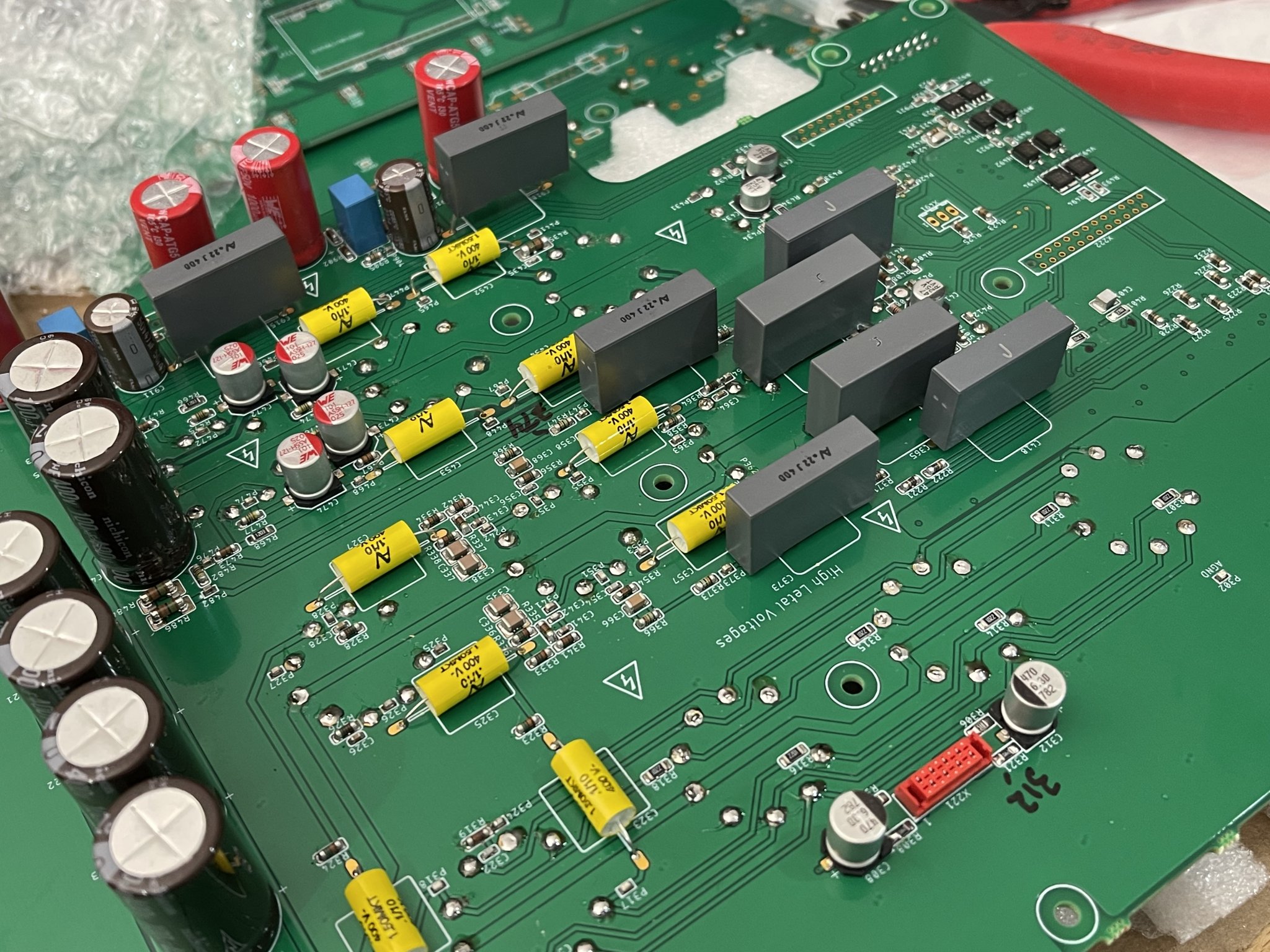

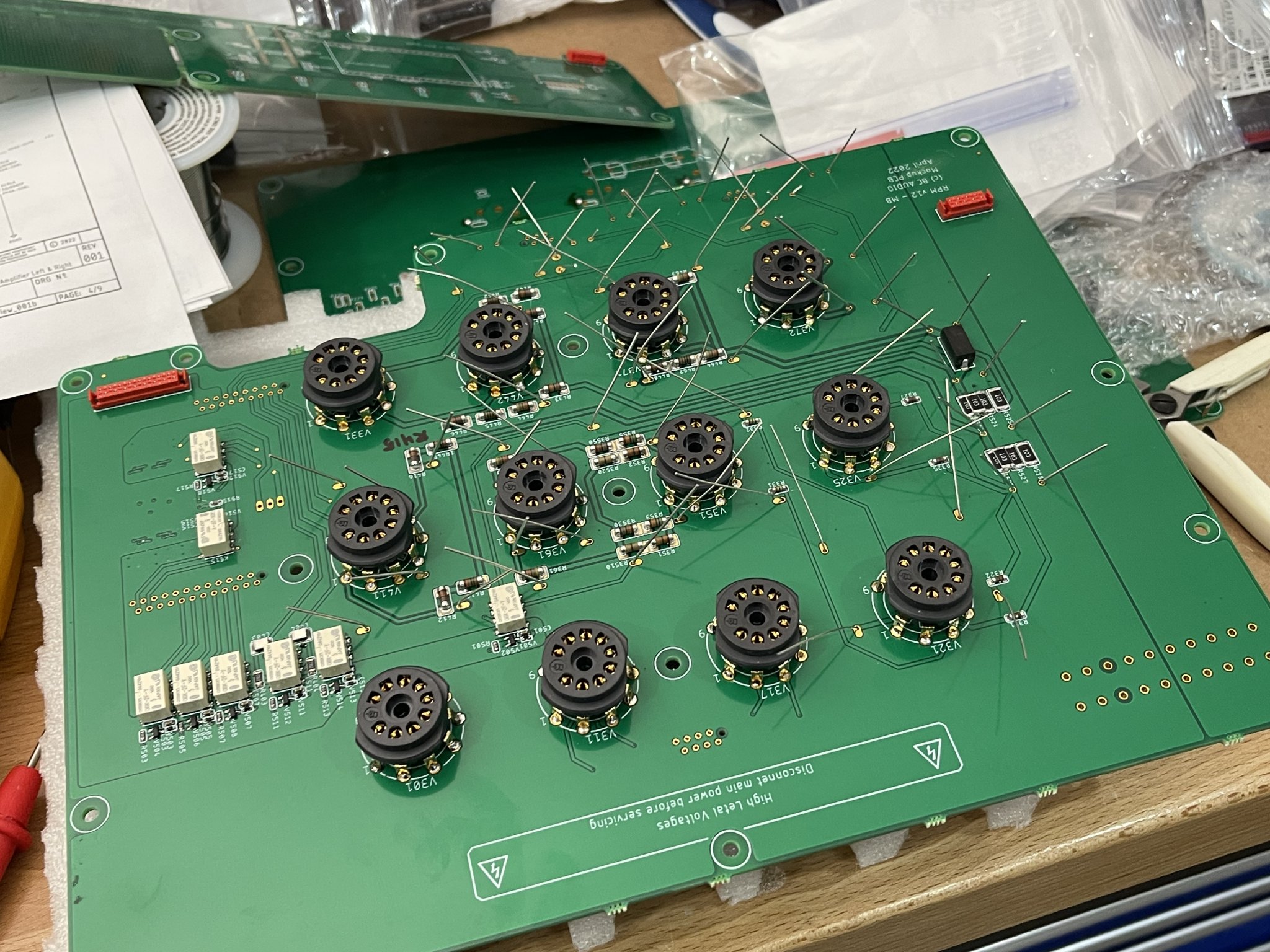

On the bench tonight is the Bob Carver RPM V12 preamp main board. I’m installing all the through hole components. We are using basic MKP box caps and Kemet film caps for the prototype. The production one will most likely use Mundorf M-caps (board is laid out for them as you can see the outlines).
Film caps and electrolytic caps all in:
Getting ready to solder and clip the leads:
Closeup of tube sockets:
