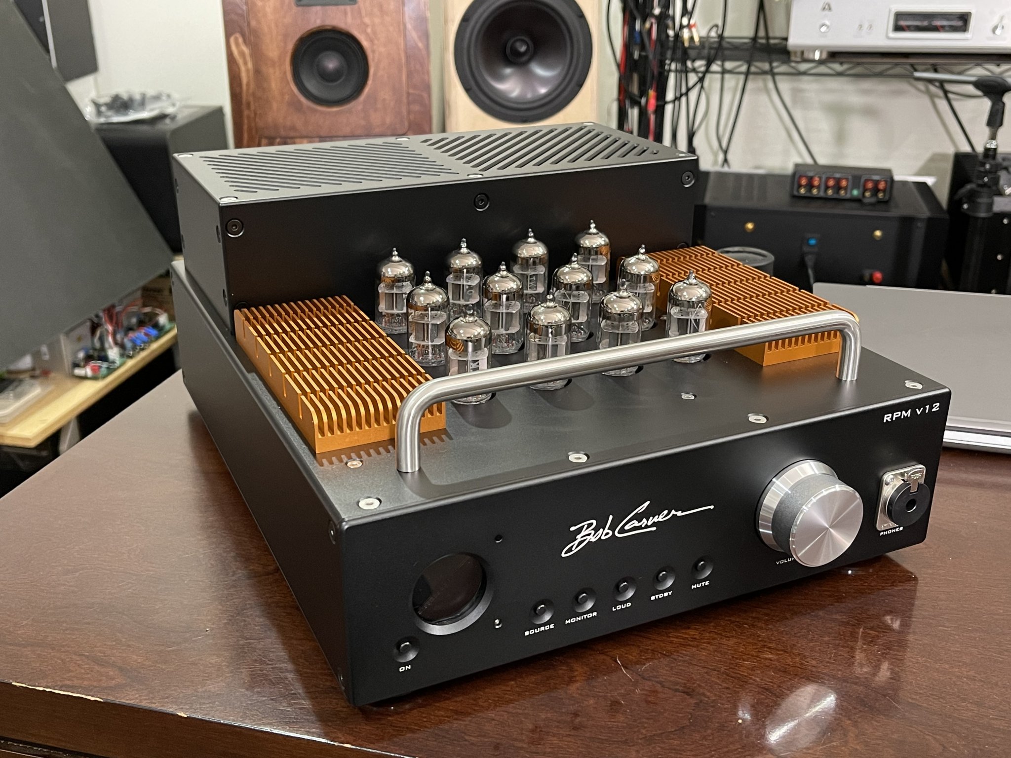

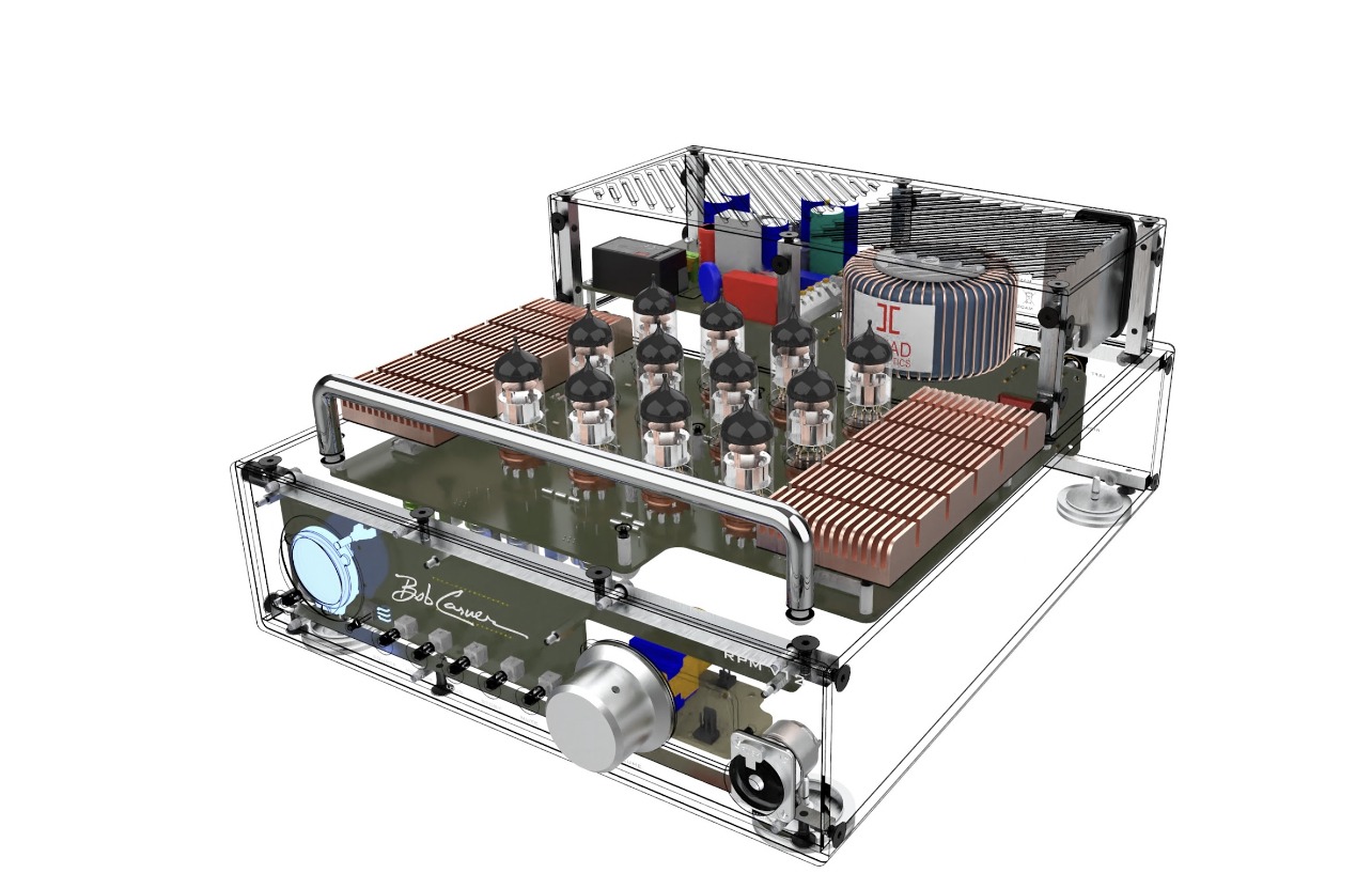

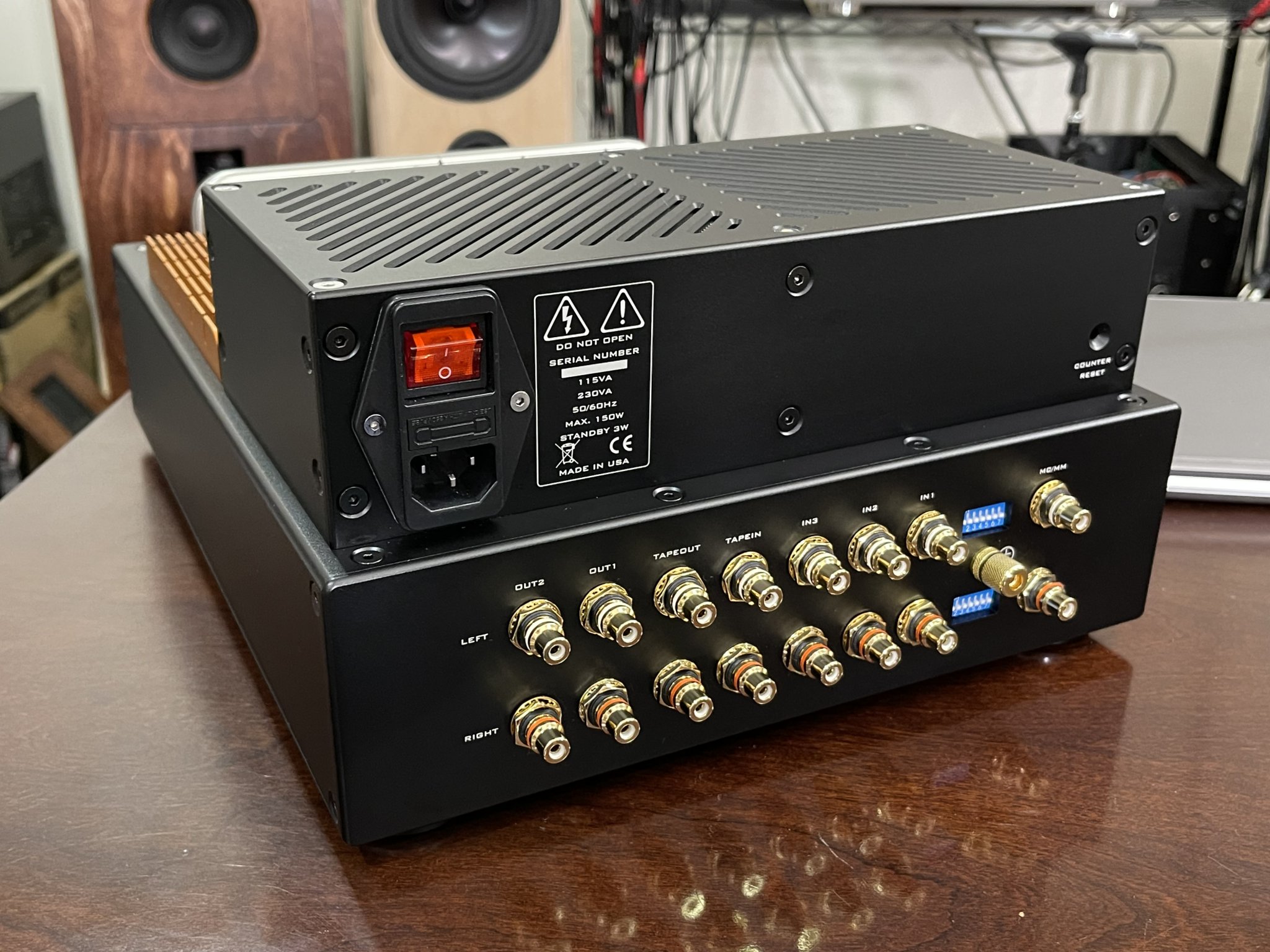

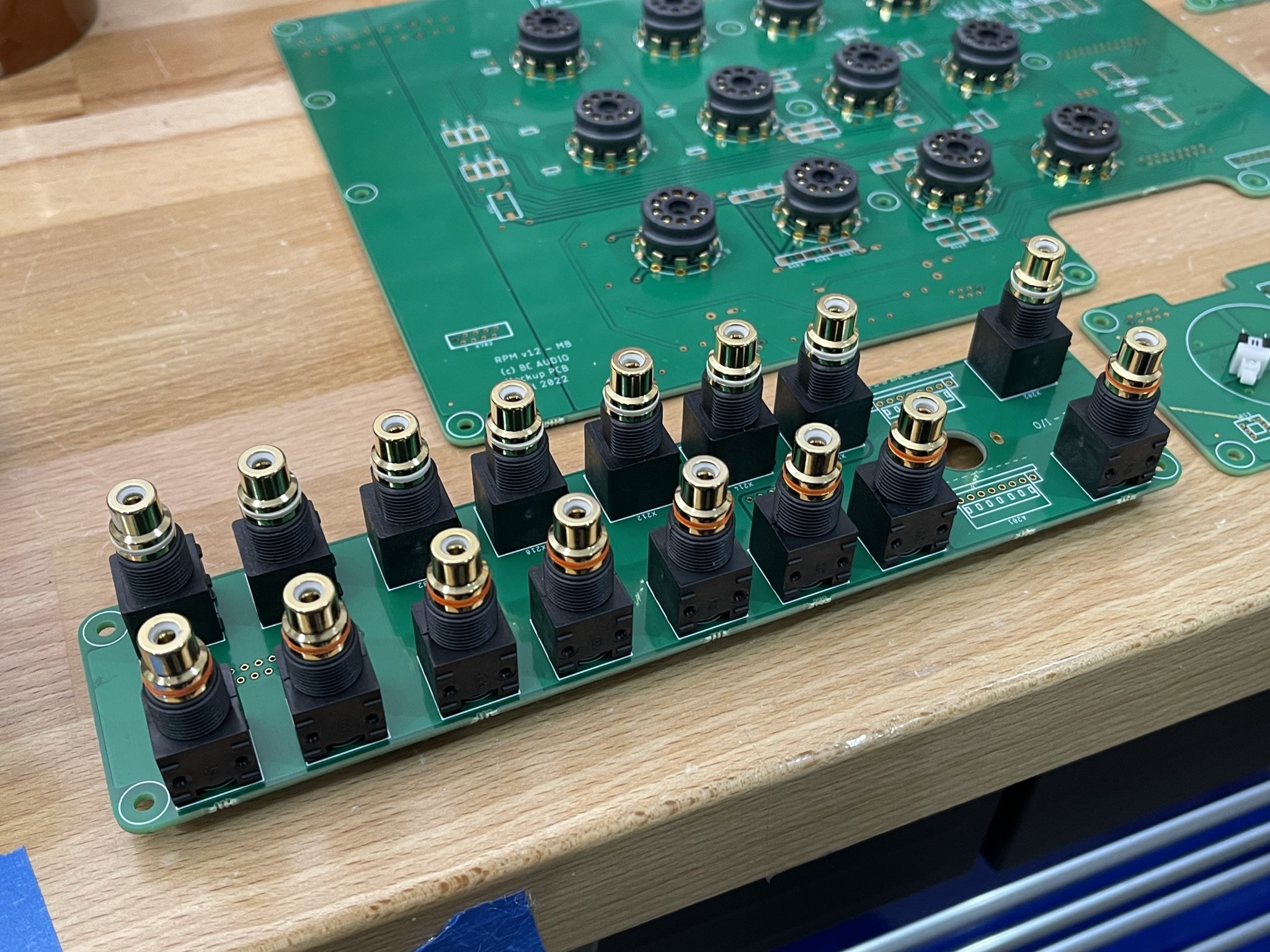

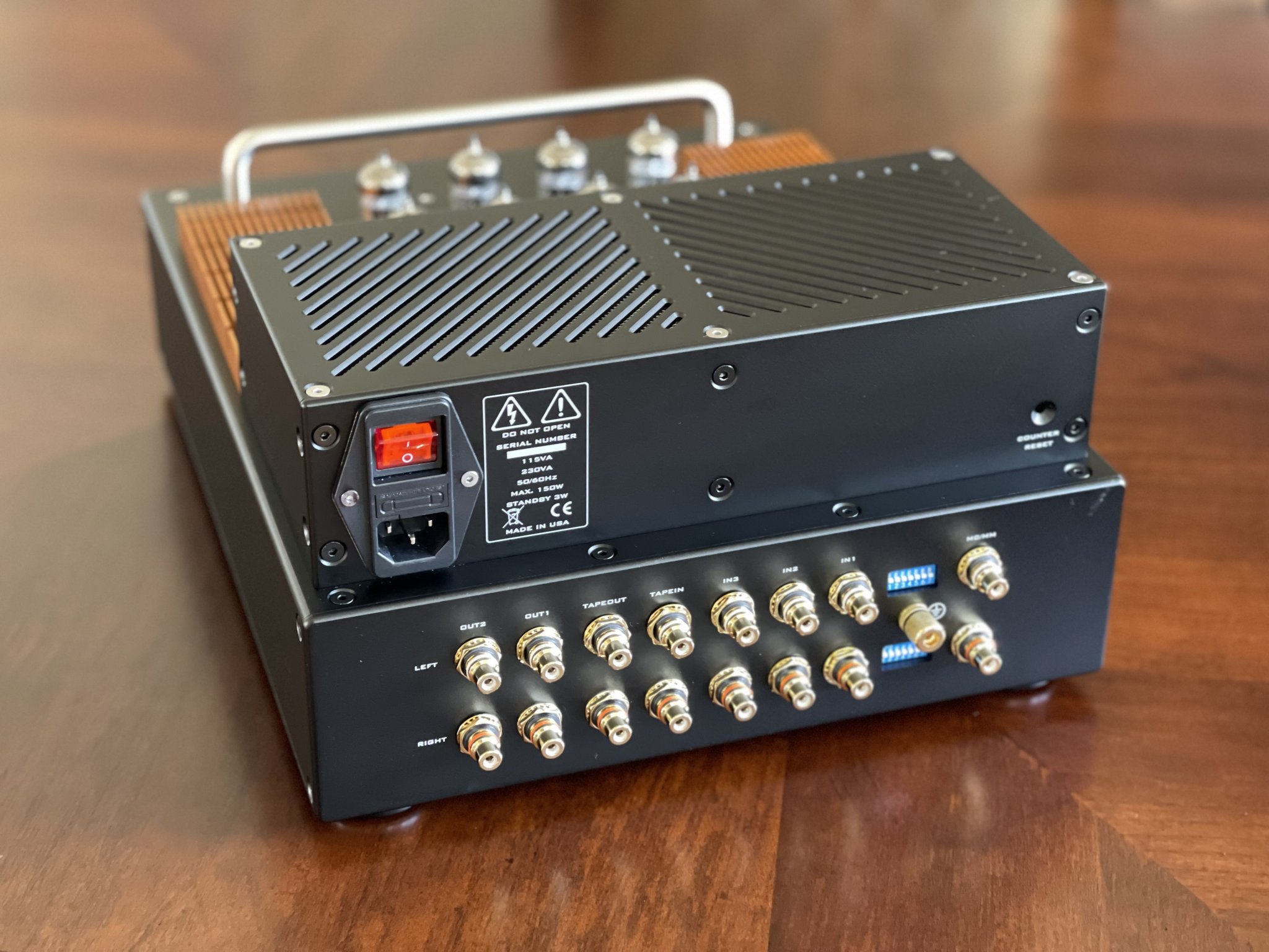

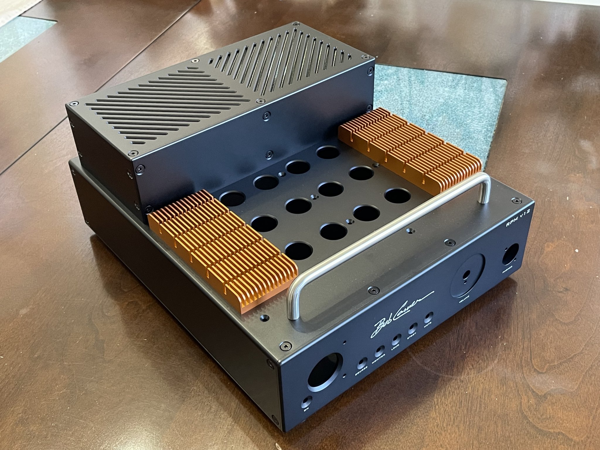

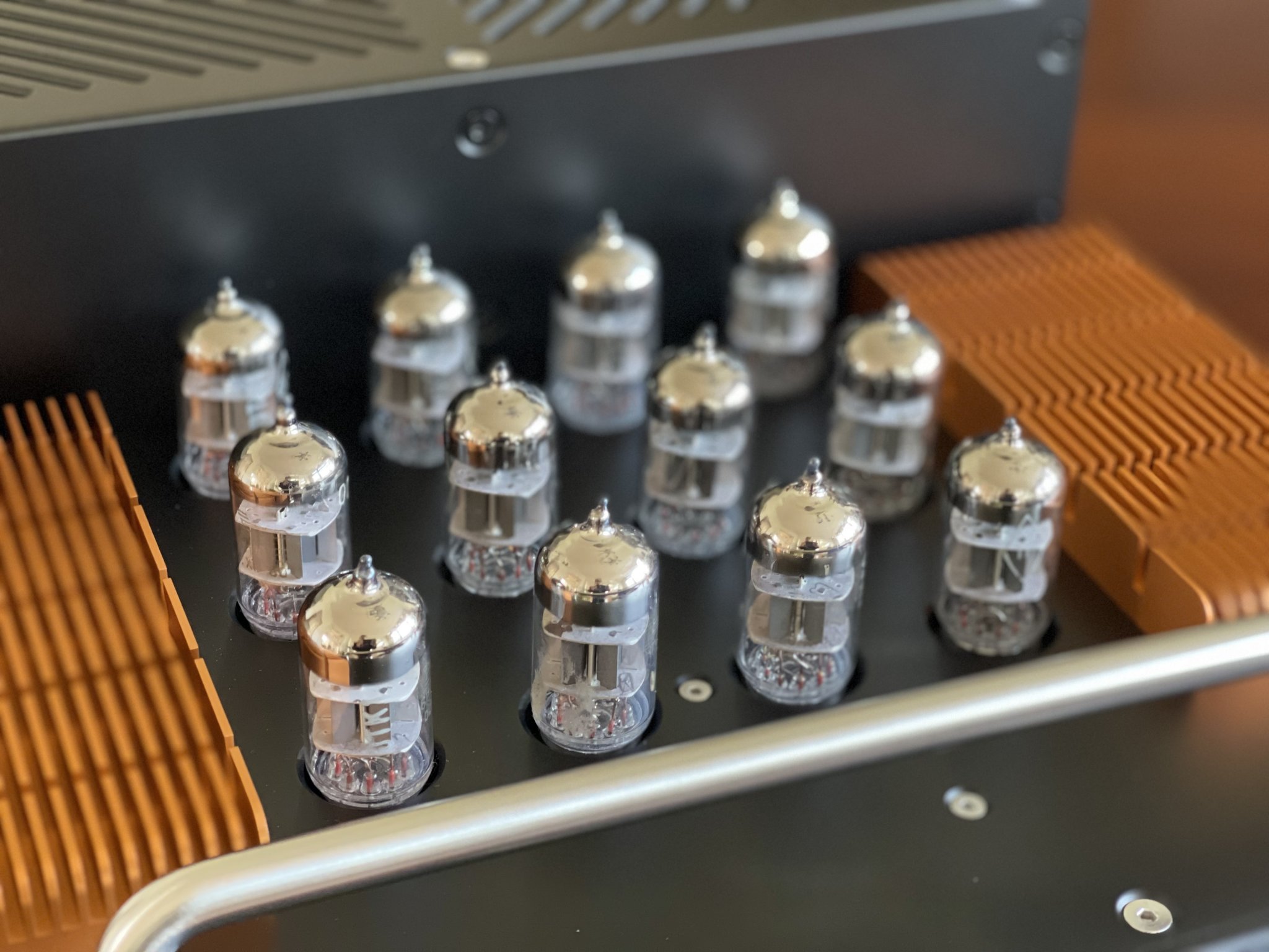

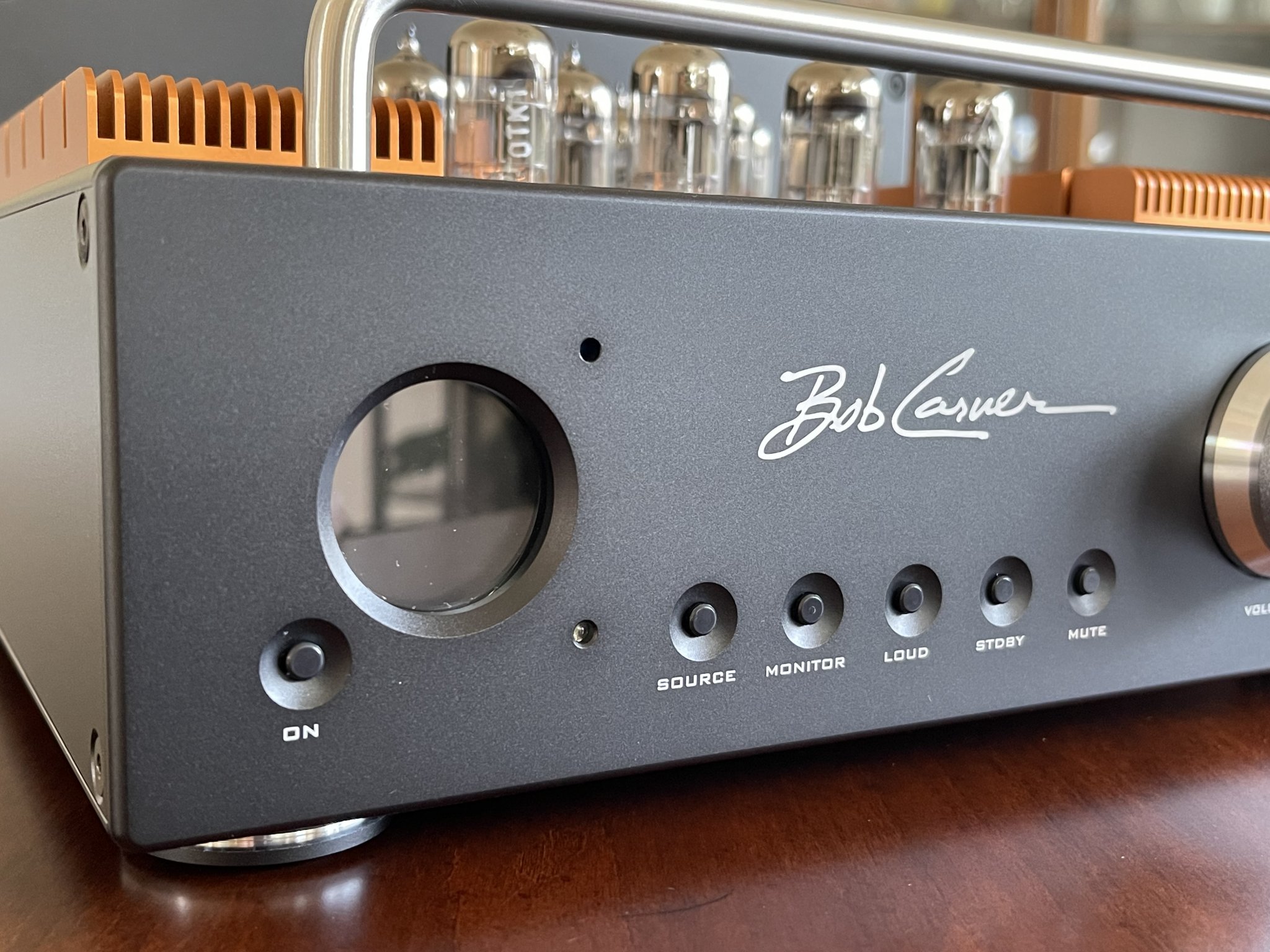

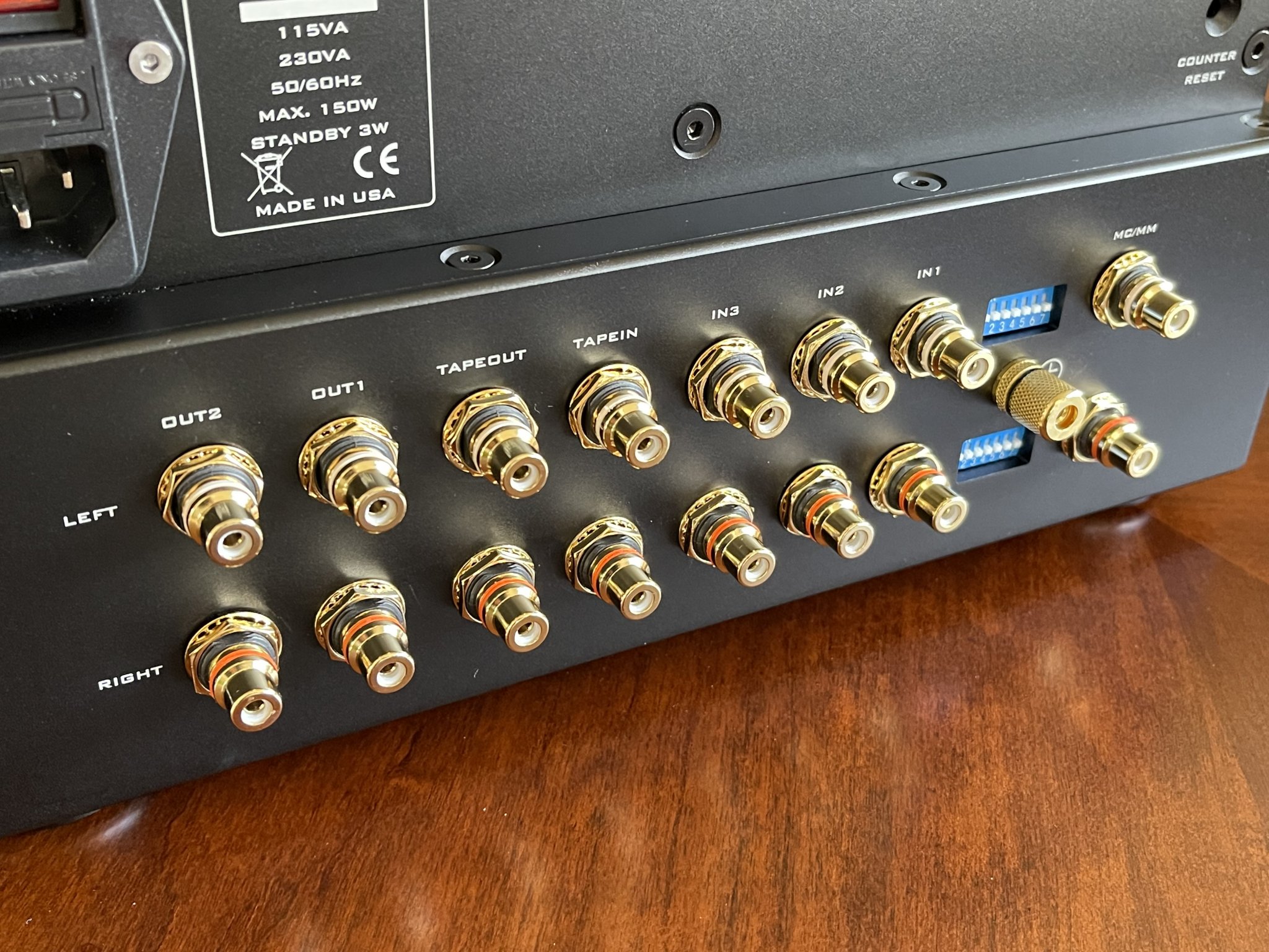

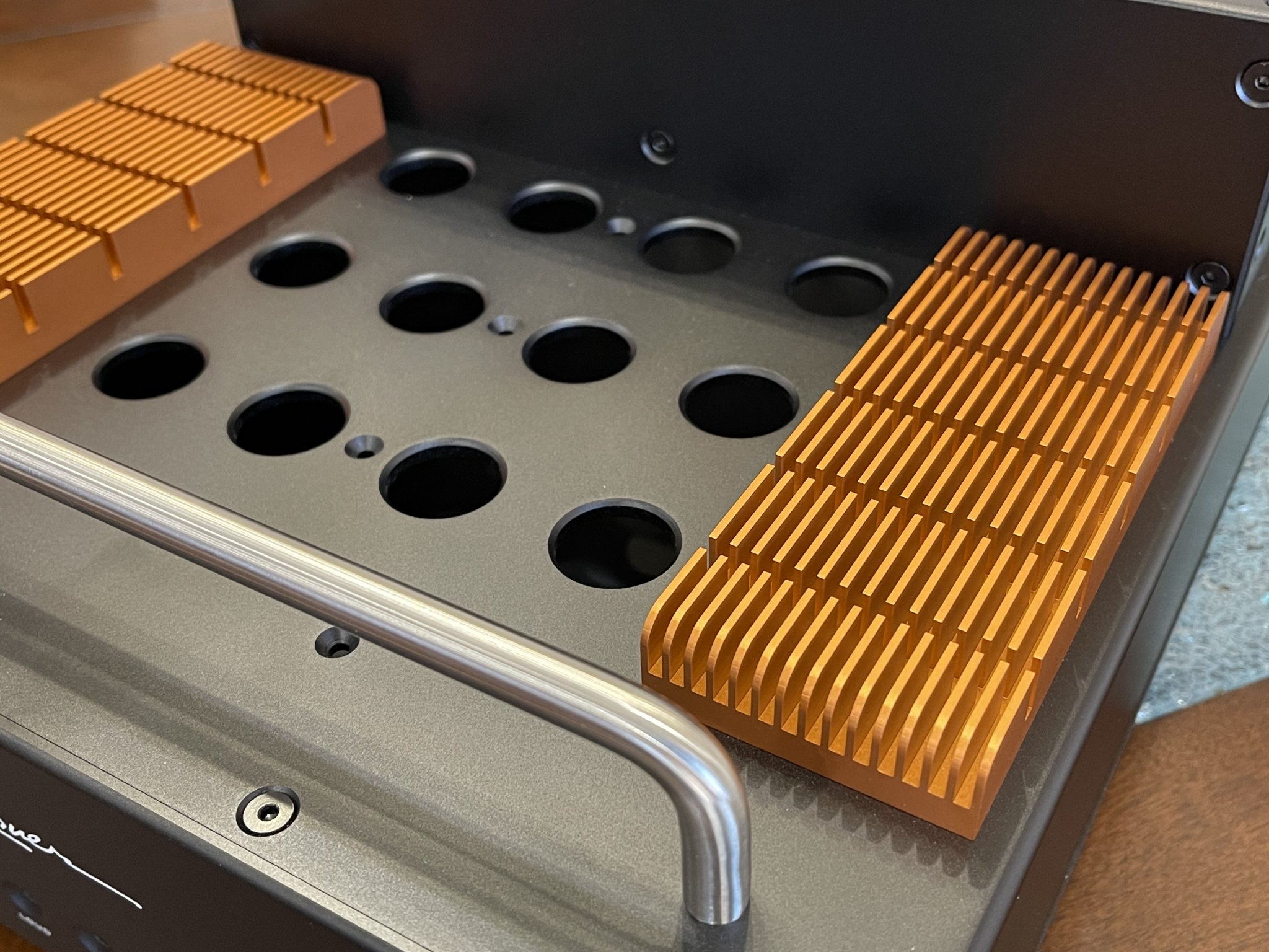

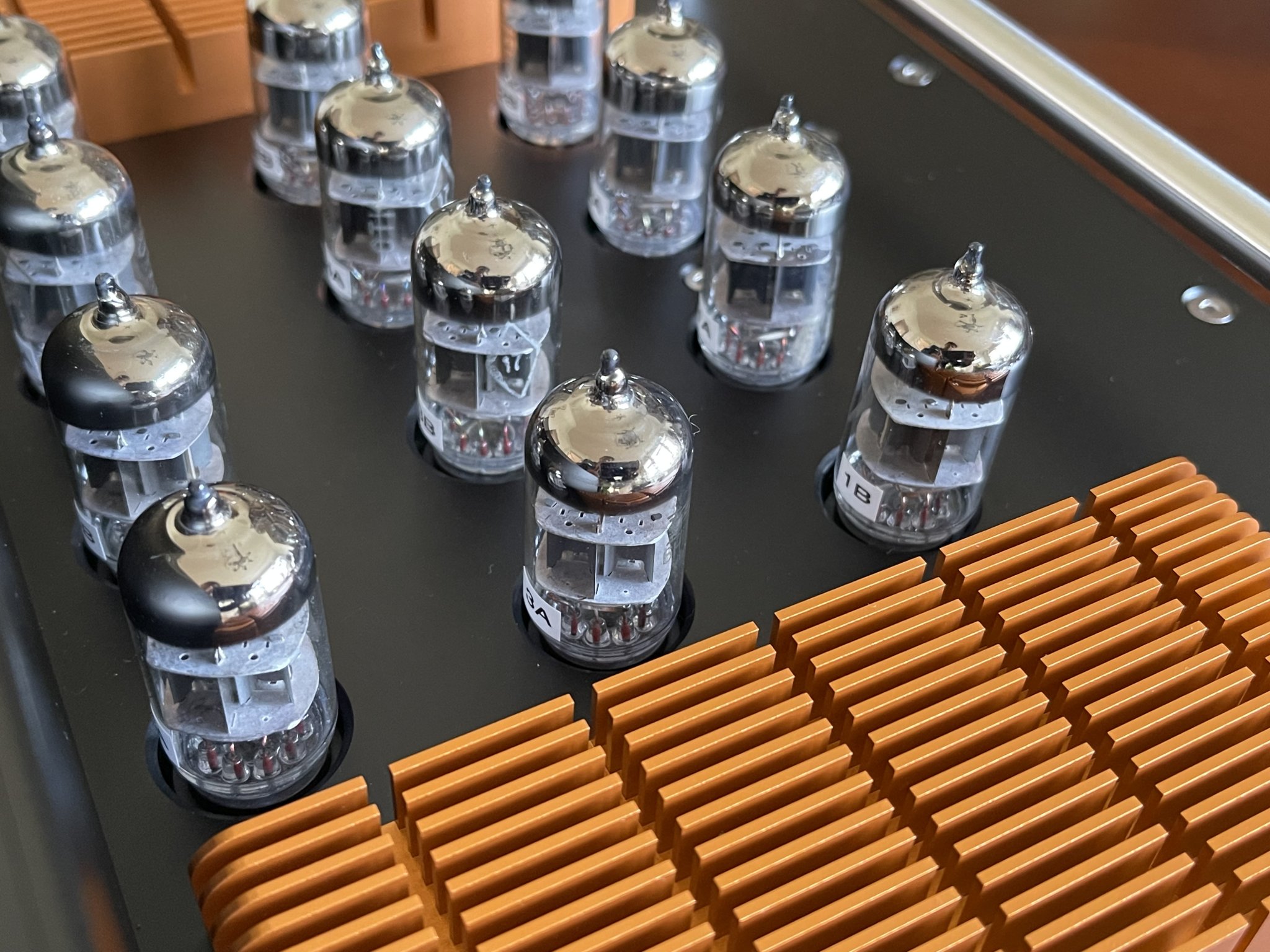

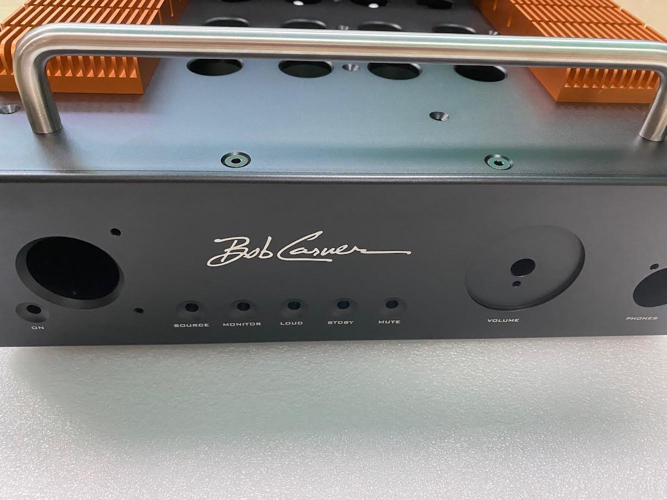

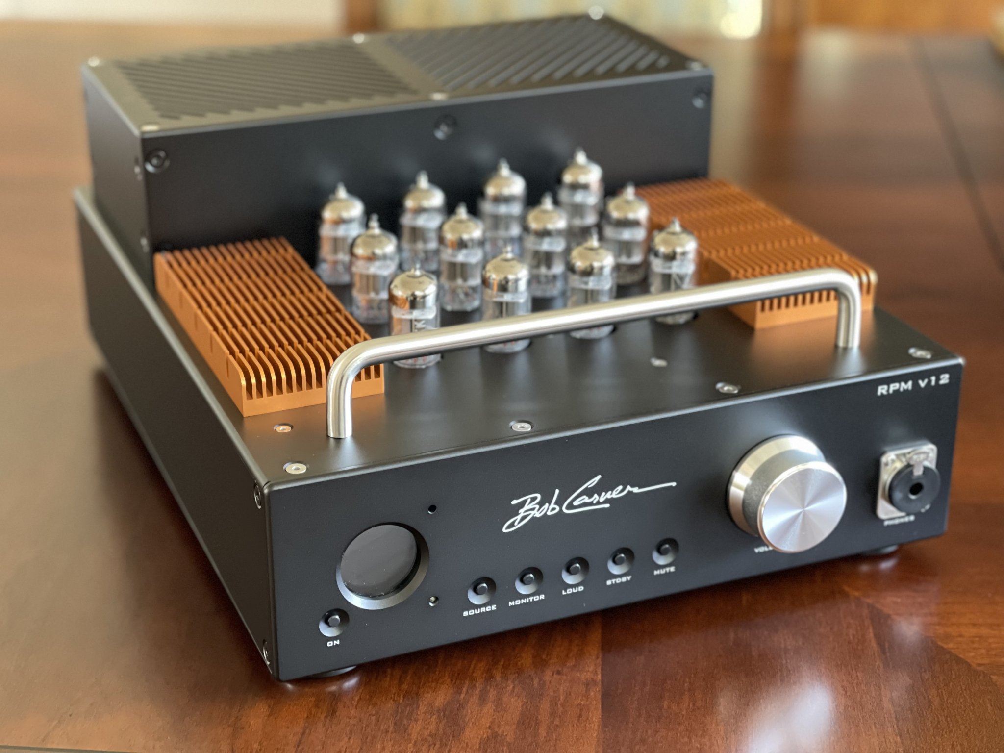

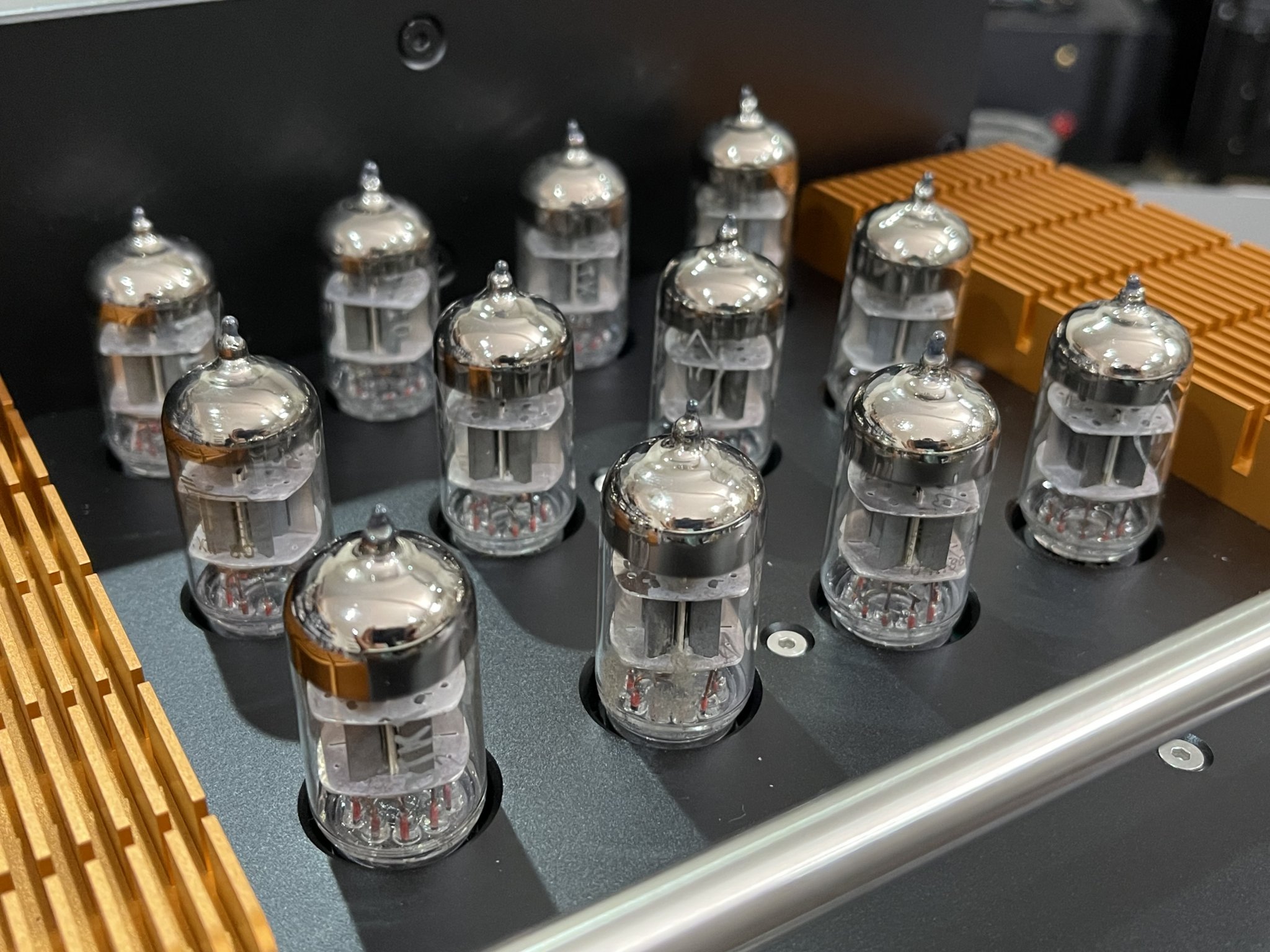

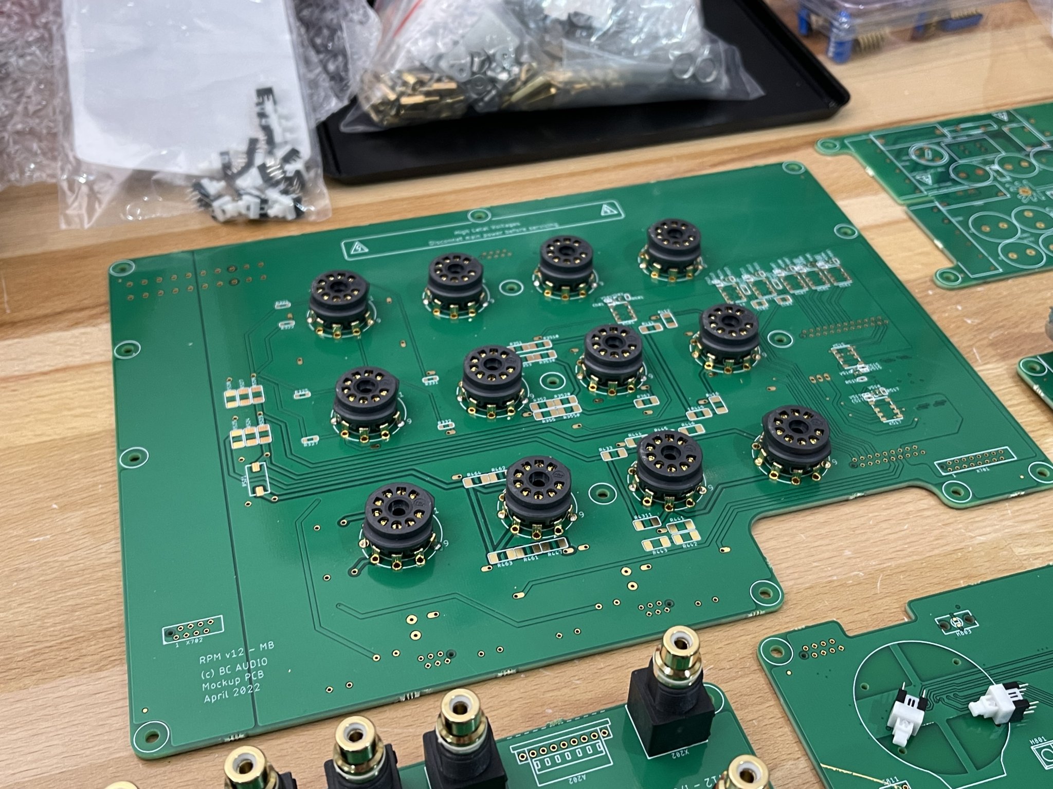

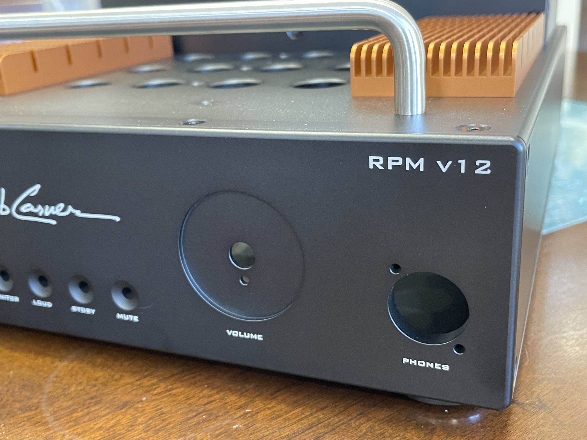

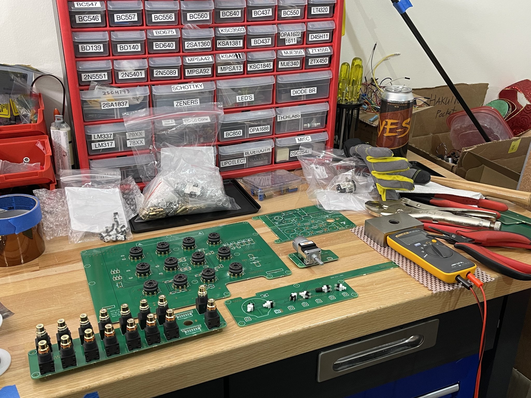

On the bench tonight is the Bob Carver Reference Preamplifier Model V12, or RPM V12. That’s 12 valves for V12. JPS64 and I have the opportunity and privilege to help Bob Carver and Jim Clark on some of their new upcoming projects. The first one is the RPM V12. We have been working on this project for the last 10 weeks and helping Bob Carver design the integrated preamp system and chassis around his circuit design for an all tube MM/MC phono preamp and general all tube preamp. We developed the overall system and integration of the all components custom chassis, the PSU, relays and MCU for remote control with TFT display and motorized pot. Also, we provided the SE Class A hybrid headphone amp. This is going to be a very cool preamp with 3 selectable inputs plus phono, tape monitor pass thru, and two outputs. I am building the show and tell prototype for Axpona 2022 (Chicago this week). Tonight I am soldering the tube sockets and RCA jacks. Still waiting for the chassis prototype to show up. Some delays with a lot of couriers lately.
This is a render of the RPM V12:

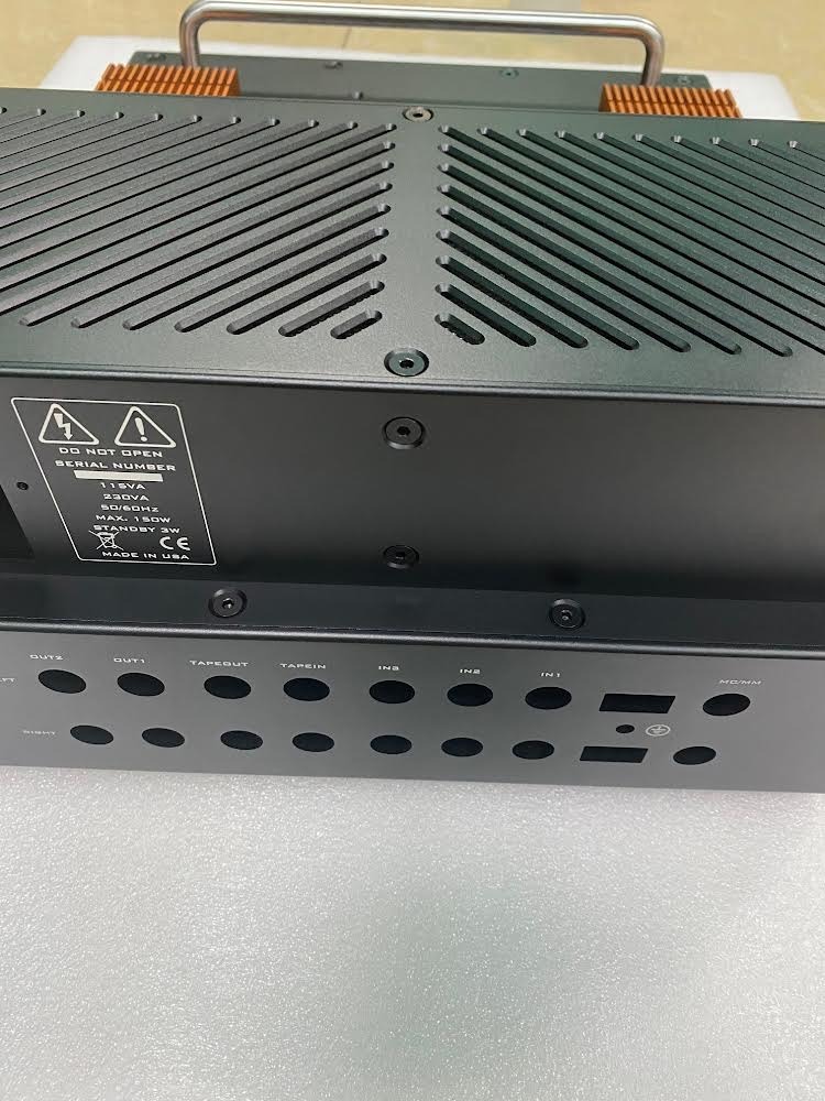

Chassis prototype:
If anyone is going to Axpona, let me know and l will get the room number for the exhibit. Coming up in the future is a 200w push pull tube amp and a 350w push pull monoblock tube amp (6x KT120’s).

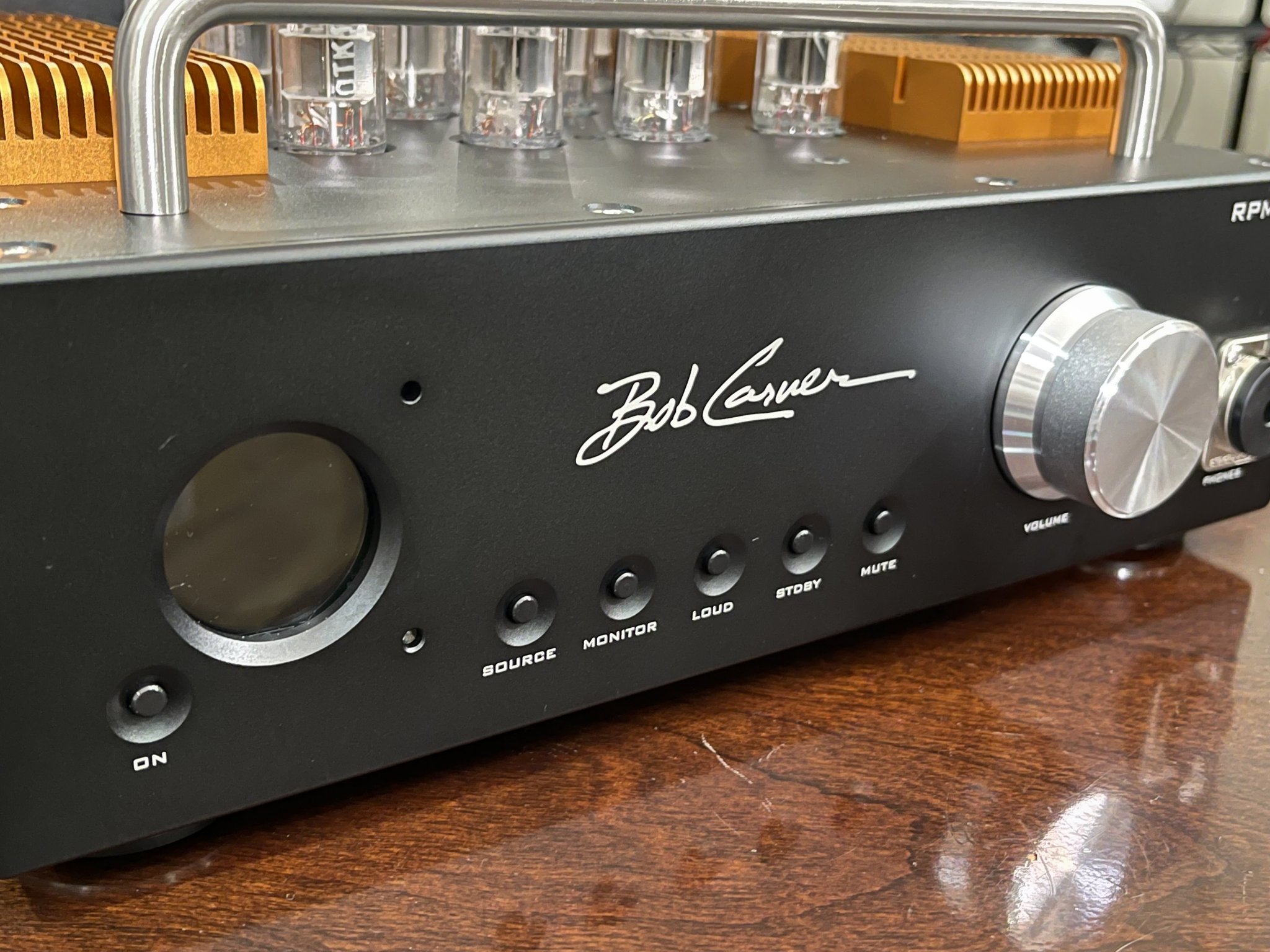

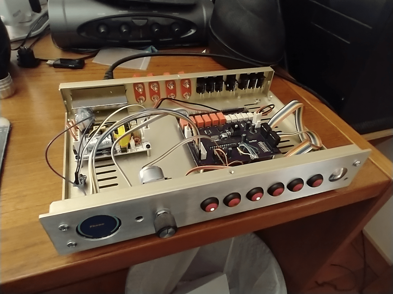

We are working on the MCU and remote control in parallel on a separate pathfinder chassis. Making sure al the relays ‘click and clack’ and the motorized volume pot works and the TFT screen works. We need to upgrade the MCU to something more powerful as this is a graphical display and will show volume position. We even have the ability to go directly to a volume level based on remote control input.
Luckily, we have great expert help here on MCU hardware and programming from Neil. Same with the mechanicals, superb design work from Darko - we have a superb team that made this possible.
