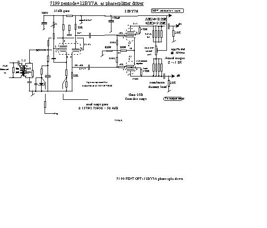

Okay I'm beginning to duck behind my bench. In all the years of tube amp revelations it didn't take me long to find that in a conventional 3 or 4 stage p-p amp, how each tube stage has an influence on the loading of the preceeding tube. The situation isn't quite clear cut and far more complex than meets the eye. The Miller effect paints quite a different picture when it comes subtle detail of complex HD between stages, cancelling and addition goes on, albeit at quite low levels. Take the example of the concertina phase splitter followed by a balanced Common Cath push pull voltage driver i.e Williamson type. In all but the worst misbalanced cases that particular configuration does an excellent job in ironing out the slight misbalances created by the phase splitter. Some might say I'm defending the concertina, (yes I am), and mention that using this configuration one is really creating a 4 stage amp. The noise contribution from a split load med mu triode stage can be ignored. My arguement is when it comes to phaseshift, I see it as a 3 stage because the anode of the preceeding tube is usually strapped to the grid of the concertina which doesn't create phaseshift.
In the common cathode type driver looking at the common cathode with a Oss''cope the misbalance can be easily seen, the secret lies but splitting the cathode to ground resistor and then providing a dab of local feedback by strapping the grid resistors. to the split cathode resistor. see dia.
The poor PSRR of the anode (concertina) can be ironed out by the use of global feedback,but I prefer proper stabilised B+.
For those tube newbies wondering the importance of global and local NFB; simply,one can compare NFB to the effects of cycle/cycle correction in switchmode psu topology. i.e correction on a cycle per cycle basis. In a tube amp all goes to pot to high thd when bandwidth slewing starts. How much global NFB ? How much S/N ratio can one tolerate ? so many issues relating to sound quality.
Results; for a start I nearly always use pentodes confiured as triodes. ...even in preamps....the better bandwidth and low capacitance arguments of ex video tubes is compelling evidence to reduce Miller influence through other stages....these make excellent building blocks. The individual stage performances have improved, but we still have a little problem with the high frequency end of the output transformer and how much HF compensation to throw in.The square wave business which EC mentioned is a great help, but becareful with dummy loads and the real LS with a wretched crossover networks. The scope problem can also do it’s silly things with earthing, and where lead placement is...I can assure everyone that the algorithm of HD, NFB and phaseshifts is more than looking at a water melon pulverised by a shot gun.
richj.
richj.
