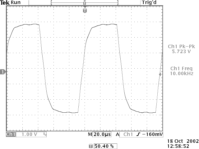

I'm not able to test my SE amplifier right now (CV, could I have it back one day?), but I dug out my lab book. Maximum power (output stage onset of grid current); 6.8W at 3.2% THD. Distortion at 25Hz 1dB below full power 3.5% (H2 = -29dB, H3 = -54dB, H4 = -55dB, H5 = -79dB). HF response; -1dB at 14kHz, -3dB at 26.5kHz. The price paid for decent LF response is a less-than-perfect 10kHz square wave.

Looked at from a different angle, of my two EL84 SE amps one is the venerable Mullard 3-3, a direct-interstage coupled high feedback (for a SET) design. At normally listening levels, say ~2-3 volts P-P into a pair of 12" Tannoys, the mid-band distortion measures about 0.1% or less across a wide range. The second amp is a self-design and uses much the same parts (Russian EL84M, Mills resistors, ASC PS caps), has feedback only around the OPT stage via the secondary as a cathode load, and measures THD five times worse than the Mullard. The Mullard is far and away the more abrasive and hard. Spectral analysis of the harmonics afterwards almost certainly revealed why. The Mullard achieves low single numerical THD by clamping down the second harmonic at the expense of a dense series of higher harmonics into the teens. The home-brew's distribution is strong second, a third 10-20 dB further down (lunch break, graphs at home) and very little else at the same operating level. From an engineering perspective the Mullard would normally be considered five times better everything else being equal.
And what did stability analysis reveal?
Hadn't considered it, one circuit is a 50 year-old textbook and time-tested Mullard design and the other has ~ 6dB purely local feedback. What would be the advantage over a spectral analysis?
Hadn't considered it, one circuit is a 50 year-old textbook and time-tested Mullard design...
That doesn't mean it isn't unstable at the frequency extremes, or that it doesn't have large amounts of distortion there either. I've built "textbook" circuits from the 50's/60's (literally out of textbooks) that had 6dB or more peaks at 2Hz and 80kHz. Guess how those amps sounded?
Never assume.
As for spectrums, they are only one bit of information. You need all the others to put it into a valid context.
Joel
Yes, it's well worth checking the stability of a circuit with your output transformer and your layout - otherwise there's a real danger of simultaneous HF and LF instability. A 10kHz square wave quickly shows up HF problems, but if your oscillator can't do square waves, then a quick sweep to check that there isn't a peak in the response is almost as fast. At LF, a slow sweep is needed. (The typical Wien bridge oscillator takes "x" cycles to stabilise, and while that's fast at HF, it can be quite a while at LF.)
