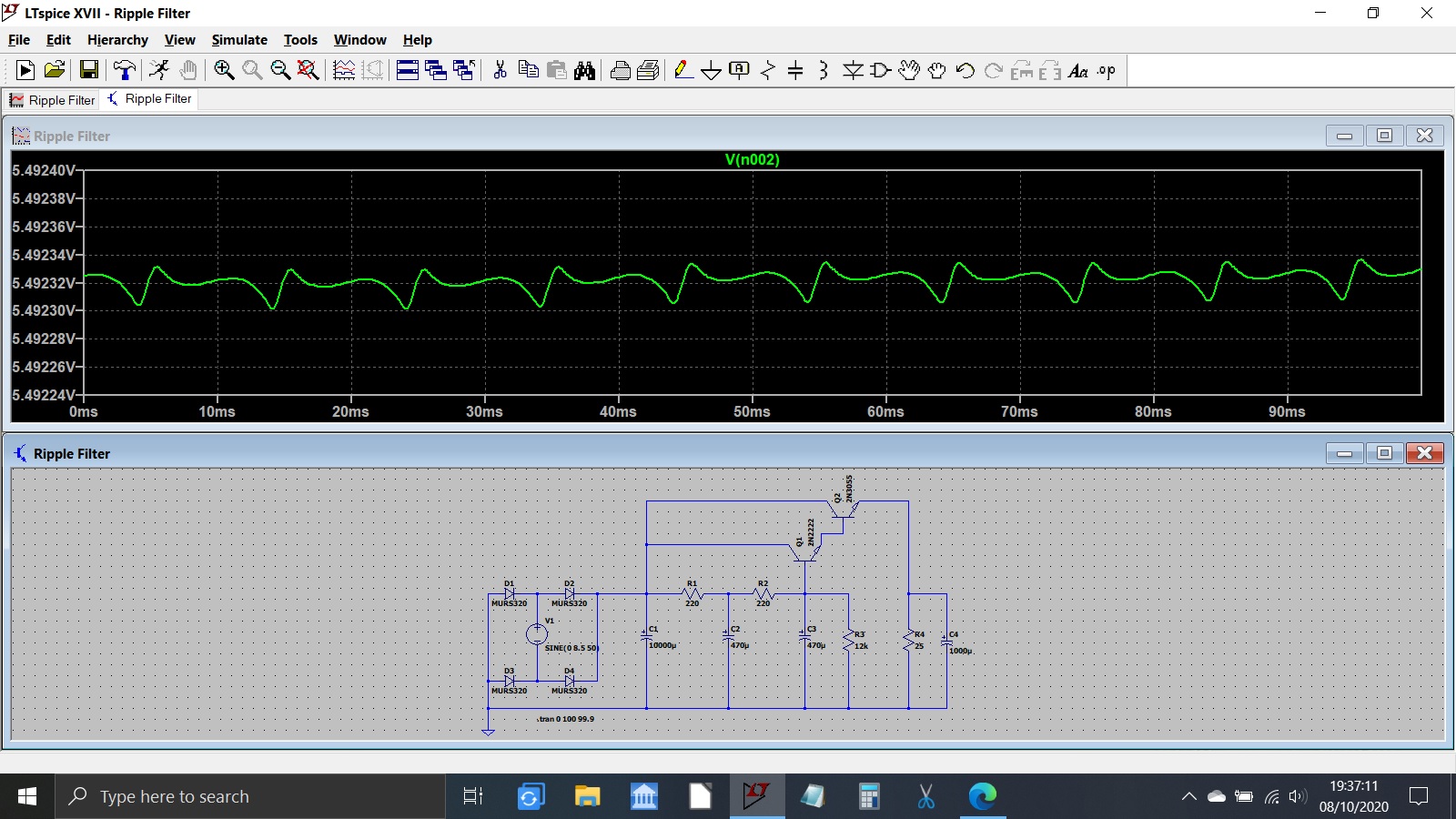

Here is a quick sim of your circuit. Ripple should be very low.
Wow thanks, (I wish I had the time and patience to learn LT Spice). I should have mentioned at the outset that this is Rod Elliots circuit and can be found here (figure 3 is what I built just the + leg no CT):

Yeahbut... a "simple" spice has no wiring resistance. But a real cap-input rectifier and filter is very sensitive to parasitic impedances and circuit layout.
That is true PRR, however it is relatively easy to make wiring resistances 'disappear' in a real build. Circuit layout is important I agree.

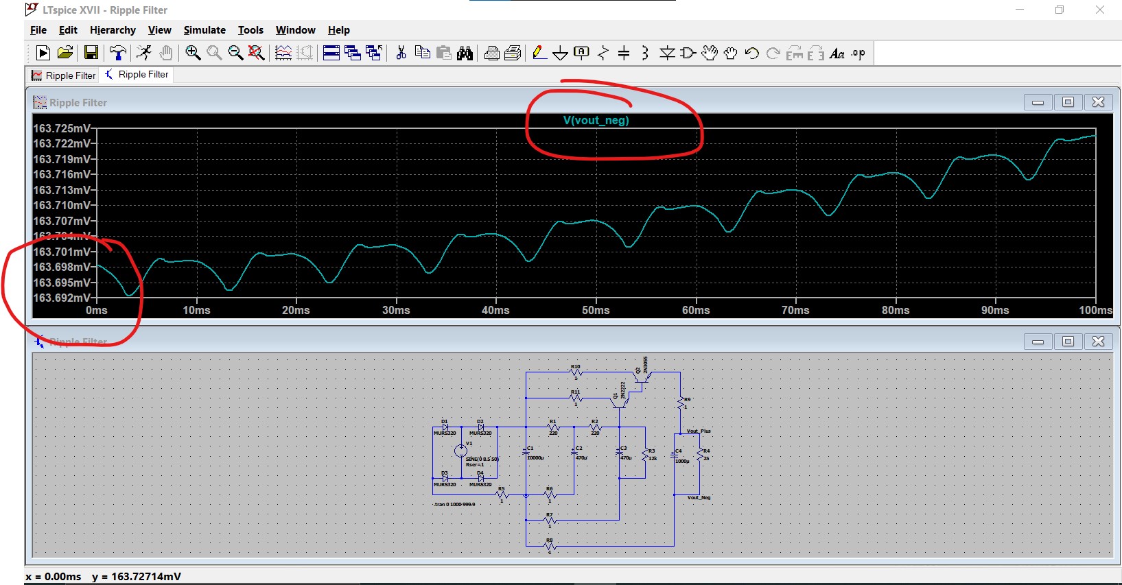

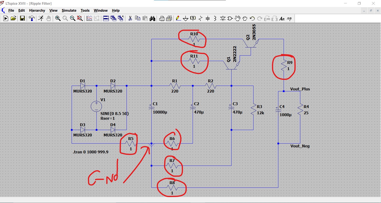

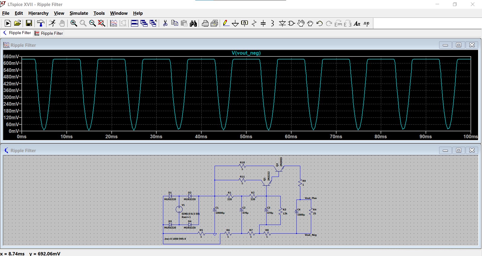

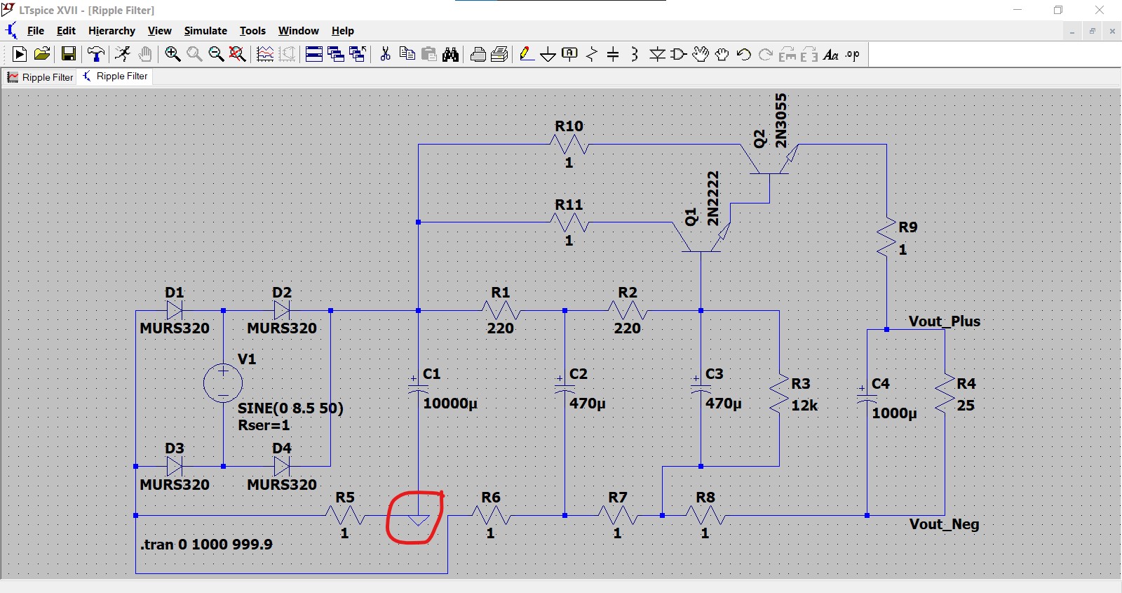

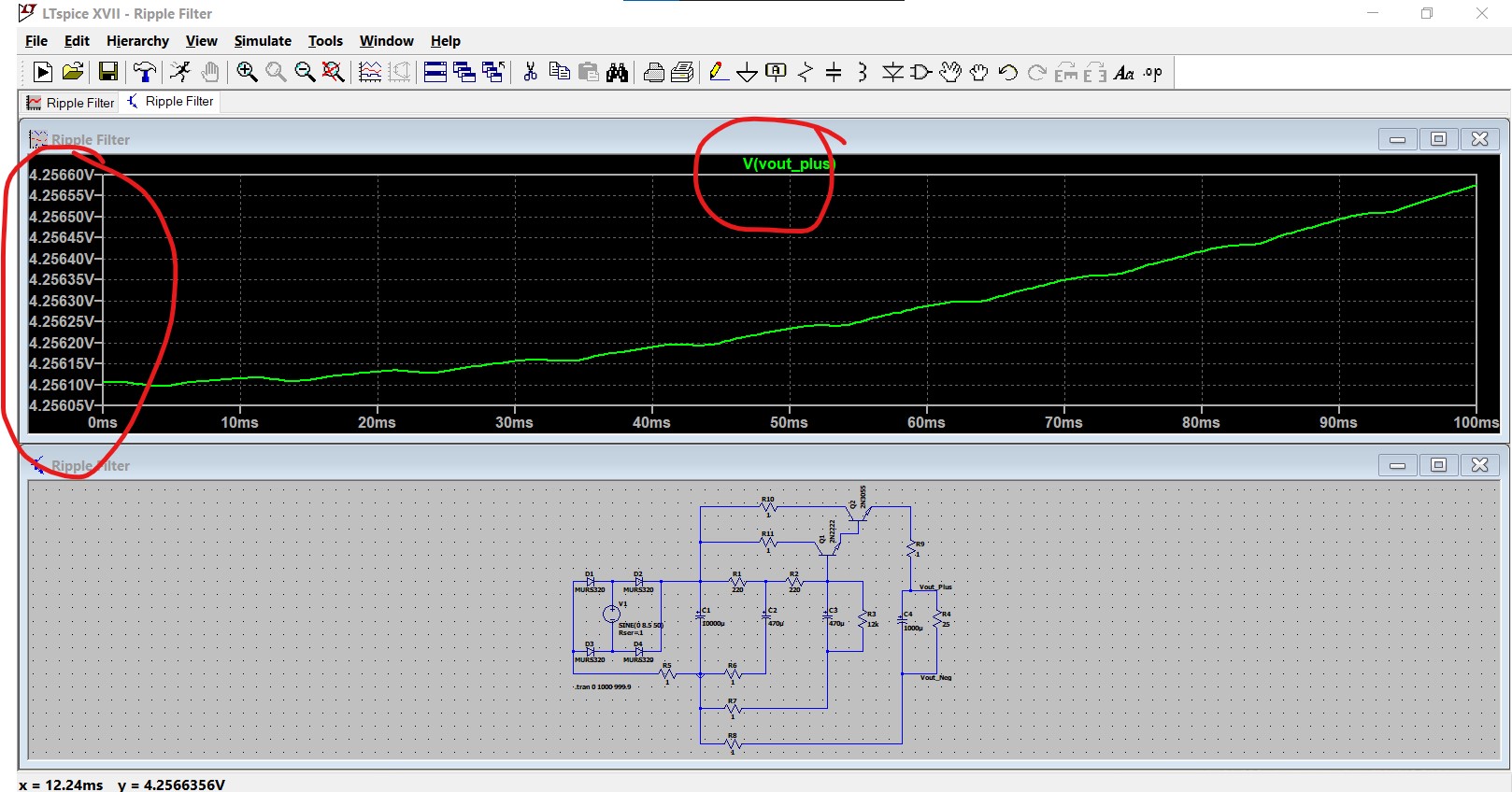

Here it is with 1 ohm series resistance all over the place. As long as you stick to the rule of having a single ground reference point the additional resistance causes no issue apart from a linear volt drop that is load dependent.
The last three images show 'bad practice'.
Also as I mentioned earlier, inadvertent loops formed from test equipment ground leads can appear to show a problem when one doesn't actually exist.
