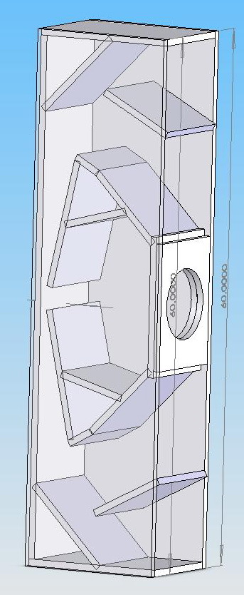

what's best enclosure design for Coral Beta 8 Speaker ? which horn ? Schematic ?

You test a large number of drivers because no two drivers are exactly the same. Generally figures + / - 5% of the average are considered acceptable. That's why you will frequently see the phrase 'pair matching'. Specialist sellers like, for example, Planet10 hifi (Dave), Validator (Thorsten) etc will test a batch of drivers themselves and match them into pairs who's characteristics are as closely aligned as possible.
MathCad refers to Martin J. King's seminal MathCad worksheets, which I use in designing every speaker I come up with. There's a variety -horns, TLs, isobaric, sealed box, open baffle etc.
I ran a quick check. Q of the Coral is a little high to be ideal, so the low frequencies roll off a little below 100Hz, but in some ways that's probably a good thing as Bruce could get a bit hefty with some drivers unless you're careful over setup. You should get a solid 40Hz. The Schmacks horn I've never modelled in MathCad -I really should look into it at some point. It's got plenty of internal volume, so it should do well -by the above accounts it works well enough.

" Should do. If you want a tweak, increase the cabinet width by 1in which should give a bit more volume, which the Coral likes. Otherwise it should perform decently."
increse the width by 1 inch, so it become 11 inch right ?
just make sure, so I think I decide to build this Bruce 1.1
do you think thicker MDF will be better ?
cal

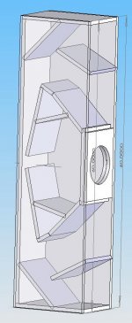

pic
There is a Schmacks version made in France where the driver is situated in the side on the cabinet and they have some helmholz resonantor to even out the response.
Jericho 08 in Hobby Hi-Fi 02/2008, has more elegant proportions than the squat Schmacks horns. 0.4 m wide 1 m high and 0.5 deep. I plan to build these for other drivers.
