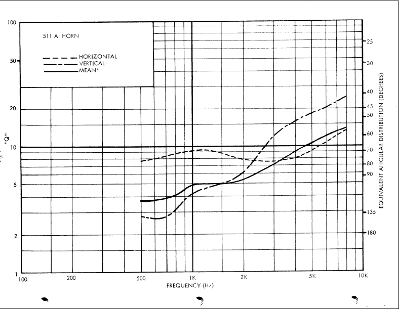

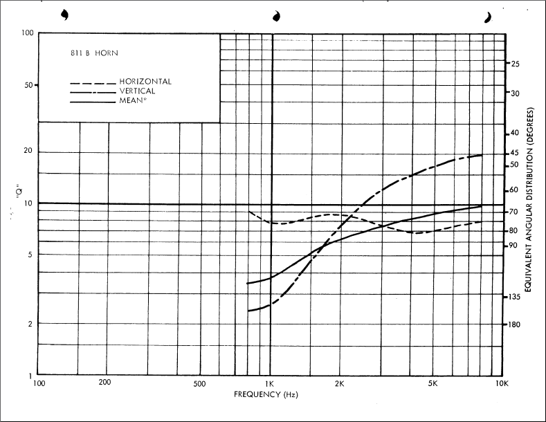

I tend to think of those two horns this way:
811 for indoors
511 for outdoors
Or if you're really crazy like me you use the 511 for mids and 811 for highs. Whatever works.
Agreed in that the 511 loads to a lower frequency, ergo controls directivity better with the trade-off being it beams more up high. Still, I much prefer it sonically to the 811 overall once EQ'd plus it has more tuning flexibility same as a large Vs merely adequate, size bass bin.

Correct, and it's what WGs and mouth round overs address. Note that the horn in the picture was designed for high speech intelligibility in the 'telephone' BW with a well defined power response, whether it be located up on a pole, behind a cinema screen or in a HIFI app with the latter being a very limited BW circa 1950 when it was released. Still, cutting out the vane welds and bridging the gap with silicone helps with mouth resonances as does adding a thick insulation 'baffle' around it.
Mounting it to a rigid baffle is a 'mixed bag' in that it helps to mechanically damp the horn and complete its truncated mouth, but also adds strong notches in its response if its edges aren't well damped, so ideally you want to mount it to at least a ~30.5" wide x 21.56" tall well braced/damped baffle to ensure that the XO has rolled it off enough that there's no eigenmodes worthy of the name being generated to reflect back to the horn's throat.

Yes, but...... if the horn mouth is already large enough to support its 1/2 WL XO LF corner frequency such as the 511, 811 has, then any edge diffraction will be quite high in frequency, ergo of very low amplitude and while out-of-phase it adds a bit to its HF polar response up where our phase hearing acuity is ~non-existent. Altec chose to add the vanes as reflectors to both deal with HF beaming and intensifying this diffraction, so the downside to the damped baffle in my previous response is a loss of HF, especially off axis and if a super tweeter is used, then the throat needs damping to flatten its power response.
Anyway, while these horns work well for what they were designed for and can be tweaked enough to work well enough for many folks in the 'digital age', they belong in a period correct app for best performance and let true WGs have their time now that power is plentiful and digital delay is no longer a 'pipe dream'.
