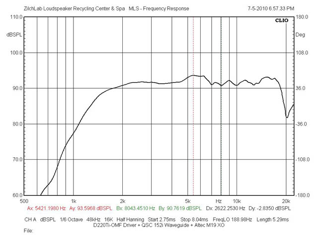

804/806 is suitable for 3-way only, a formidable task when using them on these sectorals. Here's my work with the Selenium(s) from several years ago:
Drivers for 811b's ? - AudioKarma.org Home Audio Stereo Discussion Forums
If you want all Altec, use a new GPA 902 driver with a Model 19 crossover on either sectoral horn.
Just click the link to "Deluxe" in the first post to see the QSC waveguide in situ. I've never run Seleniums on them, but may do that later today to get some comparable measurements. I can virtually guarantee it will both measure and sound better than the 811 or 511, and only costs $12.50 new, direct from QSC Parts....Funny thing is that I understood the Russian link more than I did the Econowave one--I don't speak at that high of a technical level, I'm just a piano player...

The world is a strange place. My listening and measurements show quite a difference between the 2. And a good 804 driver will go high enough on the 811 not to need a tweeter. Tho a super tweeter would be fun. So you see - what can you do?
But anyway. The QSC horn/waveguide thing will give you great sound for cheap, so why not? Slap on a Selenium or other new driver and you'll be rockin' in glorious mono! No need to over think it.
