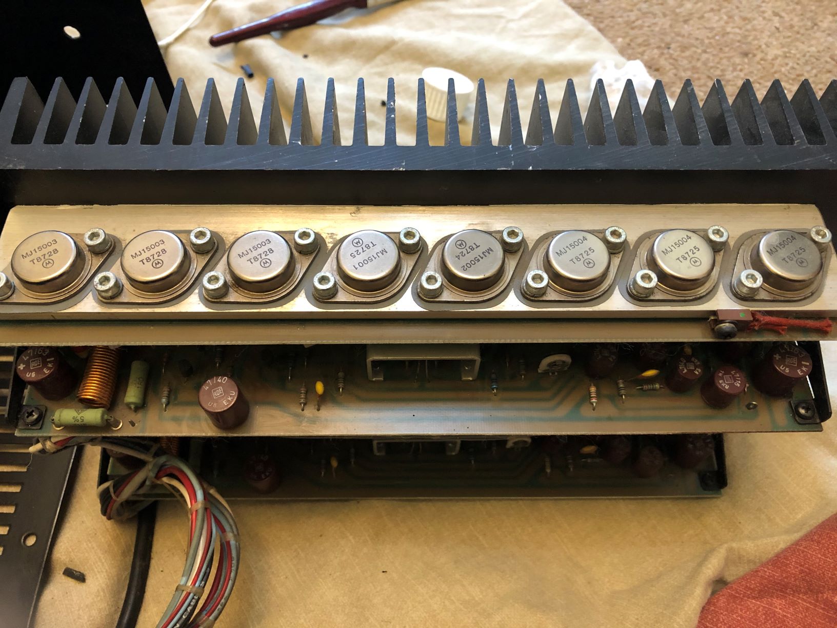

close up of a couple of the ROE caps on the bad channel. Hopefully these may be the culprits. Will start here when I start the cap swap out.

I don't see much knowledge gained by inspecting cases of old electrolytic caps for damage. Yes, pushed out ends and a puddle of cap slime is a good indicator. Usually they are garbage long before that happens. The little ones never pop, they just quit passing sound, or not enough, due to high ESR. I bought a Peak ESR meter, but it wasn't a lot of help. Looking at production date versus the calender on my wall is the best prediction of e-cap condition. Plus the reputation of the manufacturer. Apex dtv converters, bad from the store. PCAT supplies from the local computer shop, 2 years. PCAT supplies from Newark, 10 years. Peavey amps, 15 or 20 years. Fender guitar amps from the 70's with the green CDE epoxy sealed caps, forever.

That's a 35 year old amp. I would say that all of the electrolytics should probably be replaced. The schematic indicates that each amp is really operated as single ended, so I would have replaced the (gender incorrect) XLRs with RCAs. As far as the op amp is concerned, a 5532 might be better. Even if it is, it might not be audible for your intended purpose. Still, it's in a socket, so easy enough to try out (and really minimal risk that the swap will make anything not work). Many (maybe most) of the signal path caps might be suspect due to age, but I would change those last unless there's clearly something wrong.
As to why 1 channel isn't working right - this sounds like a failed component to me. If you can't see any visual damage (physical or heat damage on the PCB), it'll be a slow game of detective replacing parts until it works. I would start with by cleaning the PCB and looking carefully if there are any suspect solder joints. Resolder anything that looks even minimally suspicious. Likewise all of the wires running to/from the PCB. Check the solder joints and jiggle the wires around to see if something changes. Next I'd replace the op amp as it is cheap and will take seconds to replace (not that I really suspect it to be bad). Next I'd do the caps as resistors rarely fail without some physical signs.

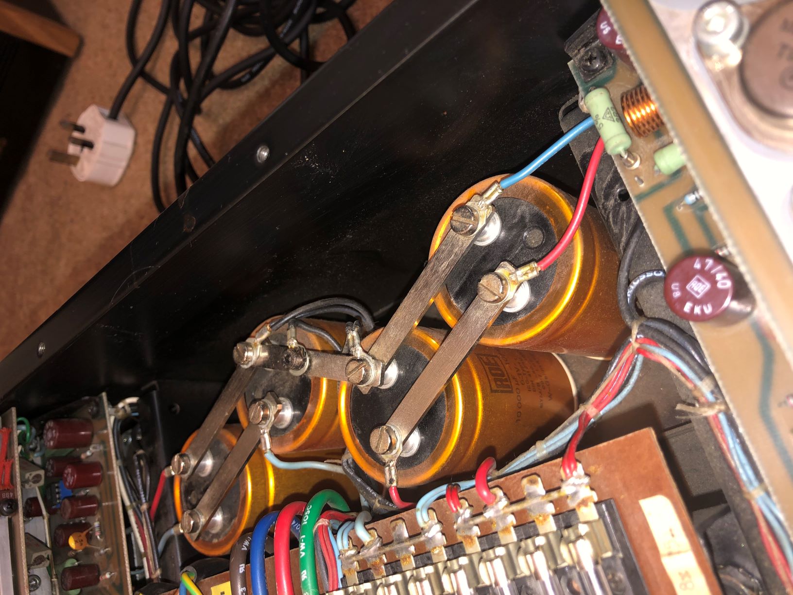

Knost - probably so, but when they fail they do so dramatically! Besides, if you're going to do a bunch of work rehabilitating an amp you would want it to work right for another 20 years. Do you think those electrolytics will last 55 years??? That's why IMHO once you are elbow deep into a project like this you may as well change the big filter caps.

Am I mistaken or are the outputs fake? I've never seen Motorola/on semi with lettering like those. Generally all Japanese TO-3's have lettering that goes in that direction. I do think the outputs are fake. Not enough outputs to drive a low impedance load (my opinion) or low frequency load. I wouldn't have bought it. You could have purchased a Altec 9444 or EV2600 for the same price and it would have been a superior amplifier. There is a point where your time and effort are not justified in a project and this is one in my opinion.
A picture of a 1983 vintage Motorola transistor.
