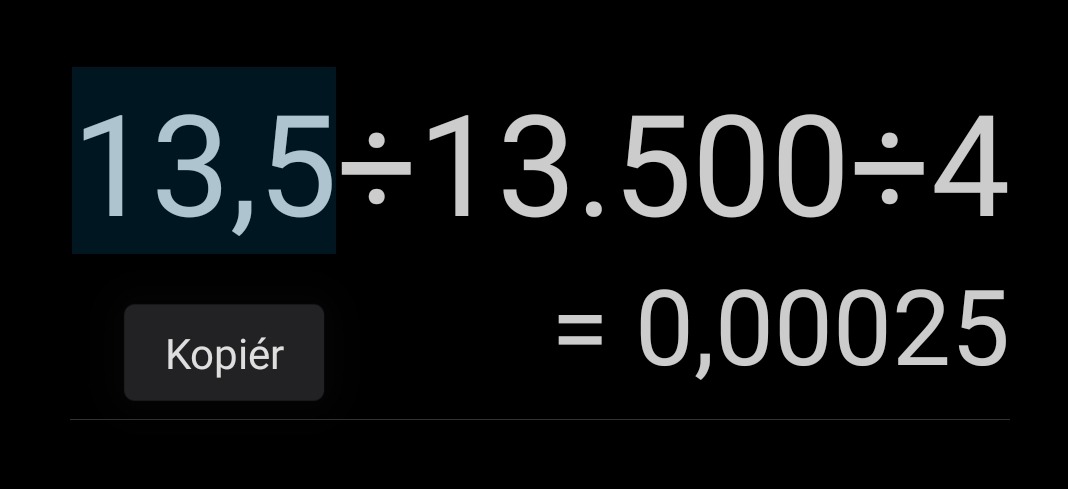

13500/Dcc/4 > maximum XO frequency (dimensions are in inches). You got the above wrong.
If the distance is 13.5” then the max XO frequency would be at 250 Hz or less than in an ideal world. In the actual case of the illustrated MTM Dcc is 13.2”.

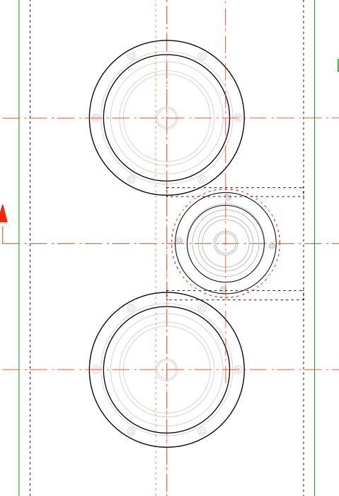

Thank you. Can you explain the reasoning behind this please, and would the same calculation apply to a two way loudspeaker?View attachment 1289171
In the above speaker, take the distance between the cebtres of the 2 bass drivers = Dcc
Divided (in inches) into 13500, divide by 4 and that is the highest frequency that you can cross at. This is often compromised.
This paticular loudspeaker has a 250 Hz XO.
dave
Danley is why. At a quarterwave length teh 2 drivers essentially become coincident, to my mind, one better than a coax becasue you don’t need delay on the top.
The same formular applies to any 2 loudspeaker drivers whether woofer>mid or mid>tweeter or midBass>MidTweeter, as said earlier, very very rarely can you reach this criteria with a midBass>(typical) tweeter.

Danley’s work emerged with his Synergy the foremother of all MEHs, where he figured out a way to alighn a tweeter (compression type) with multiple midranges by using an appropriate conical horn. But those end up 3 or 4-way.
It should be noted that the example i used above, is a 2-way with the bass handling 25-250 MHz (alittle over 4 octaves) and the midTweeter .250-20k+ (the other 5+ octaves.

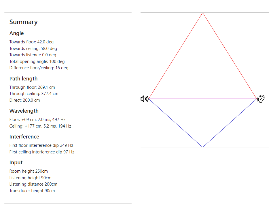

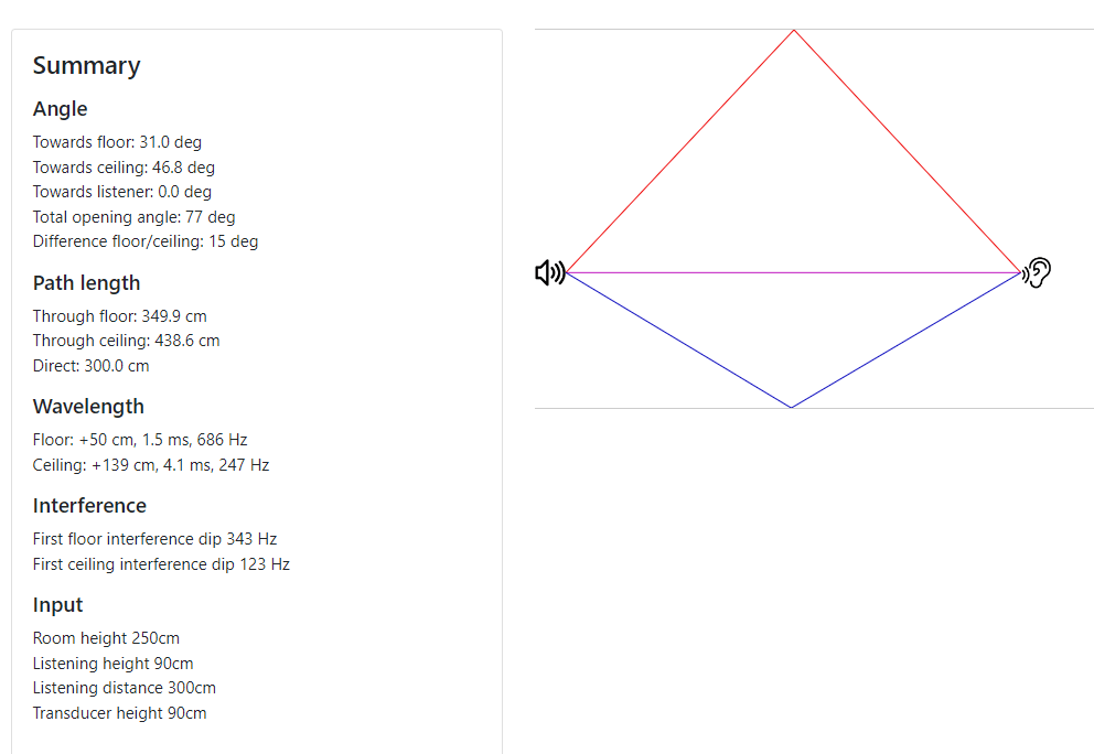

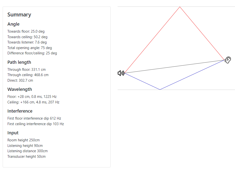

scholl, depends on listening distance. For example both ear and transducer at 90cm (3') height from floor, the floor bounce has only 50cm (~2') longer path length than direct sound when listening distance is 3m (10'). This means dip about ~350Hz. If transducer is closer to floor, or listening distance further out, the path length difference reduces and first interference dip gets even higher. So, yeah your logic sound but numbers need more context and work with some particular listening distance and drift off if listening distance changes.
Floor bounce is a myth in that sense that it is usually the shortest early reflection making anomalies highest in frequency of all six first early reflections in cubicle room. So, if there is suckout on low mids, it's not likely floor bounce but anything else, exactly opposite to what I commonly see on forums.
Any other early reflection easily falls around 300Hz or below, while floor bounce is likely bit higher. Reflection from ceiling could be octave or two lower for example.
Nevertheless, none of these come alone but early reflections in domestic rooms pile up somewhere mids, for example around 300Hz or so making wide huge dip there. Positioning of speakers is crucial in this sense, and optimizing driver height could help, as long as one takes account listening distance and all early reflections, not just the floor.

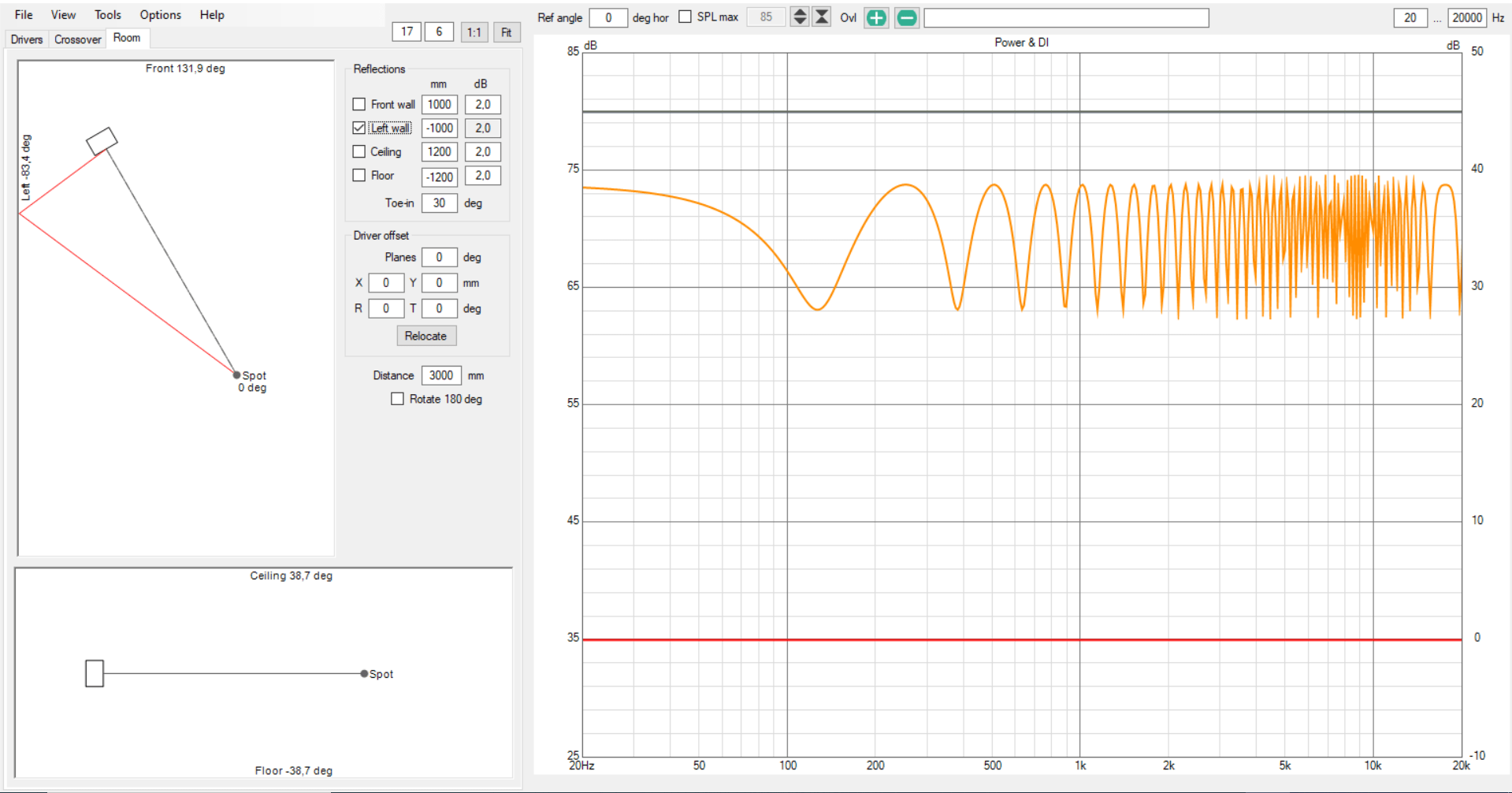

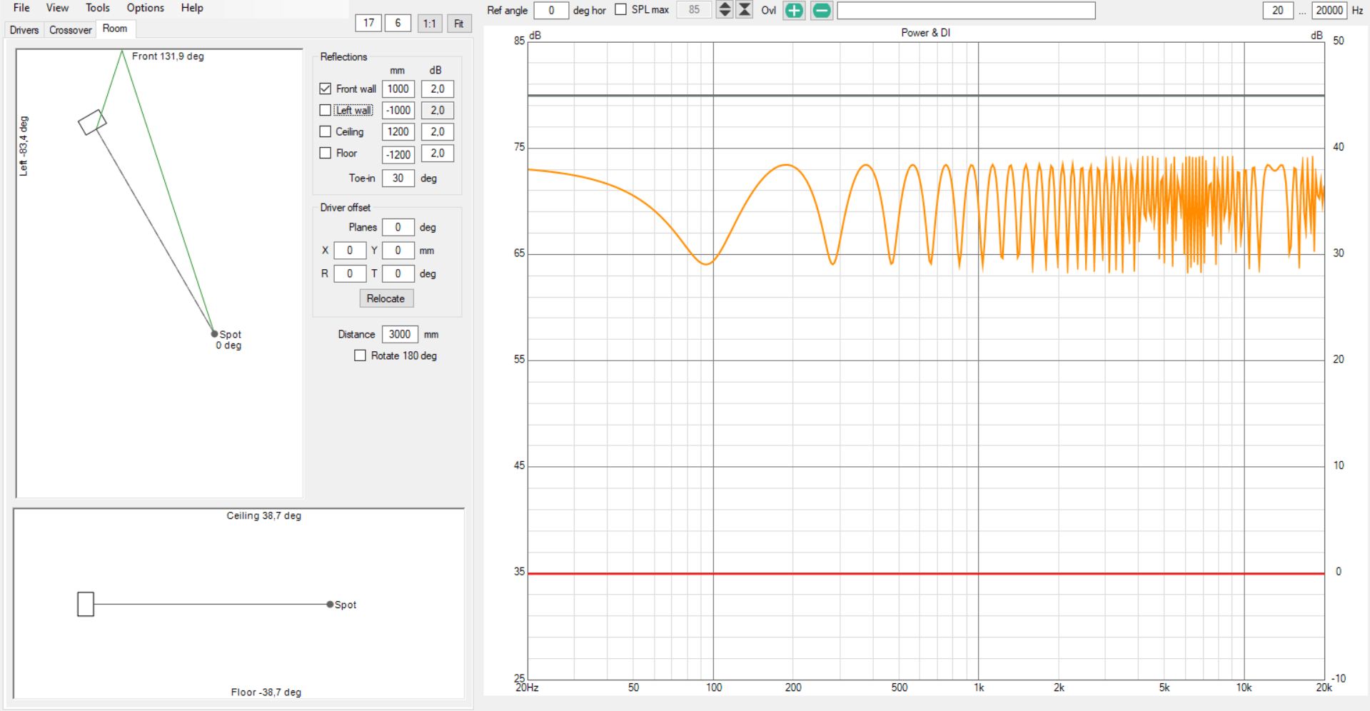

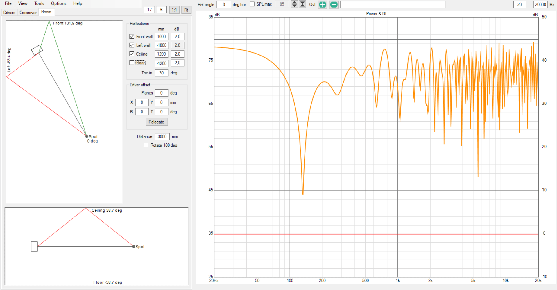

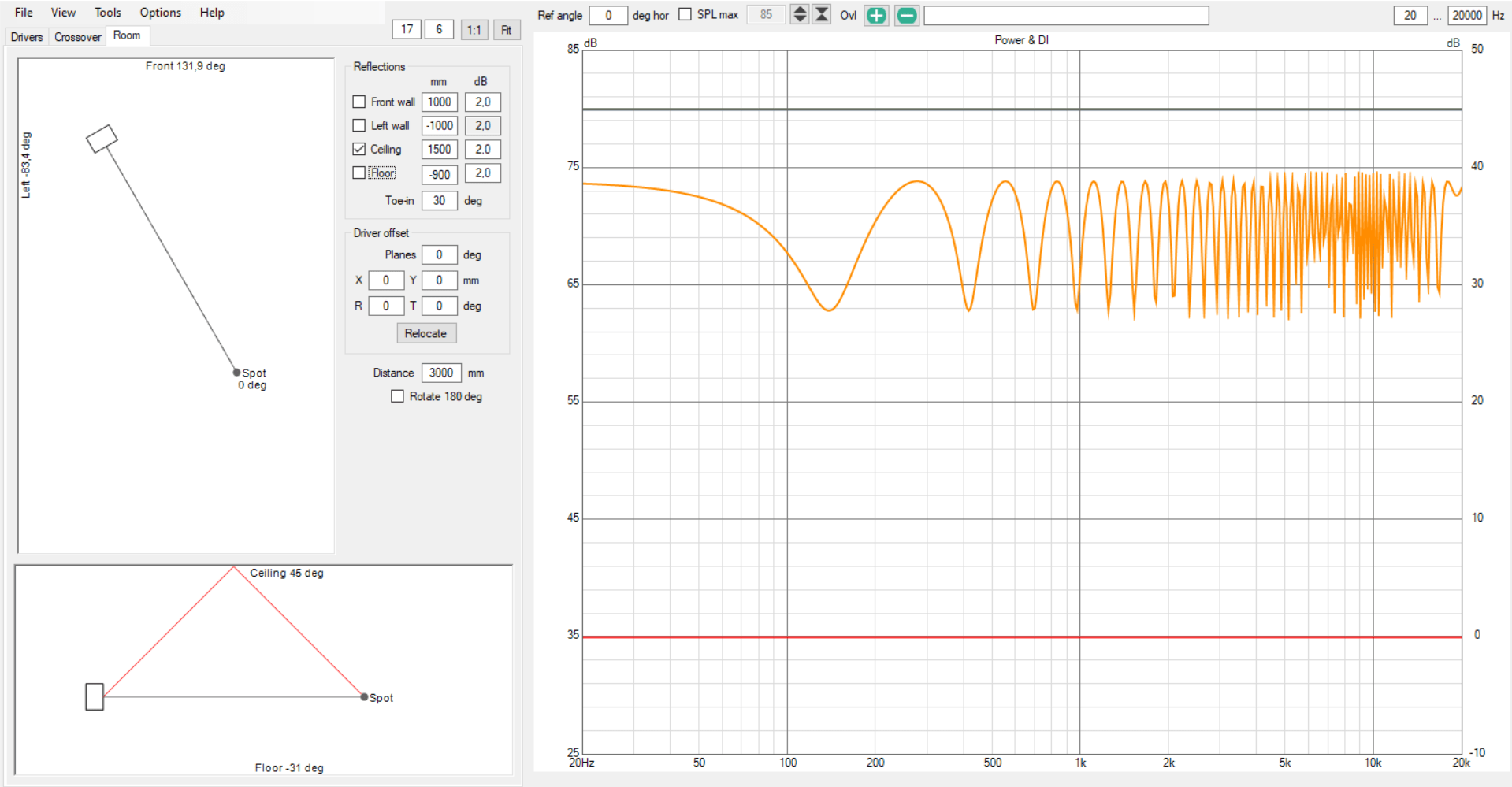

Few attachments, you can play with it here if you wish https://audioexperiment.com/tools/vertical-reflections/

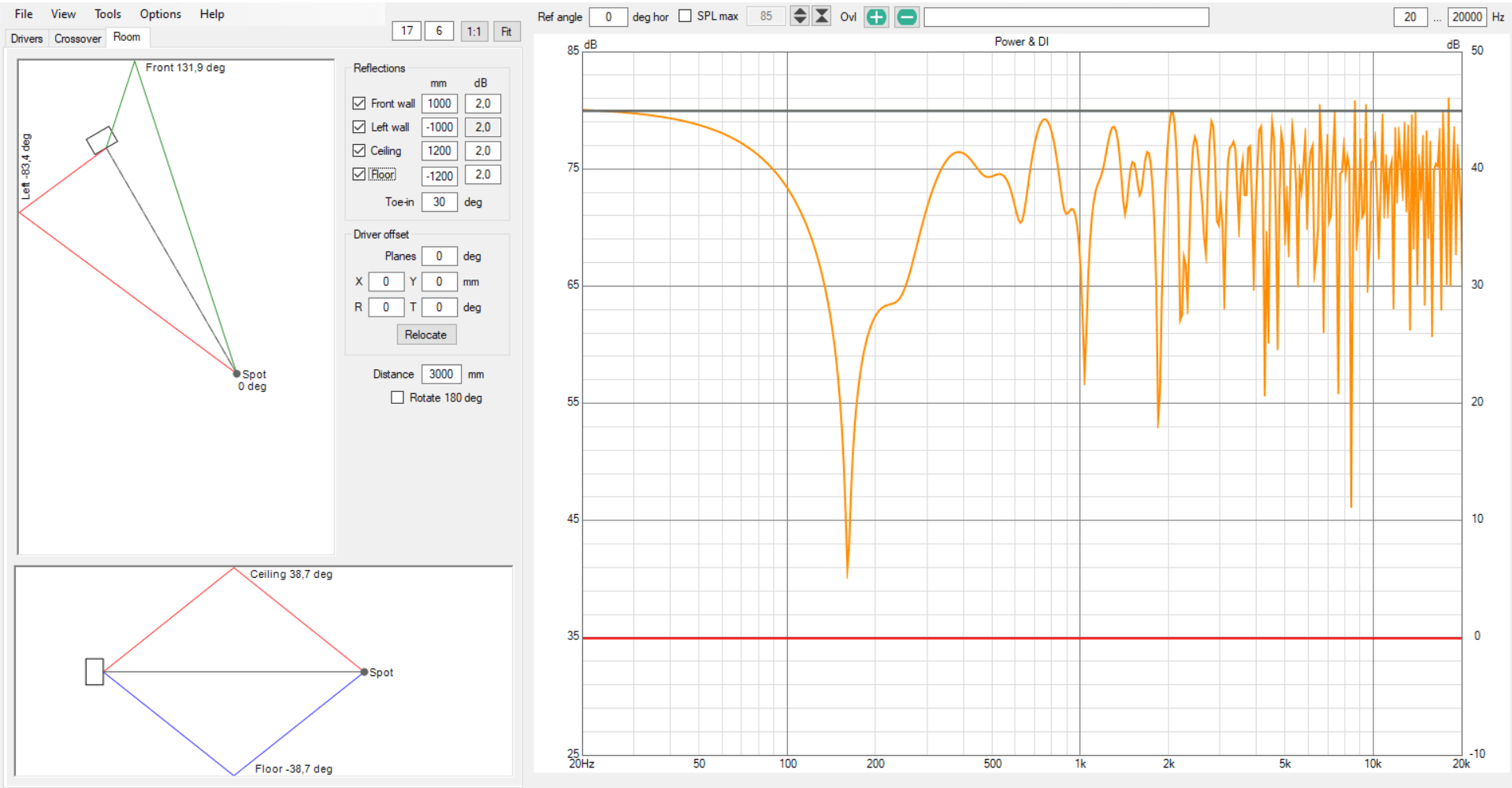

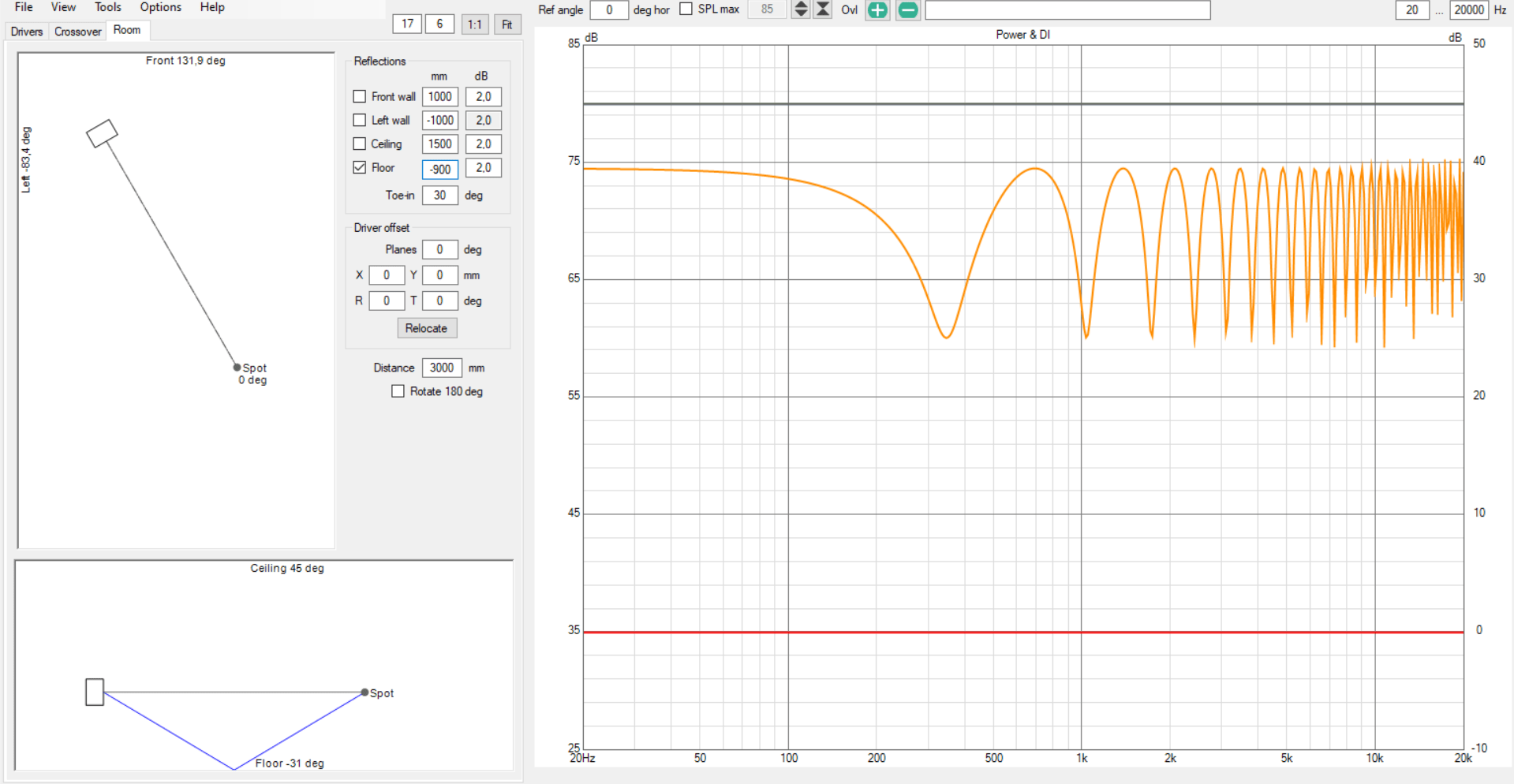

VituixCAD shows this stuff also, on the room tab, more parameters to play and wonder with:
here four of the six enabled, and if I take the floor bounce out almost nothing changes. Singular early reflection is only 1 out of multiple.
