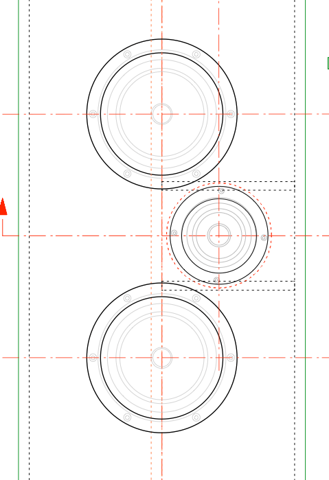

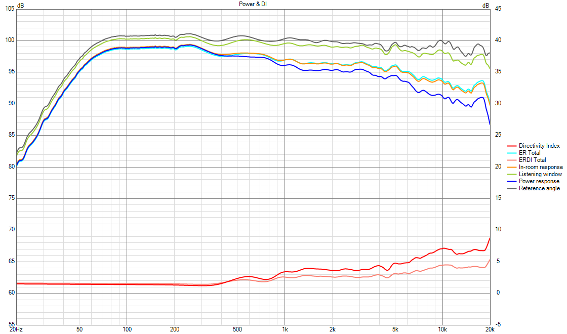

In any speaker system, you want to avoid harmonic distortion above the 40dB (1%) threshold (0.5% ideally) from 100Hz up and a smooth power response / even DI, aka:
This will help make the speaker sound even in room, avoid tonal balance changes / "bumps and dips" as a listener moves off axis and provide a wider sweet spot when listening.
The driver selection and crossover point then comes down to achieving these goals (peak SPL desires aside)
