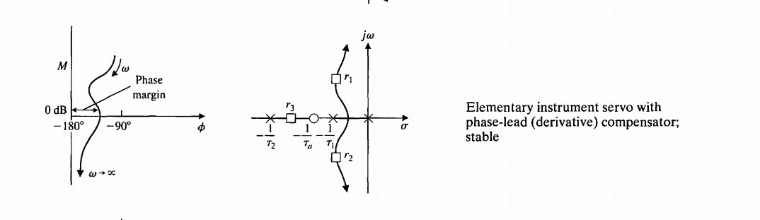

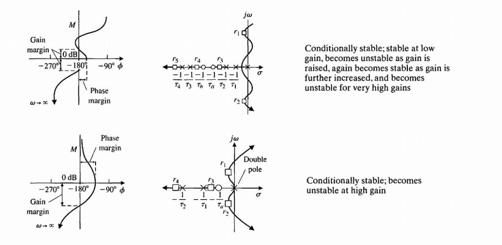

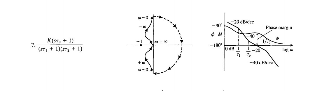

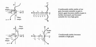

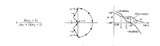

Dominant pole design have no optimisation criteria except bandwidth, so i have attached higher order plots.
Usually poles are defined by component selection - opamps, VAS stage capacitive load(which stabilizes small but deviating OPS input capacitance) or gain/freq ratio of the standalone transistor discrete stages.
There are some design goals for your choice:
1. As low as possible unity gain frequency
2. As low as possible additional components to PCB layout
3. As low as possible additional zeros to conditionally or unconditionally stabilize
4. As high as possible achieved gain at a given ULGF
5. As high as possible gain at a given freq (say 20 kHz for simplicity) with a fixed poles/zeros quantity.
So you will have some order relation with defined and undefined parameters and can easily use any choosed optimization method for choosed optimization criteria.
