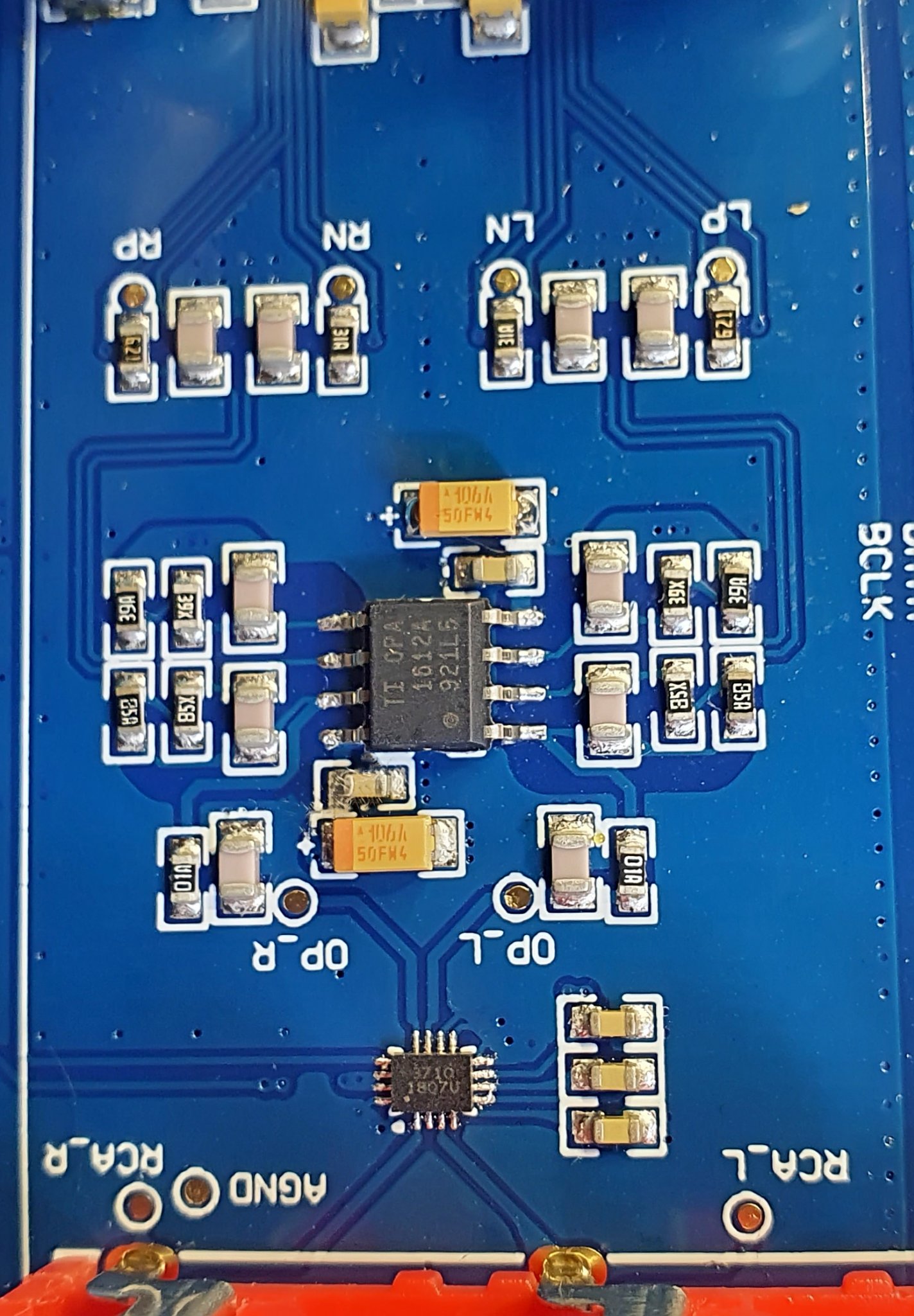

Reviving the thread as I too am looking for help with the same part. My Topping E30 stopped producing sound and I have narrowed down the issue to this chip.
I spent quite a bit of time trying to identify the part, but with no success. This included browsing on Mouser, filtering by function and based on package and checking quite a few datasheets, but none seem to match this chip so far (but equally given the vast number of choices I cannot be sure I have not missed/filtered out something).
What I came up with about the chip so far:
- analog switch, at least 2 channels (unlikely to have more based on pinout...)
- QFN-16 package (wide), 4 pins each side

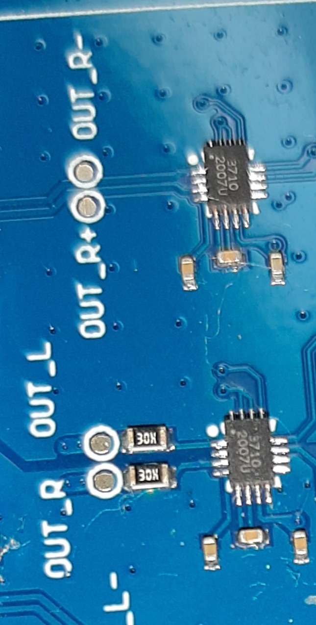

- SMD code 3710 (second row seems to be date code, my chip has 1807U, original poster shows pictures with 2007U, I've seen online pictures with 1707U)
I'm attaching a picture of the relevant area from my DAC.

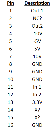

Pinout based on how it's used on E30:

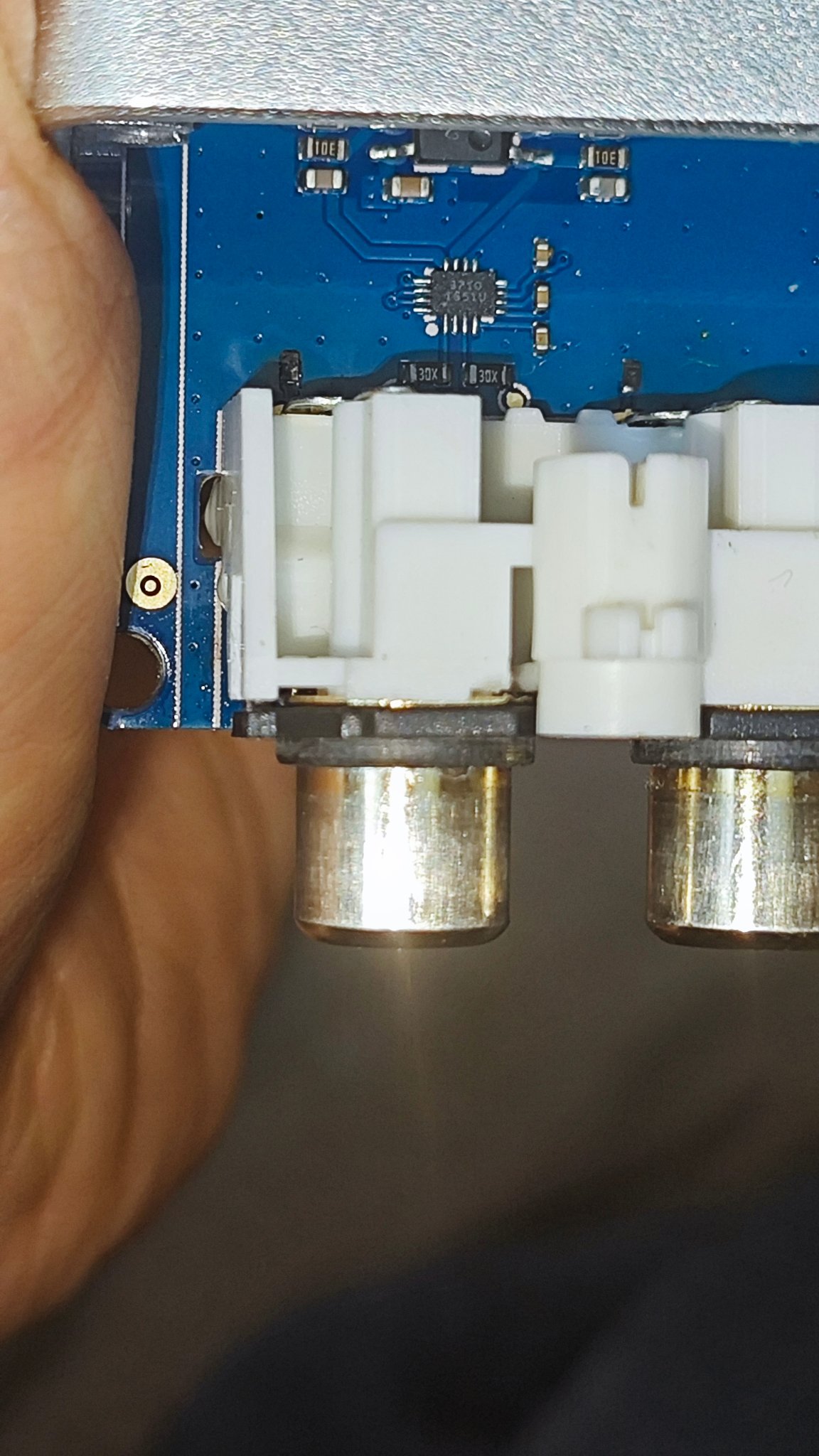

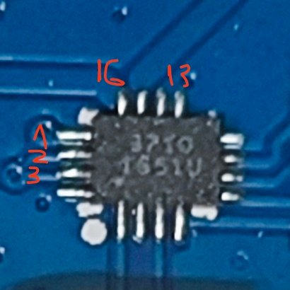

I read 3710 (Q?) and 1807U

Communication/enable line(s) can be only pins 14/15 and potentially 2, given that the rest of the pins have different functions. At second thought, pin 13 could also be enable pin (rather than 3.3V DC in), but not very likely. In any case, most of the pins have been characterized already - normally this should be more than enough to identify the chip from a short list of candidates.Where are the communication line(s) for the chip ?

Indeed, that's exactly what I mentioned in my original post. It is certainly 3710 rather than 371Q, picture attached is not that clear when it comes to this, but having checked the chip under the microscope I'm sure the last character is number 0. Note that 1807U is the date code.I read 3710 (Q?) and 1807U
I'm not sure I get your point... Op-amp does work and I have signal at the output of OPA1612 / before the electronic switch chip. I do not have signal after the muting switch. Hence my earlier comment that the issue is with this unknown QFN-16 switch chip (and not the SOIC-8 OPA1612).TI OPA 1612 is a "SoundPlus™ Audio Operational Amplifier".

If you are sure that it is the mute relay at fault why don't you bypass it and see what happens.
The mute switch is at fault, and this is an established fact since there is signal before the switch IC but not after. Bypassing it will bring signal to the RCA output, no doubt about that. It will however mean that there will be pops and clicks when turning the DAC on/off, when sample rate changes or when signal format is switched between PCM and DSD. Which is not a trade-off I am willing to put up with, hence trying to identify and source the IC so that I can replace the defective one.If you are sure that it is the mute relay at fault why don't you bypass it and see what happens.

OP, is this the correct interpretation of the pinout of my chip?
If so, can I just connect the pin 1 to pin 11 ; pin 3 to pin 12 and call it a day?(given that I don't care about turn on thumps cracks and so on, I'd rather do that than try to solder this tiny chip which I cannot even buy)

Never mind the last picture, apparently the most left on the bottom is the first indicated by the white dot above it. The rest goes counterclockwise around the chip.
Well I connected pin 11 to pin 1 and pin 12 to pin 3 but didn't get an output at RCA, so maybe one of my OPamps is burned?
