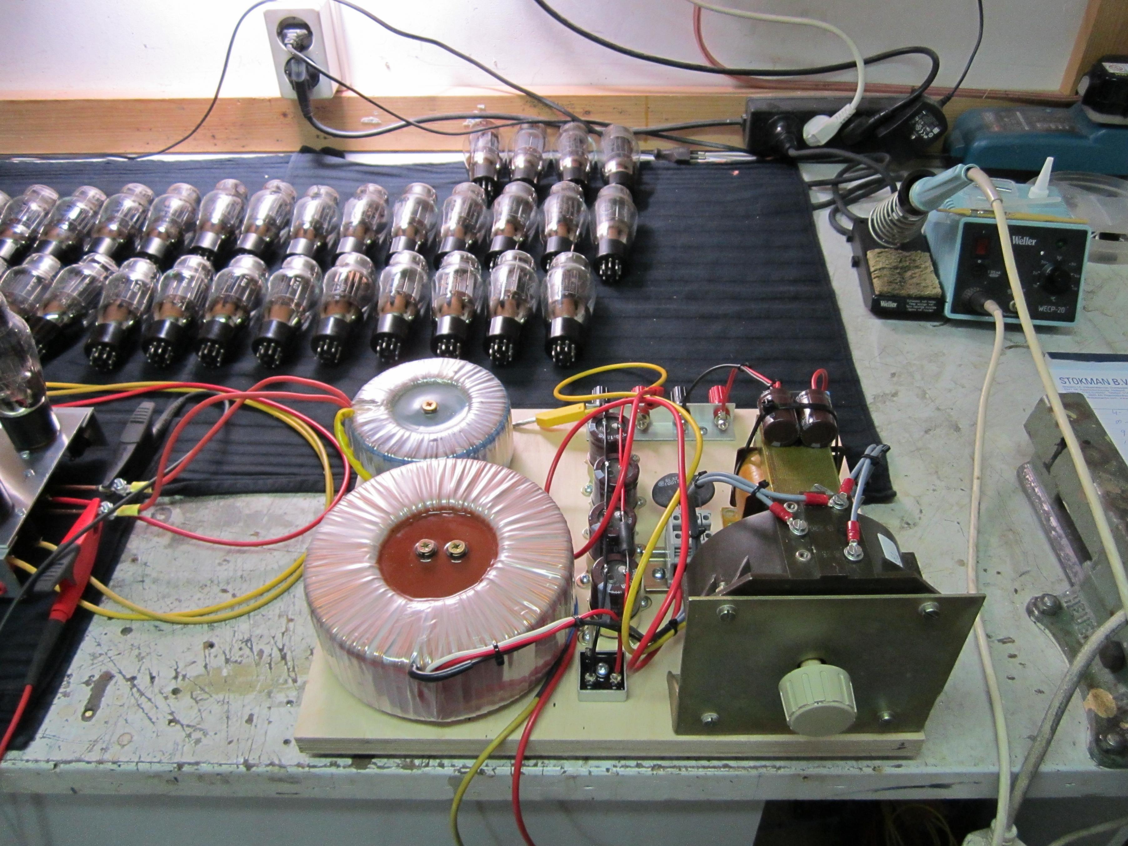

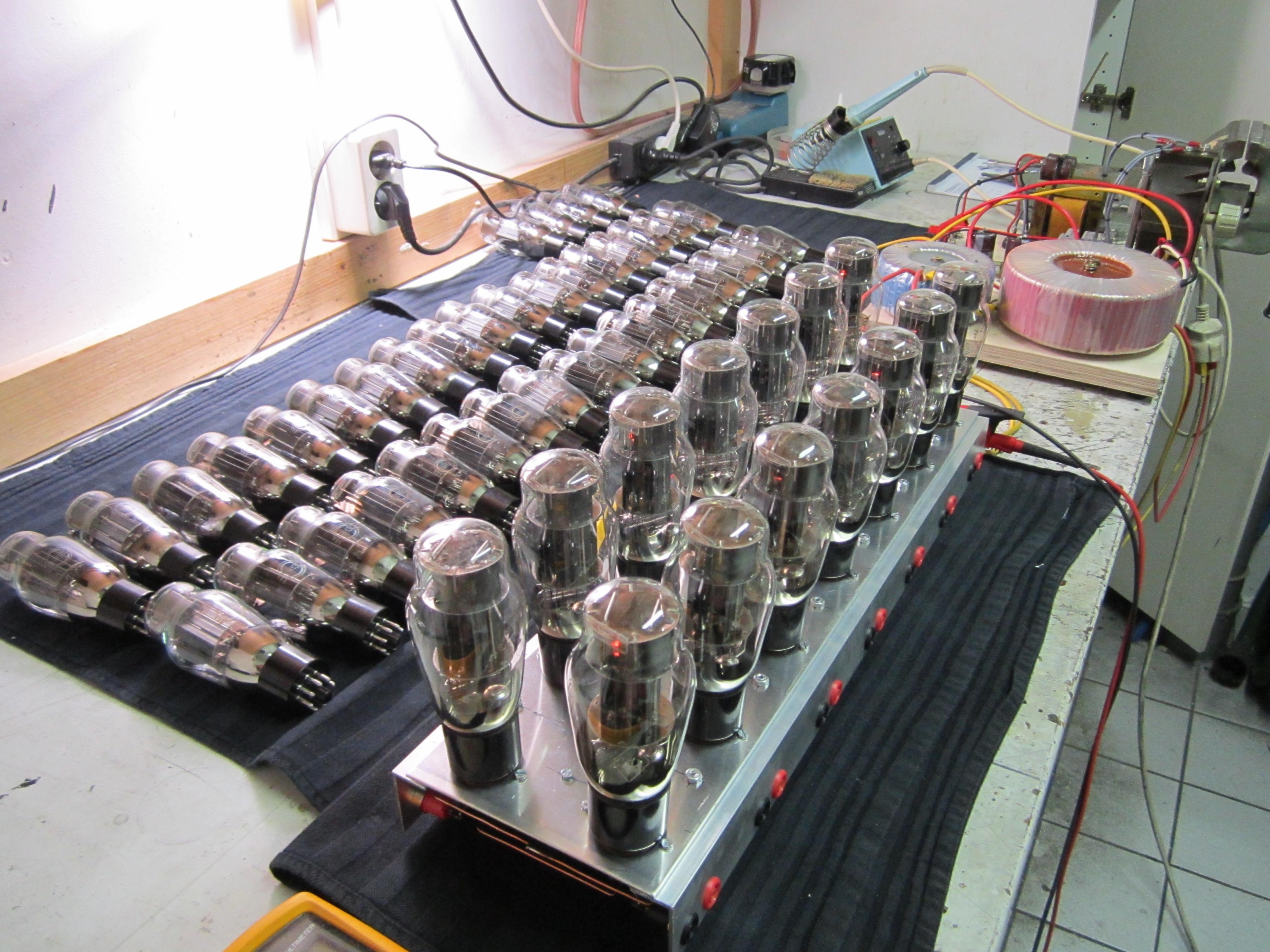

It is certainly a good idea, to heat up the valves for a few days before using them.
I have made a kind of testbench to pre-conditioning them.
I can head 14 tubes at once.

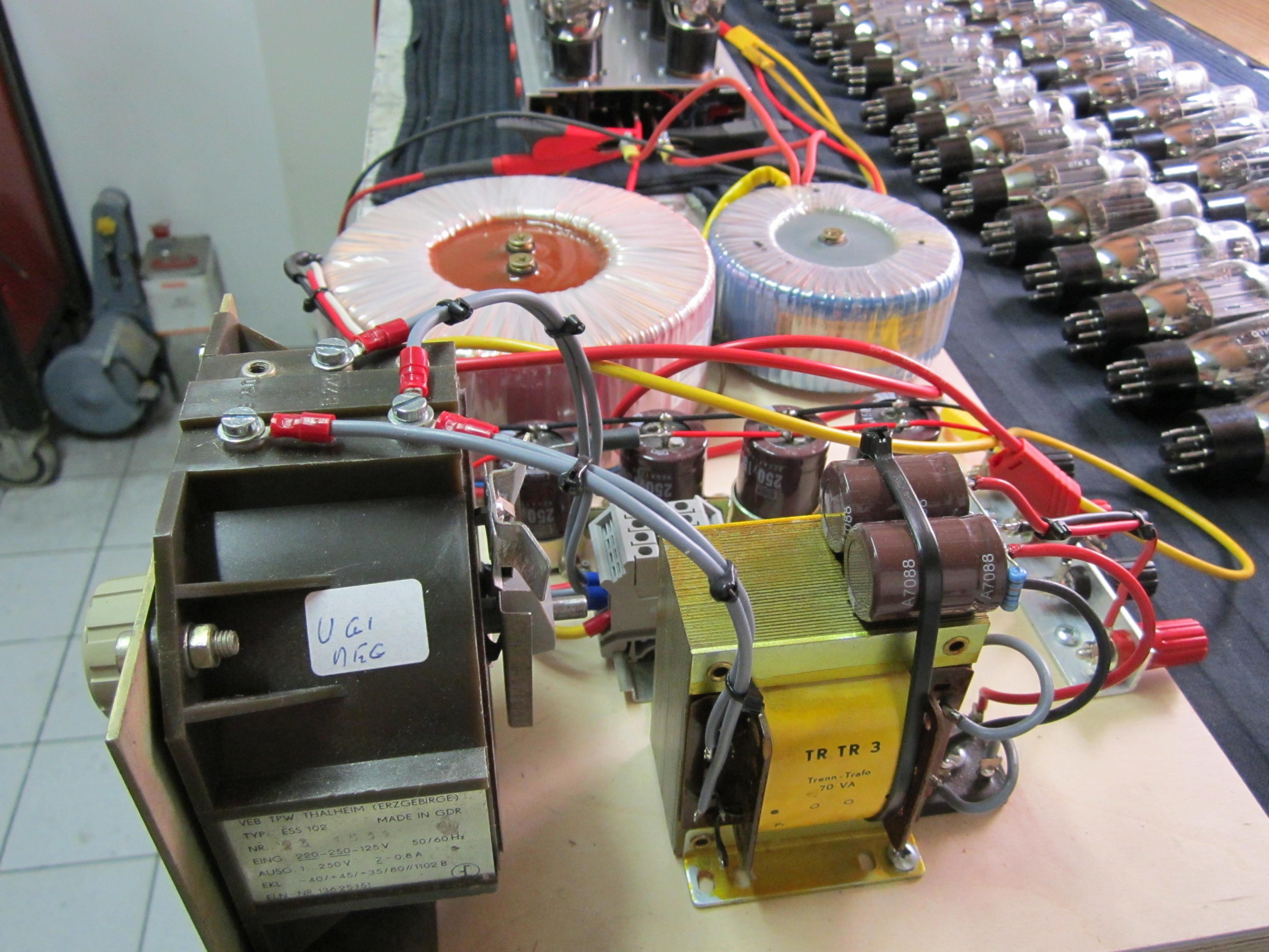

For Dady,
Everything you want to know about pre conditioning the tubes can be found in this thread.
Regarding the testbench, it is actually one phase of the amplifier.
But with fixed HT and a controllable bias.
For each cathode resistor is a measuring sockets installed, to measure each tube half for current.
In this way you can also pair the tubes.
