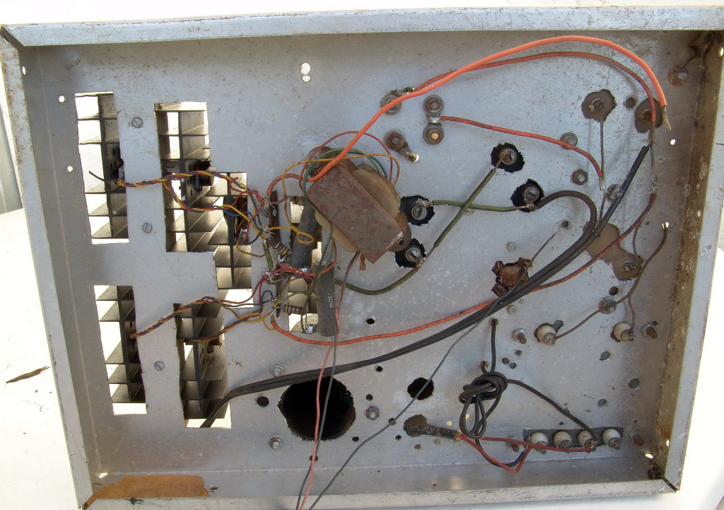

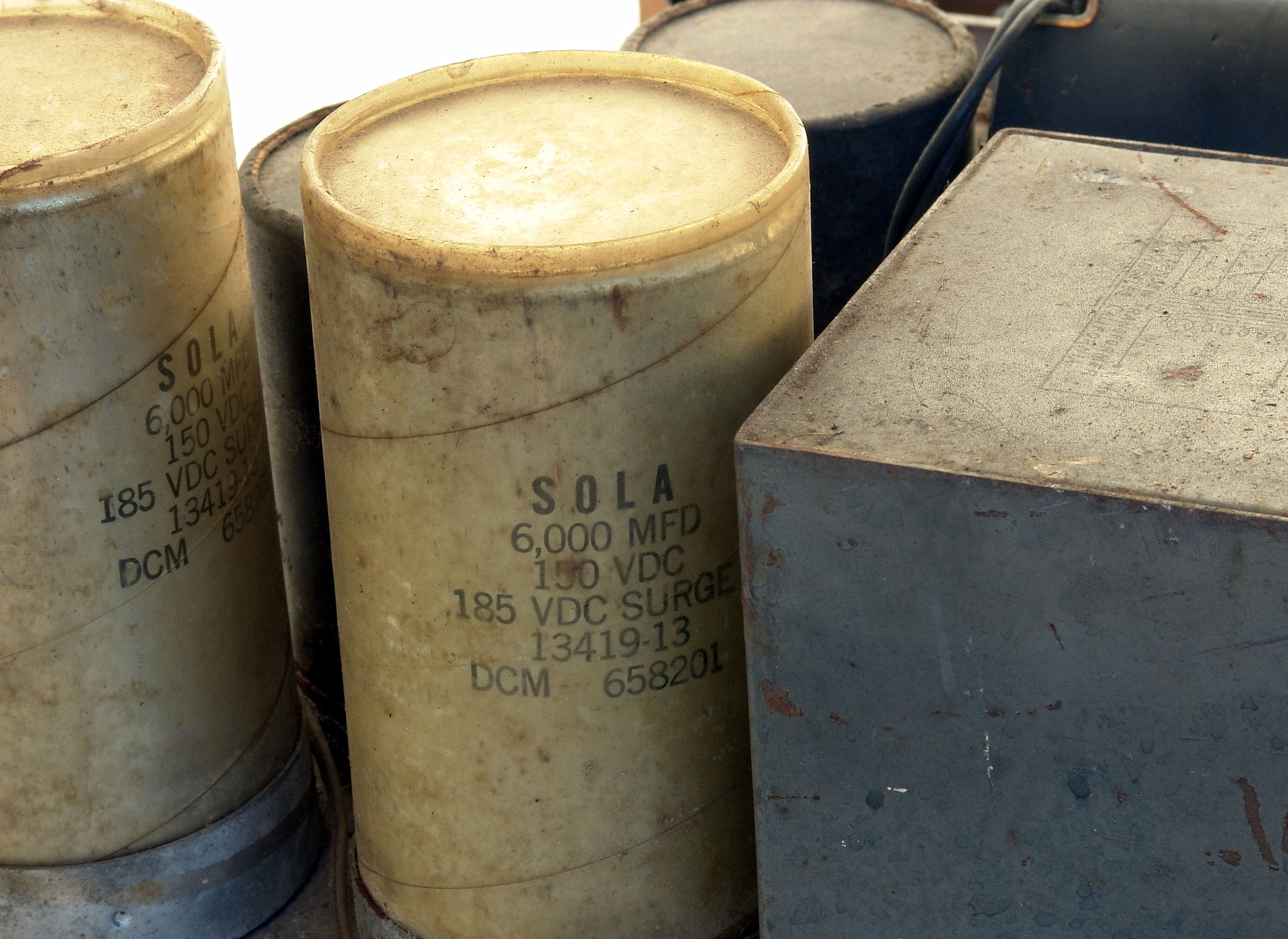

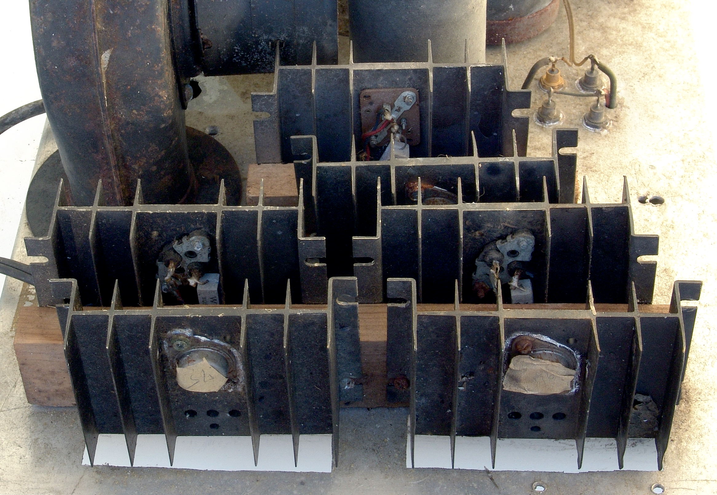

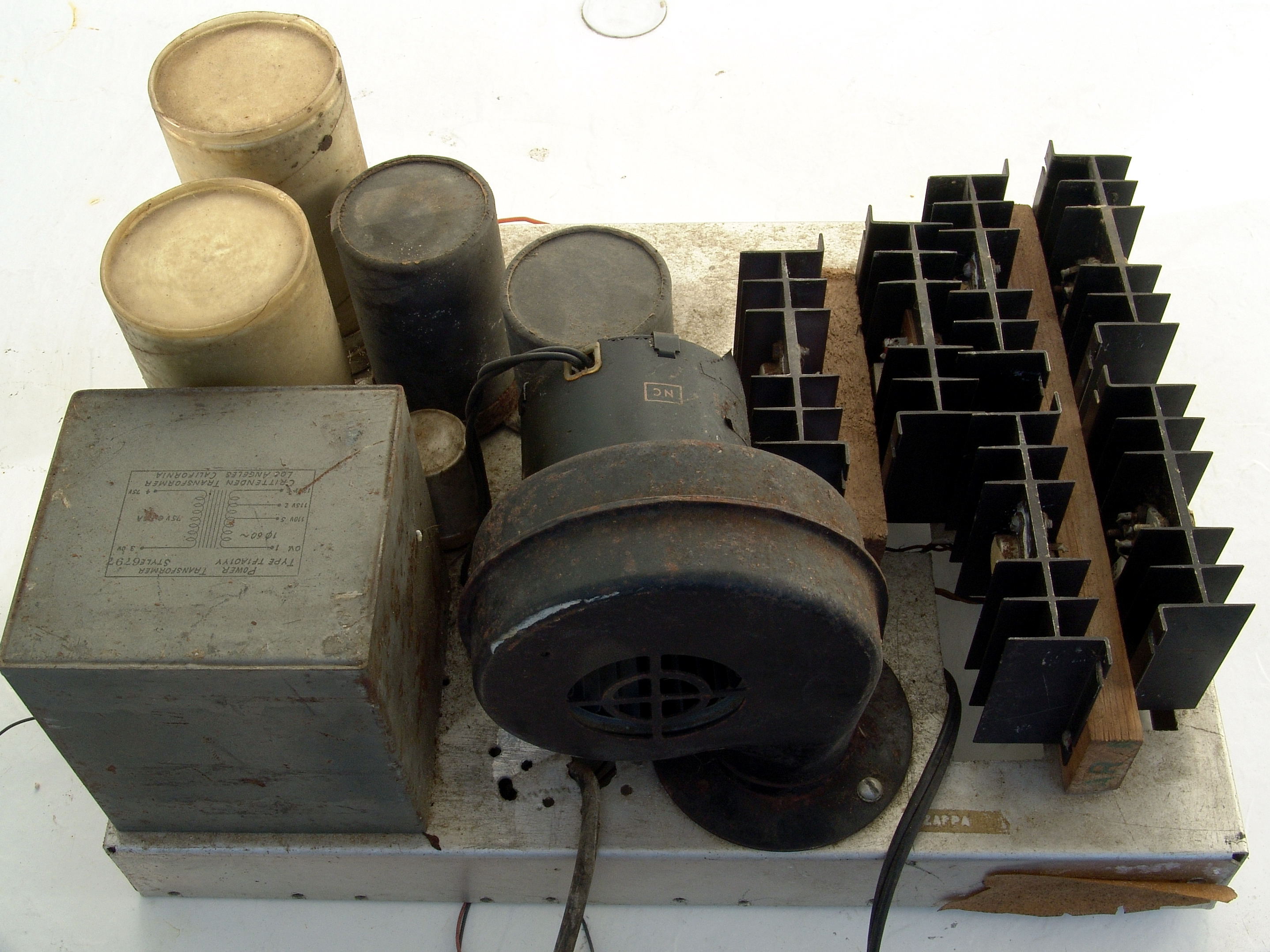

I reused the rectifiers and output caps to make a big solid state amp, that I kept for nearly 40 years. The caps and diodes can be seen in the photos. I was a 17 year old kid when I made this amp. My construction skills are still not so great, but I have better tools. This was made with a hacksaw, a nibbler, and a old drill.
