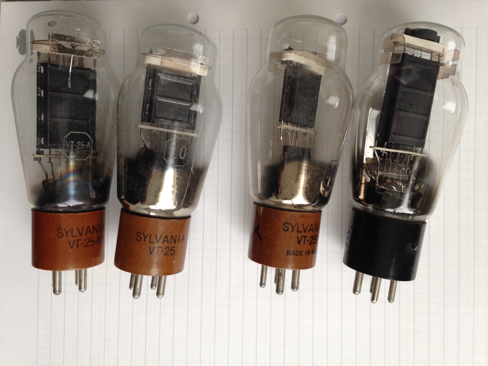

What tube is this? (UX4, Sylvania, long plate)
I have found a DHT, black base marked Sylvania but there is no type on the tube. Wiped out by history.
Any suggestions? What can it be?

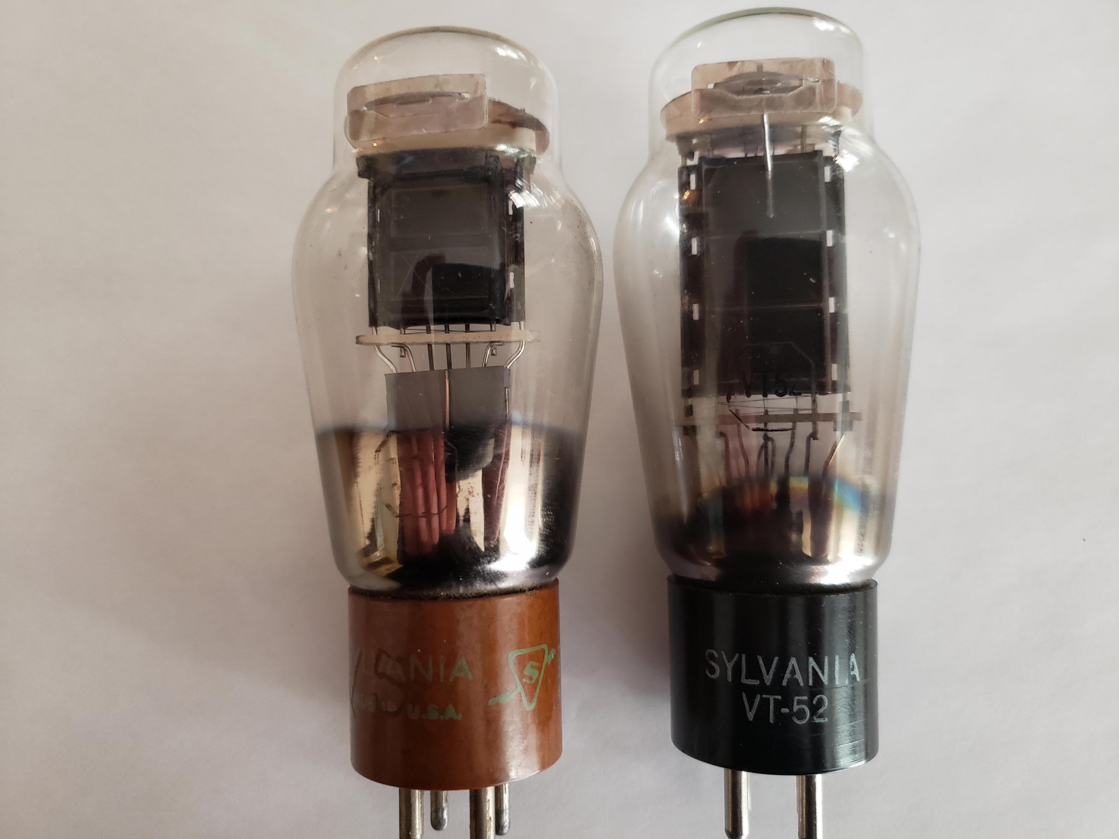

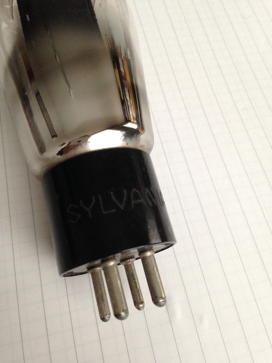

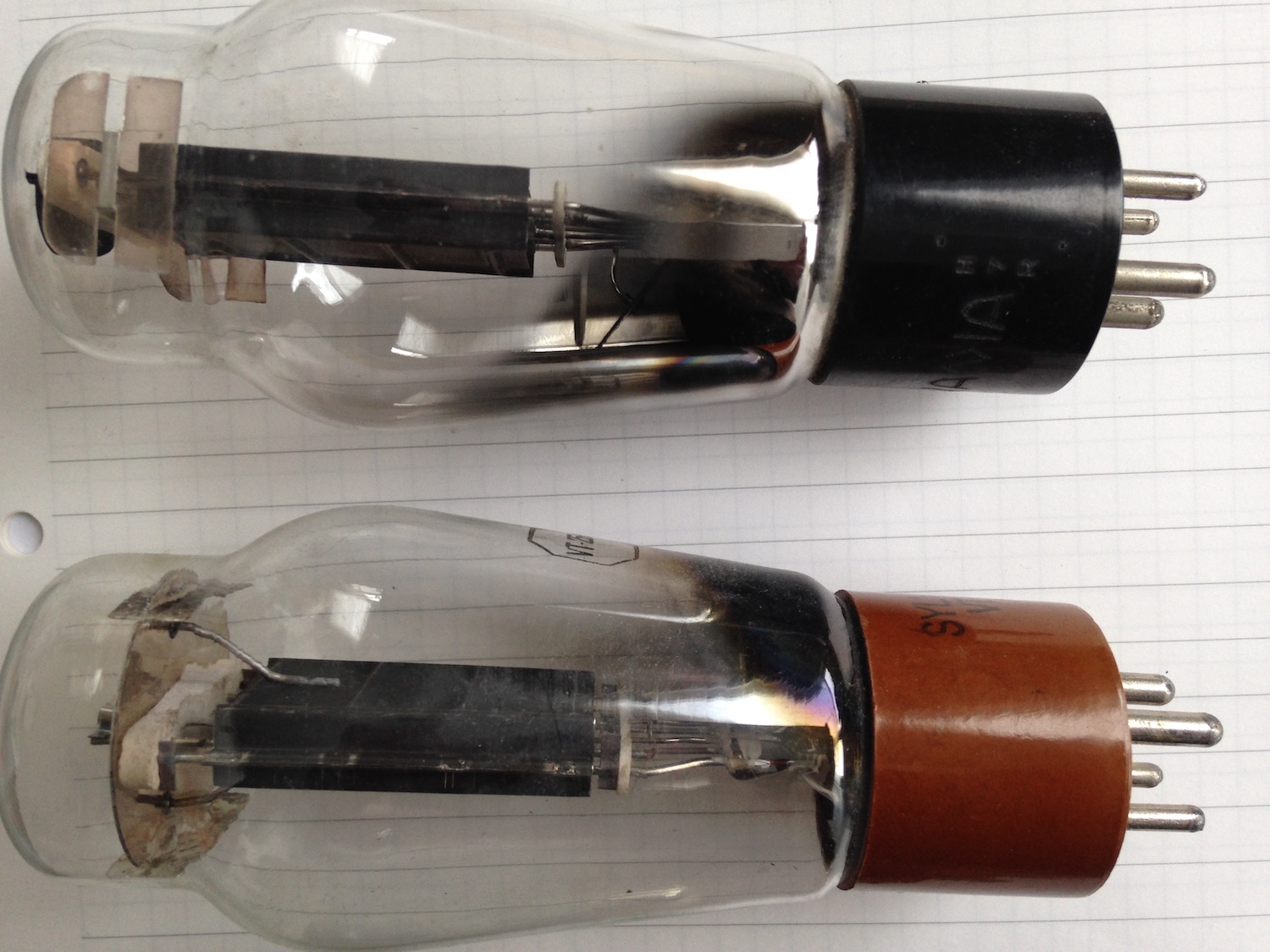

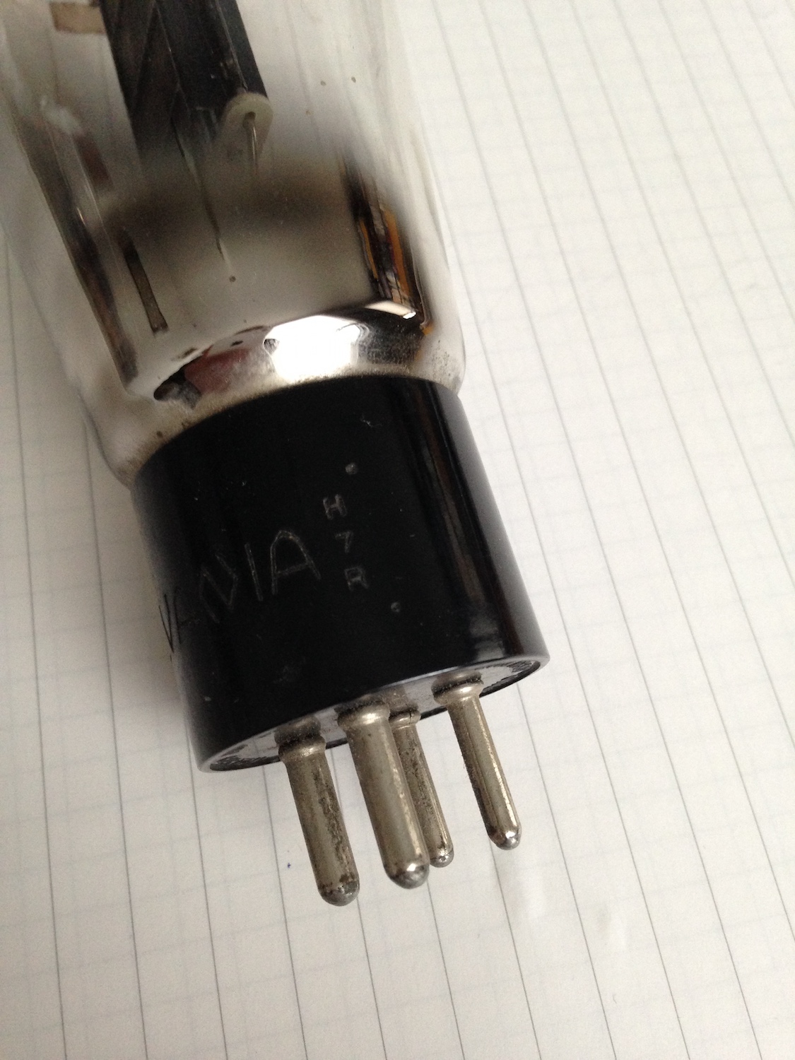

The long plate looks like the VT25/10Y long plate I have, but all my Sylvania long plates have an extra pin to the top mica from the plate. This one does not have that. Also the VT25's all have the mica spacer to the tube on the flat side of the anode. This mystery tube has the spacer on the side, in a different form factor. And the top differs with a short bar to retain the heater side bar for the 10Y and a round structure for the mystery tube. Also, the brand name is stamped in the bakelite base (recessed) and there is a designator H7R next to the logo. The 10/10Y have a modern printed logo on the base.
But more important: the resistance in cold state of the tube differs:
  • the VT25 long plate has 1.8 ohm,
  • the 10 short plate 0.8 ohm,
  • the mystery tube 'wins' at 2.8 ohm.
The VT25 and 10 all have 7.5 Volt heaters.

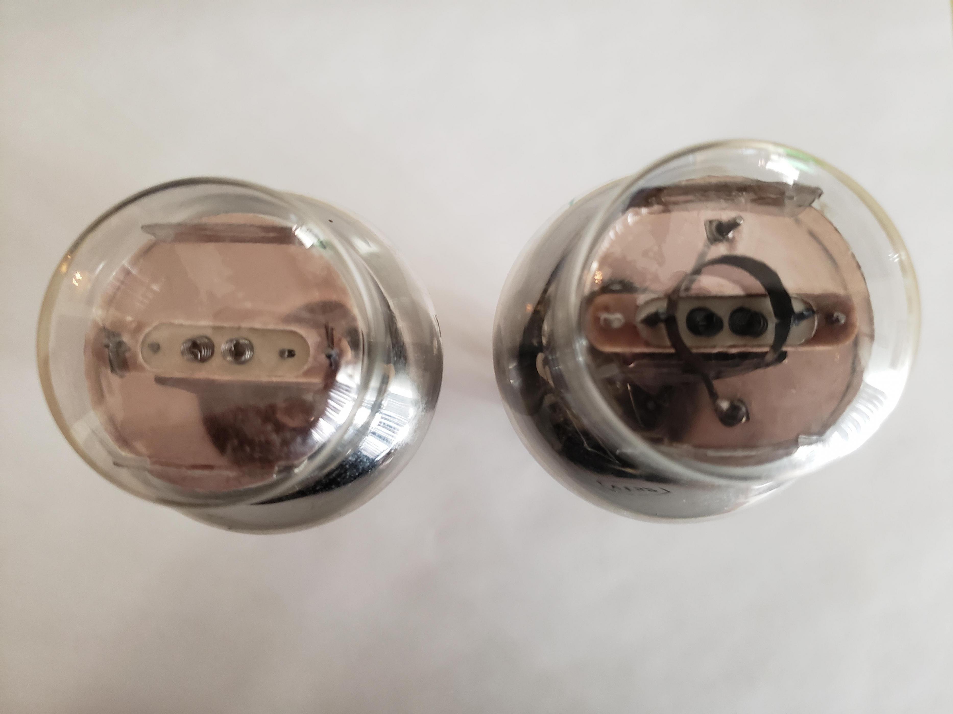

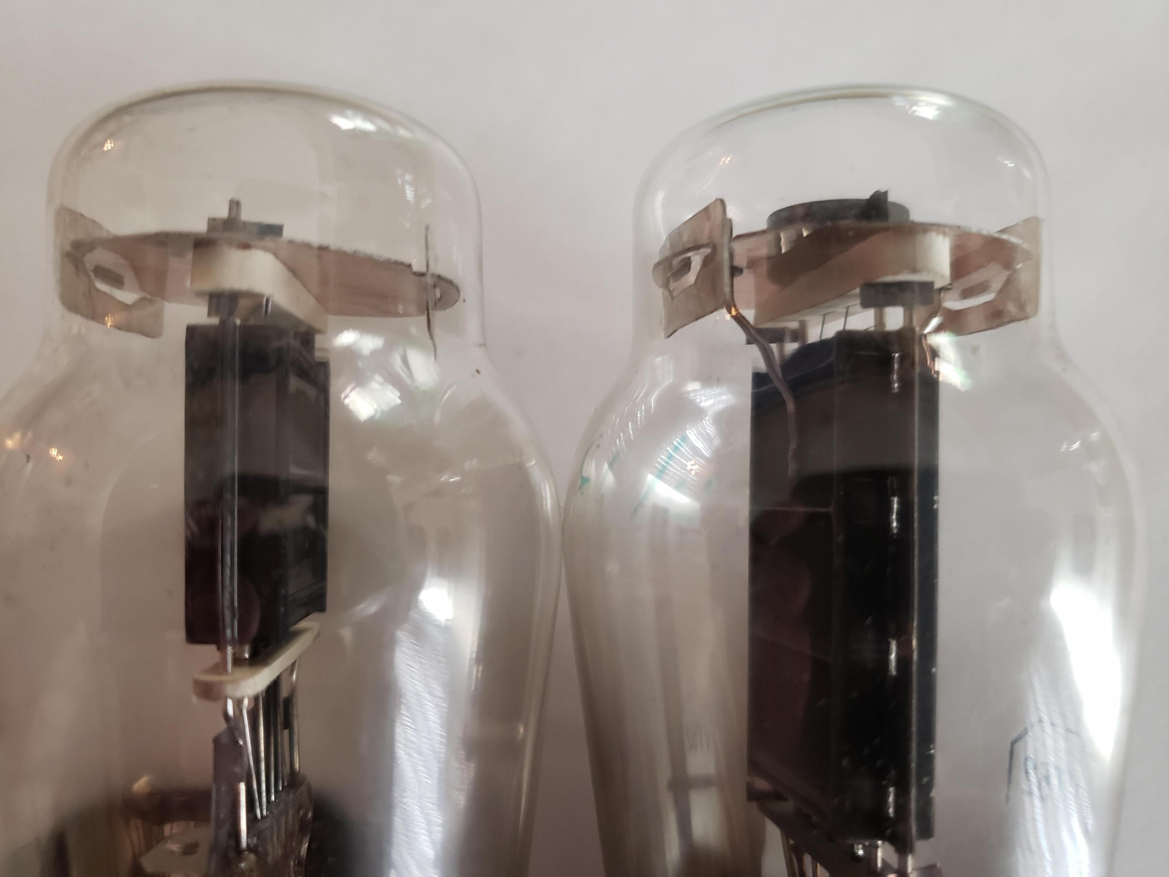

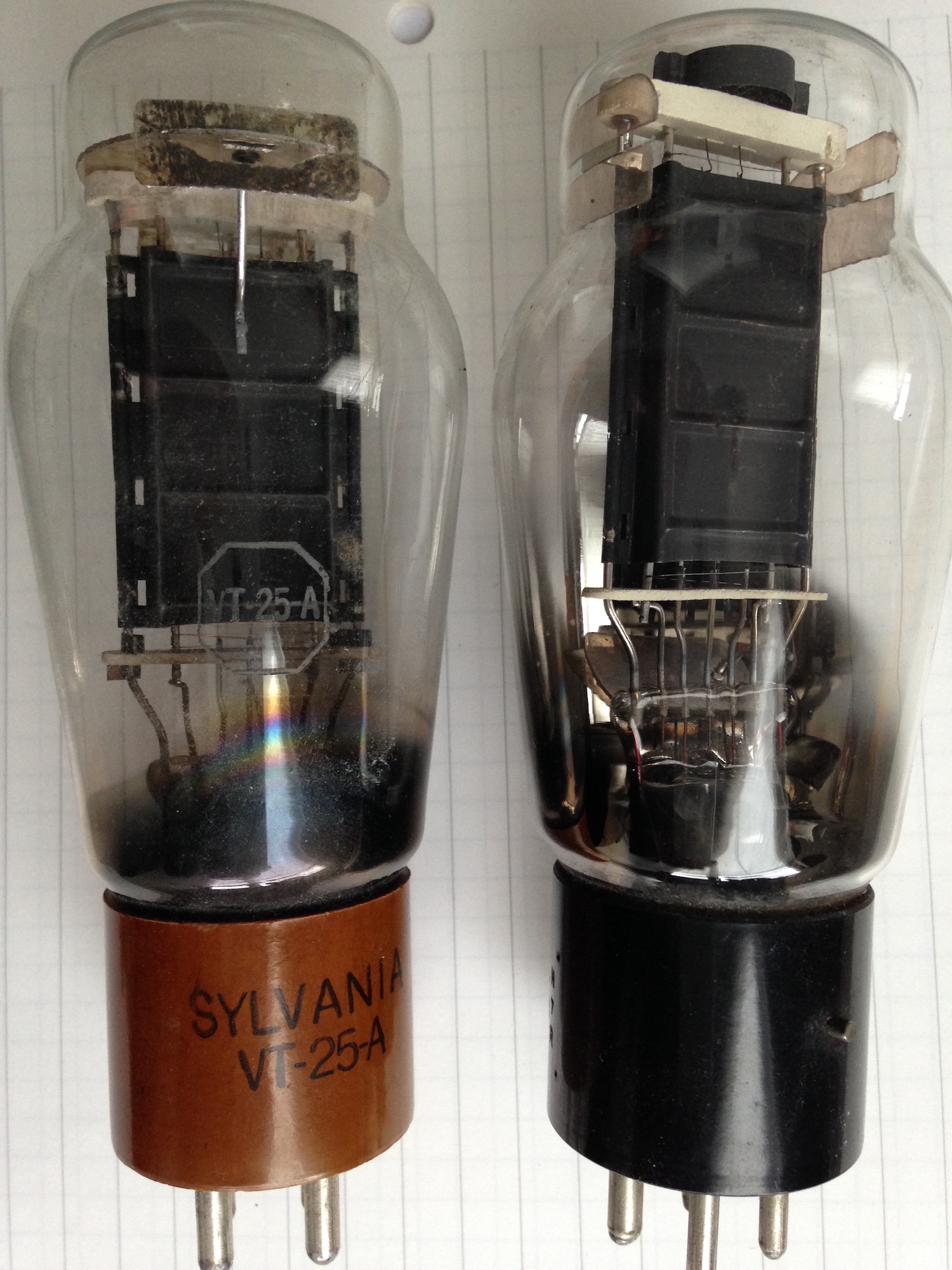

Pictures say it all but will give more questions:
The mystery is the black base tube on the right, compared to a 10Y/VT25
Compared to my other DHT:
The side view:
The top view, showing a round structure around the heater bars on the mystery tube on the right:
I have looked at the VT52 but these all differ a lot (too).
Any help is welcome.

But then, the VT52 here has the same top structure but a round mica without side plates as far as I can see. A close match!

VT52 were originally used in the BC-AL-230 transmitter as modulators. In that application the filament was wired in series with a VT25 filament and the string was supplied from 12-14 Vdc. My personal opinion is that running any of them at 6.3 volts will work fine.
Here are some photos of mine next to a 10Y

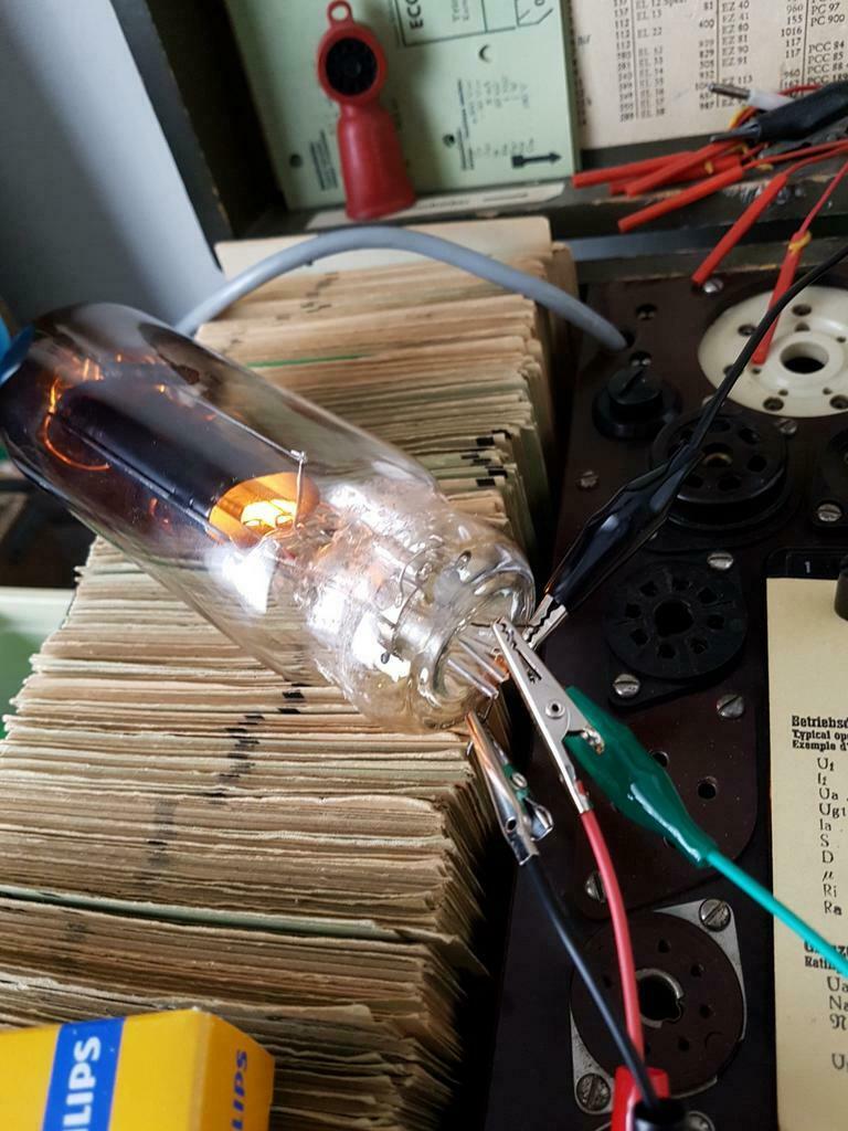

I will put my tube meter ready, (I have one simple ex NATO stock one for in the field) to start at 2.5V and increase in increments.
I am just a bit afraid this could work adverse; maybe should just wire it up and fire it up slowly. What is a recommendation ?

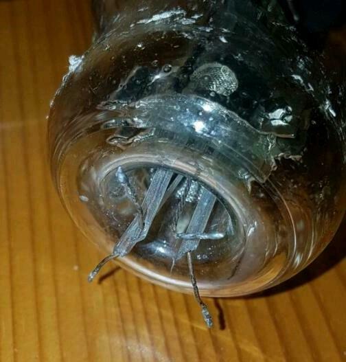

And what does it look like underneath that 1920's socket, that pre-UX4 bayonet?

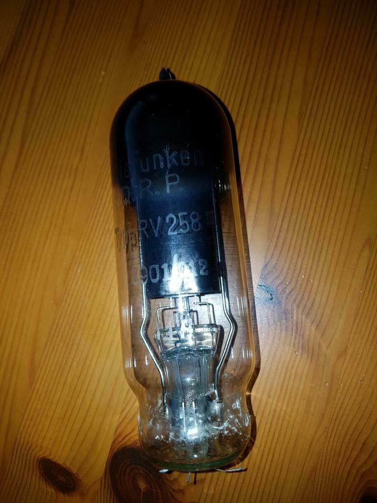

Here with an RV258 this is what some guy did: dissect the tube foot. 😱
And then it is like Humpty Dumpty, nothing could be put together again
This one is for sale in this very bad shape in a Dutch classified site, for $ 65 right now. Taking away the bottom took away 80-90% of the value :scared:
