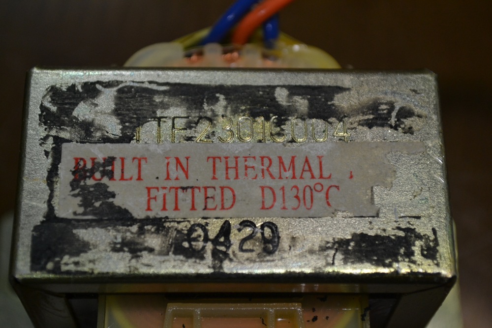

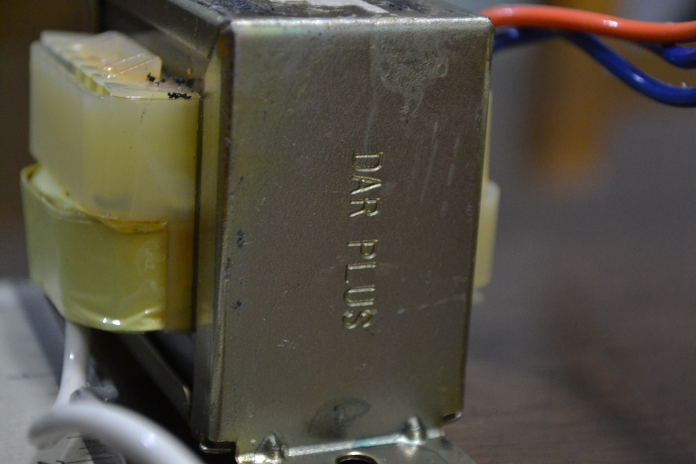

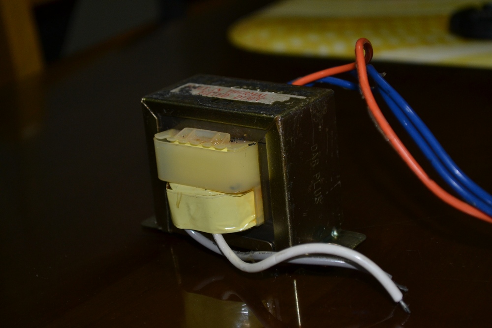

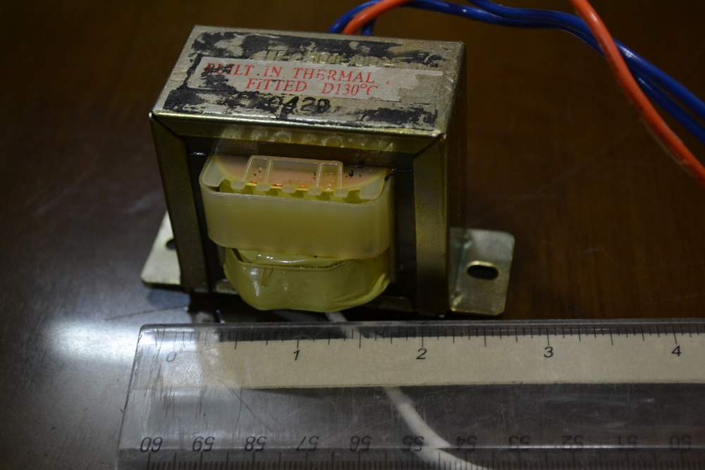

I have a TDK 2.1 speaker system that I use for my PC and it died. I took it apart and found out that the thermal fuse on the transformer blew out.
I am having trouble figuring out the ratings of this transformer. I tested the amp with a small 12-0-12 transformer I have and it works so I think its somewhere in this range.

roughly 20VA for that size....if you bypassed the thermal fuse, you should install a 0.4 amp fuse instead to be able to use that traffo...
make sure that nothing is overheating before you put it back in service...
I bypassed the fuse and hooked it up. I ran it for nearly half an hour and nothing is hot.
I will just get a new fuse.
Thanks!
