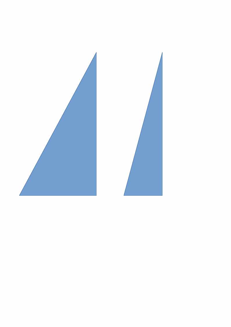

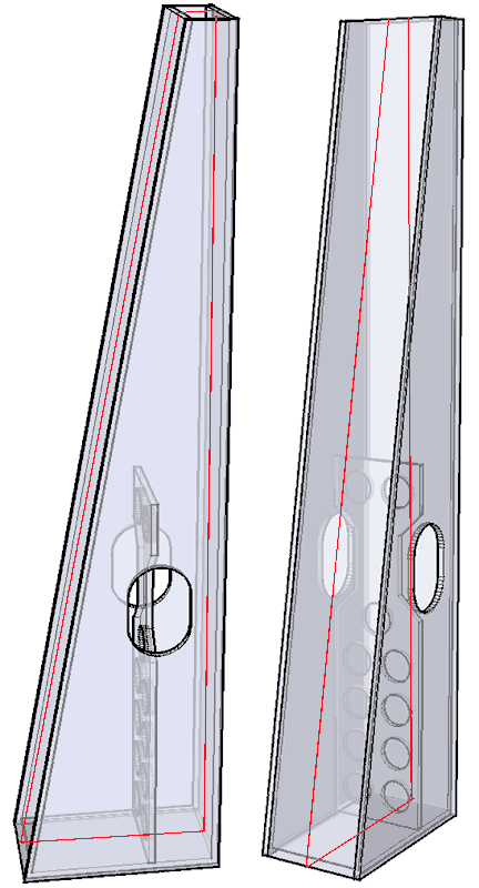

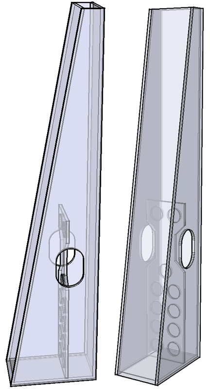

Note that all those lines are the “same” and the triangular one is the only one with a single driver, the others would need to be cut in half.
If you use a holey brace from th woofer to the partition you do not really need the brute force double baffle.
I like the triangiualr one personally, i irst drew that up in the clate 70s for the B200 (a by guess TL, these are modeled). The tall one was the first from the model, the rectangular one was done for a fellow in NZ.

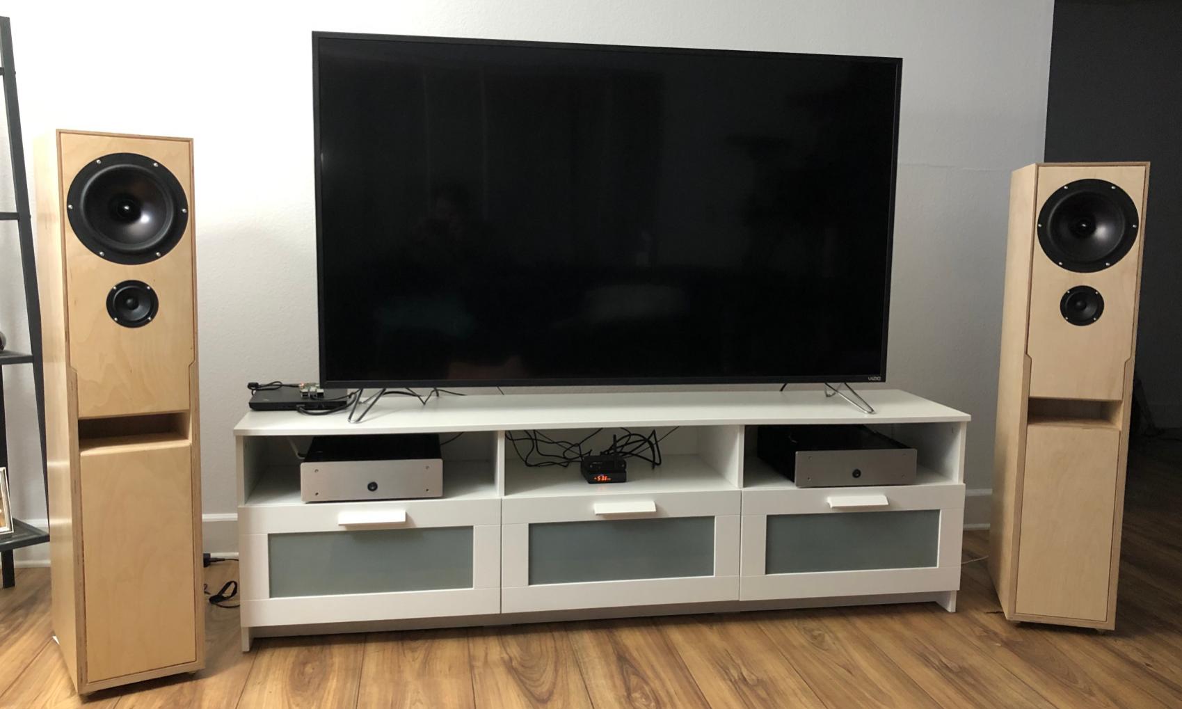

I have a choice of BabyTLs to choose as a satellite - using either the Pluvia 7, Alpair 6.2 or CHN70? Which would you advise would best work with the B139 in the triangular enclosure?
I'll build the satellites first and leave them as 'bare' wood to listen to in the workshop while I work on the other (and the Leak Sandwich recap etc.) I'm enthusiastically looking forward to hearing these satellites (having never heard a FR before) and getting the KEF unit to sound as it ought.

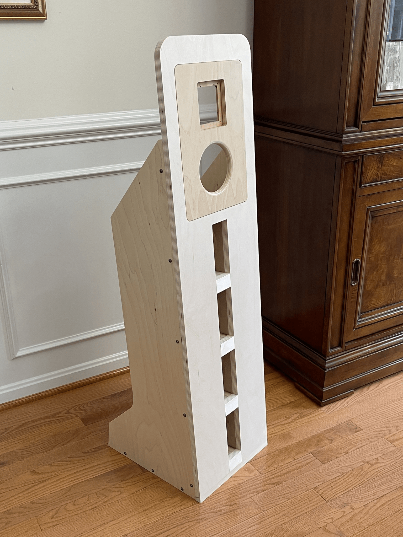

My better half has now intervened and stated her preferences for the B139 TL cabinet. She's not so keen on @planet10 s triangular cabinet (which is a pity because I like the elegance of the triangles within it) - rather she's keener on these, in contravention of all known laws of partner household toleration:
She likes the shapes and loathes boxes. To be fair she has a point - we're limited on floor space but have high ceilings. However she wishes to lacquer them in cheery colours to stand out - a combination of dark red and yellow.

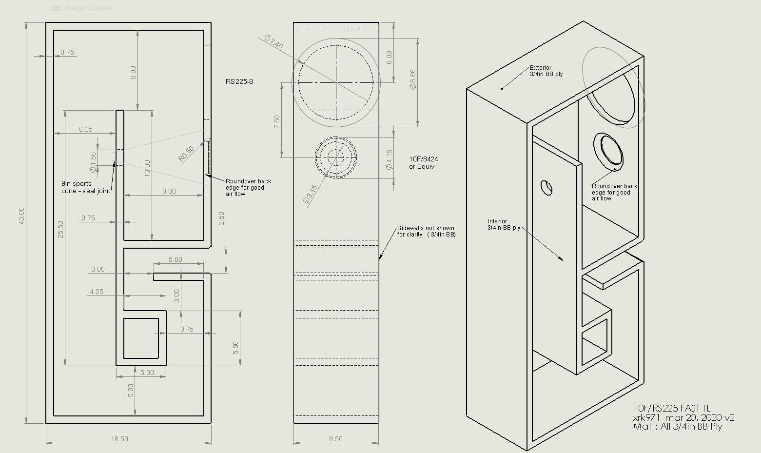

You could also cut it in half. You won’t get the gains of push-push, but the depth will be half for less floor space
Do you mean literally halving the depth (so bringing the back panel forward) or halving the volume? Or are they both the same? My sense of spatial arithmetic is a tad non-existent.
@xrk971 many thanks for your kind offer but please not to spend any time. From my wifes POV it's still a box - she objects to the Celestion Ditton 25s currently in the living room on that basis - and the fact they're blandly veneered in teak.
Halving the depth, which does halve the volume, but also maintains the geometry. Imagine th evisulalization as 2 B139 traingular TLs (mirroe imaged) back to back (with the 2 unneeded backs magically going poof). That is how i designed it (from the numbers Scott derived).
dave
Just to crowbar this into my non-mathematical cranium - from the left image to the rhs - but preserving the area of the 'mouth'? I'd rather source another pair of B139s though... and I'm still tempted by the triangular design so if a third pair should turn up :)
