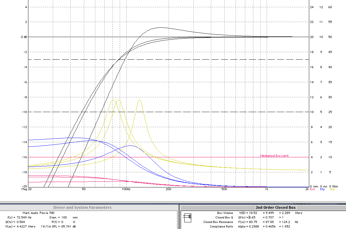

a sealed box at .707
Say 8.5 litres or so stuffed.

It's not hard to make a sealed box too small but harder to make one too big. Vifa P-13 can work in a half litre as a midrange but I put mine in 5 to 8 litre boxes. I doubt may would hear the difference between an 8 litre box and a 10 litre box and I'm of the opinion that all small sealed boxes should be stuffed.

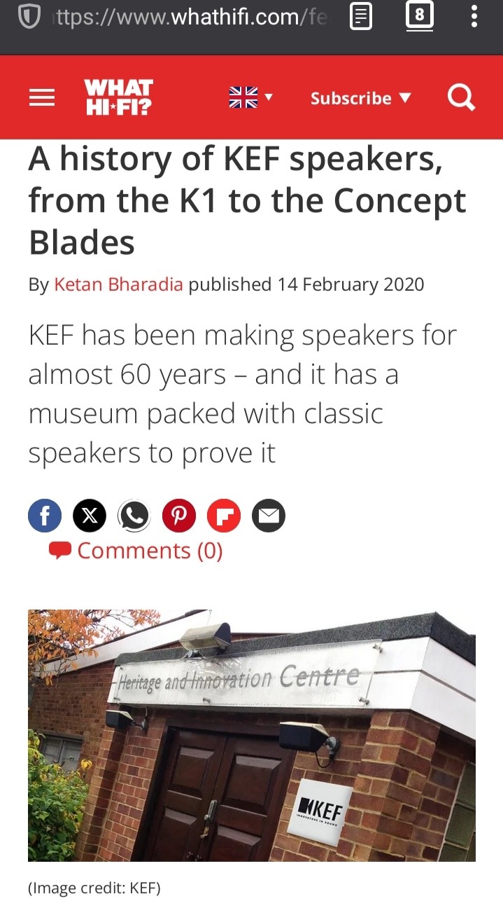

Kef began to use in their first speakers alu foam alu sandwich.
https://www.whathifi.com/features/a-history-of-kef-speakers-from-the-k1-to-the-concept-blades
