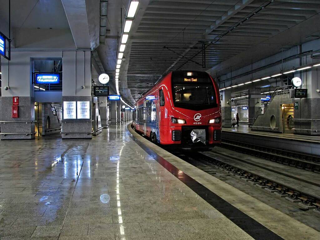

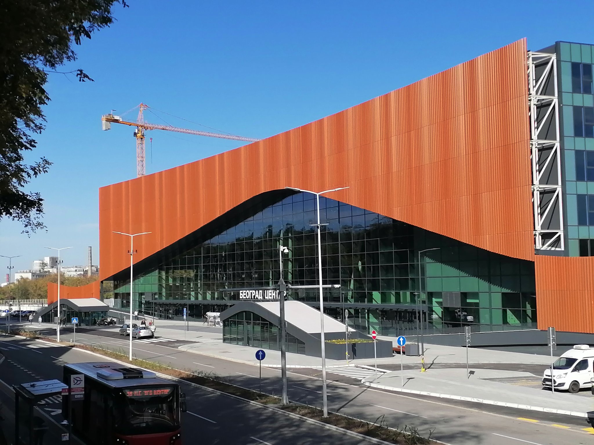

If you ever come, feel free to contact me. Nothing here is the same as before. Something is better, something is worse than before. Let's say the number of vehicles is 10x higher. The old train station was removed mostly (80%) to build modern RoboCap style buildings (Belgrade Waterfront), the main building remains and will be restored as a museum or whatever. The new train station is also RoboCap style.

Yes... it's changed! Is that the Mestrovic statue on the skyline?
