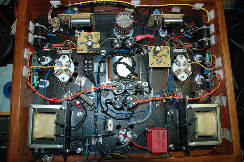

I did a two stages SE amplifier using a C3g (triode connected) and a 211 or TM100 or MC1/60 or RS237 power triode (I have the 4 options).... and I am really happy with it.
The C3g can deliver 60 V peak signal on the grid of the "big" triode with 2 V at the input (my CD and RIAA stage can deliver more than 2V) at quite low impedance (about 2500 ohms).
Here is a little view of the amplifier...
The amplifier is built in 3 parts, two mono blocs for the power triodes and one stereo input stage (here with the C3g)
I did made a lot of tests as input stages, EC86, E81L, ECC35 + VT52, 6SL7 + 6A3 (or 6B4G)... le C3g is the one I prefer.
I will try a E80L as pentode.
André

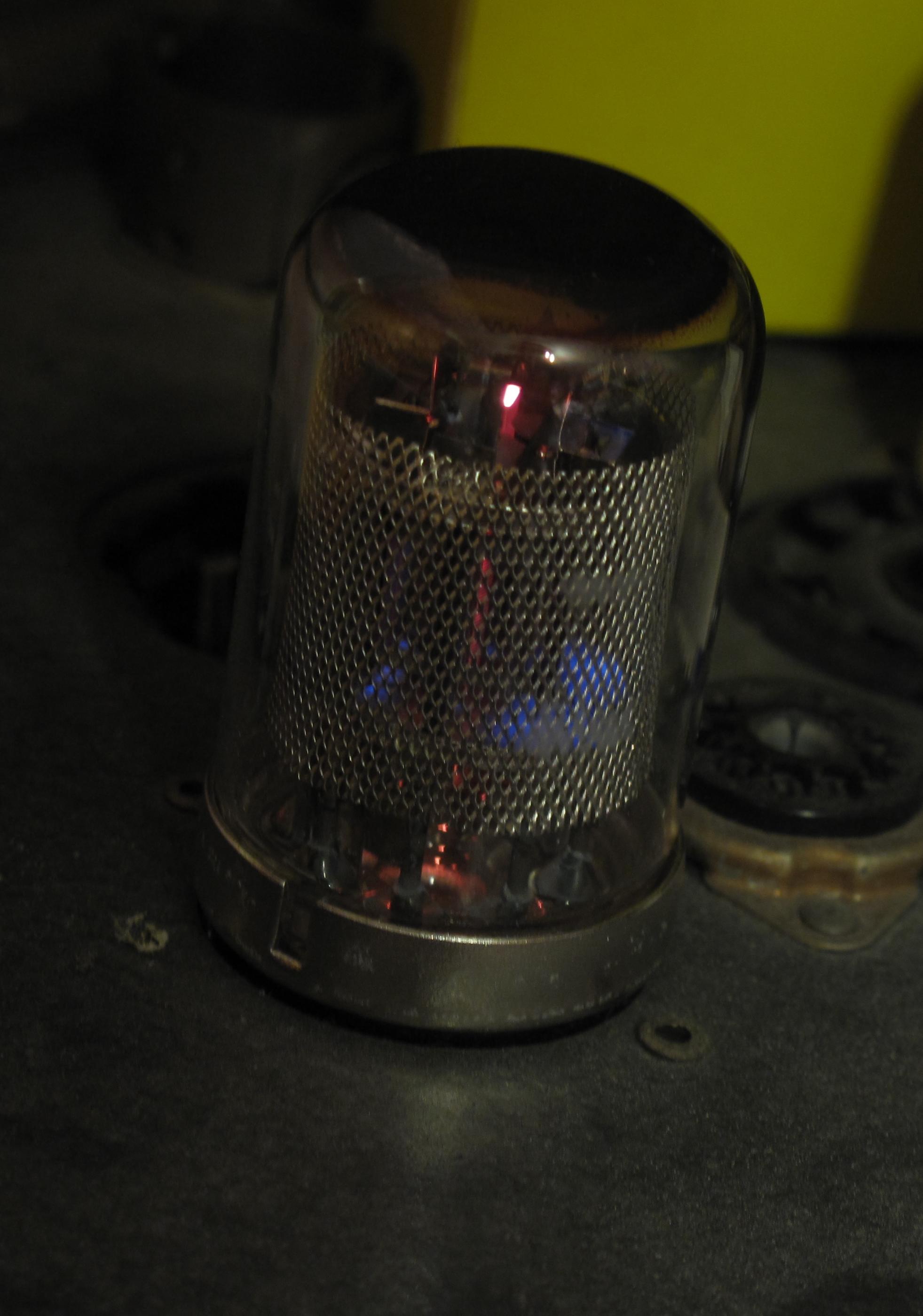

Its not gas, I have seen the effect in all the c3g tubes I have re-based so its probably stray electrons hitting the mica or something similar.

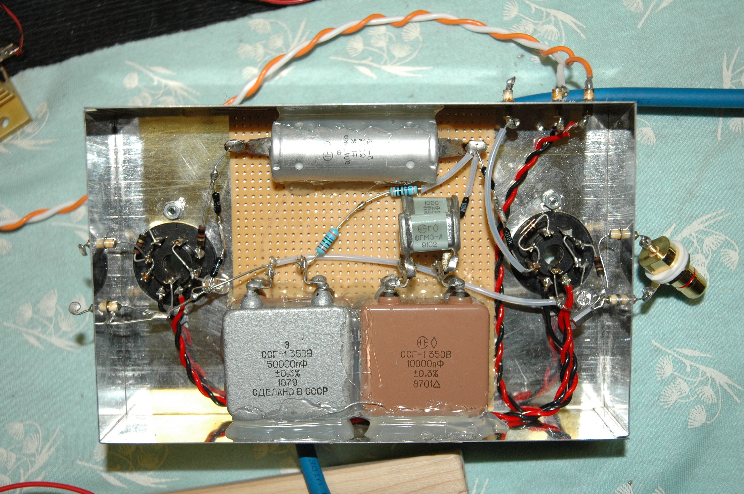

A few months ago I (re) built an amp for my friend.
C3g, IR+Red LED bias, gyrator loaded, cap coupled to "powerdrive", 300B SE, Transcendar 5k:8 OPT.
Very balanced sound, but a bit insensitive (due to the high DCR of OPT).
