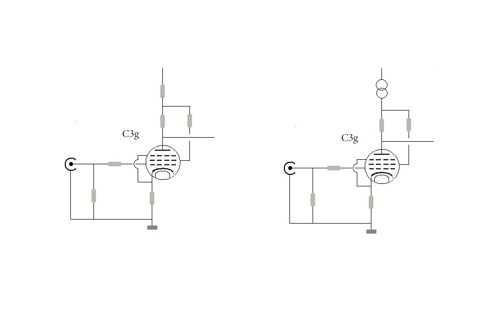

I played around with a CCS and a triode connected C3g
at least I got some interesting curves on the curve tracer
CCS is set to around 17mA give or take.

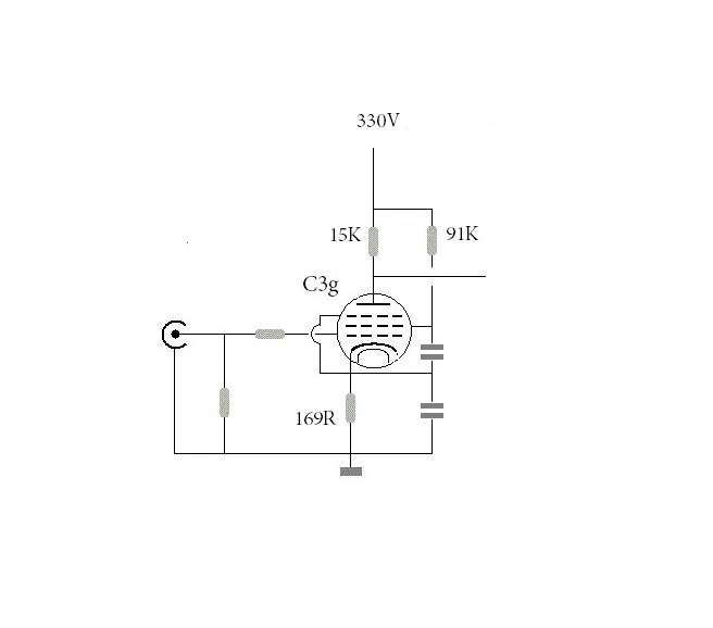

I played around a little
this is the test schematic
supply 300v
CCS 17mA
I connected a 10k resistor as load
supply 300v
CCS 17mA

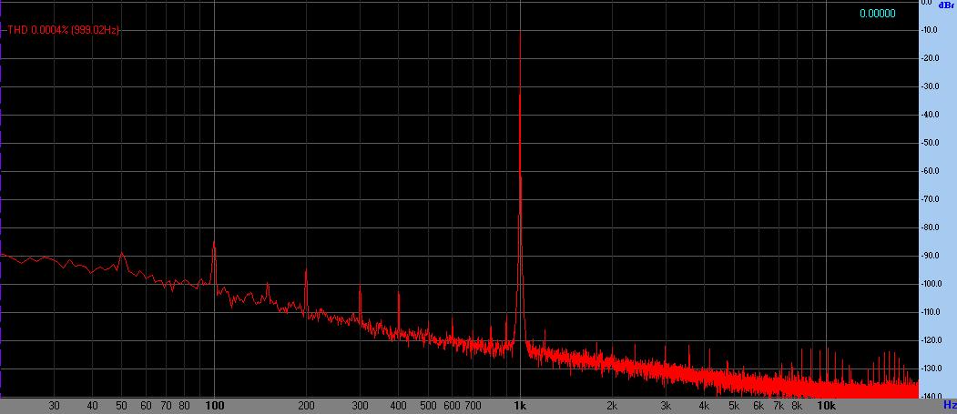

And my distortion meter seems to measure a bit higher distortion than I expected from C3g, its around 1% dist at 50v output.
But It might be my ferrograph rts2 wanking out
How does one measure distortion easy today? with a soundcard perhaps?

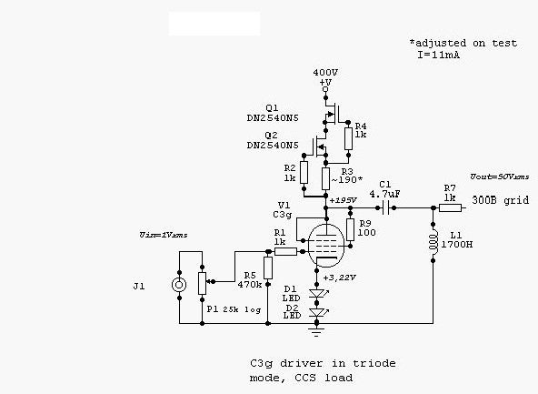

I tried Led bias with a red led
In your schematic the bias about 3V (17mA, 180R).
Try two red LED (1.7..1.8V between 10..20mA) series.
C3g preamp/driver (anode load 11mA CCS, cathode:235R // 100uF) at moderate (1V RMS) input voltage produce 0.1-0.5% THD.

So I connected and measured a couple of times, hauled up my HP 332A dist meter to have as a reference to my ferrograph and after a tune up they measure almost the same, about 0,4% dist @ 300v B+ 1Khz 1v input and with 240 Ohm CR
I found a pink led that measured 3,05v but the distortion rose to 0,5% with the pink led bias
CCS @ 17mA on both
I will measure a CCa and a D3a just to have something to refer to

0.1-0.5% THD estimation based on (about) three dozen -used- C3g measuring.
The best specimens I used in the C3g phono (C3g, 18mA CCS anode load, green LED bias, passive RIAA, C3g, 18mA CCS anode load, green LED bias, D3a cathode follower -9mA CCS as cathode load-).
C3g, C3g, D3a phono at 30mV input:
