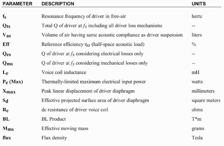

Does anybody have its specs ? There's some on lansing heritage website but there are not enough specs

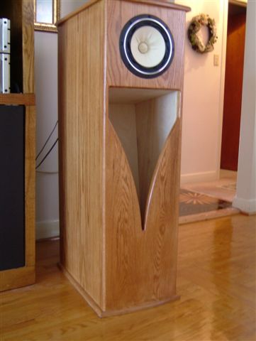

Build RCA-fan's backloaded horn cabinet, sounded insane with the LE-8TH in it. With 25w and corner-located it would pound me all the way to the other end of the house. Do you have two of them? Stereo, my gawd.
RCA-fan's gallery has the plans and some photos....
http://gallery.audioasylum.com/cgi/view.mpl?UserImages=21168

But I can't use these specs there's not the name of each parameter. :xeye:
Back horn ? It's big and designed for low qts and low bass speakers like fostex or lowthers doesn't it ? Does the Le8 perform well in these enclosures ?

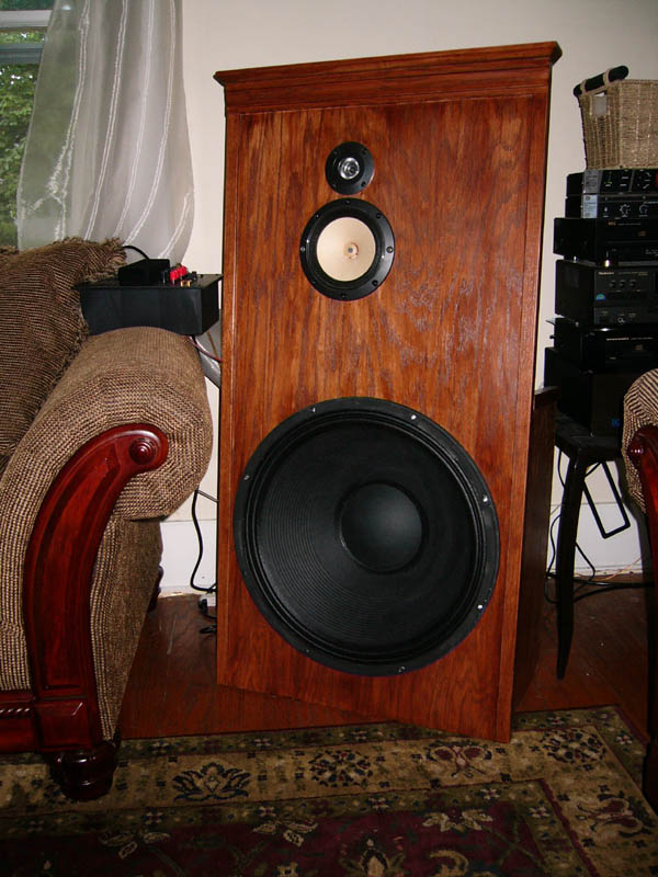

I'll pile on agreement with the assisted-widerange concept. The best results with this type of driver seem to come between about 80Hz and 8kHz. 99% of criticisms arise from trying to exceed that envelope. Within their limits, they're extremely nice.
I've got a pair of OBs with 20" bass drivers on the bottom and RS pod tweeters on the top. I've tried all sorts of widebands between (see pic below). Currently enjoying a pair of Stephens FR80's--very similar to LE-8T's.

I want to know more about the 20" woofers. It looks like there's an actual enclosure behind them? Sealed? Also, I assume you are bi-amping them with that amp that's sitting on the arm of the couch?
The woofers are from steelsound.com. They're real sleepers—alotta sound for not alotta money. They're run OB and have solid performance down to ~30Hz. The sides you see are just ears projecting back to improve low response a bit and support the rest of the baffle.
I was running them off the amps you see (Parts Express cheapos with a useful 6dB 30Hz bass boost and variable lowpass crossover) with very good results. I'm now experimenting with triamping via a DCX2496 and two Panasonic XR25's, but I may return to the old setup for simplicity's sake.
I find them very satisfying.
They're the simple product of the best bit of audio philosophy I've every heard: worship the midrange.
When you've got a nice, dynamic wideband covering the entire vocal range plus the first harmonic, comfortably nestled between a solid, room-friendly bass module crossed over quite low and a smooth supertweeter crossed over quite high, it's hard to go wrong. :angel:
