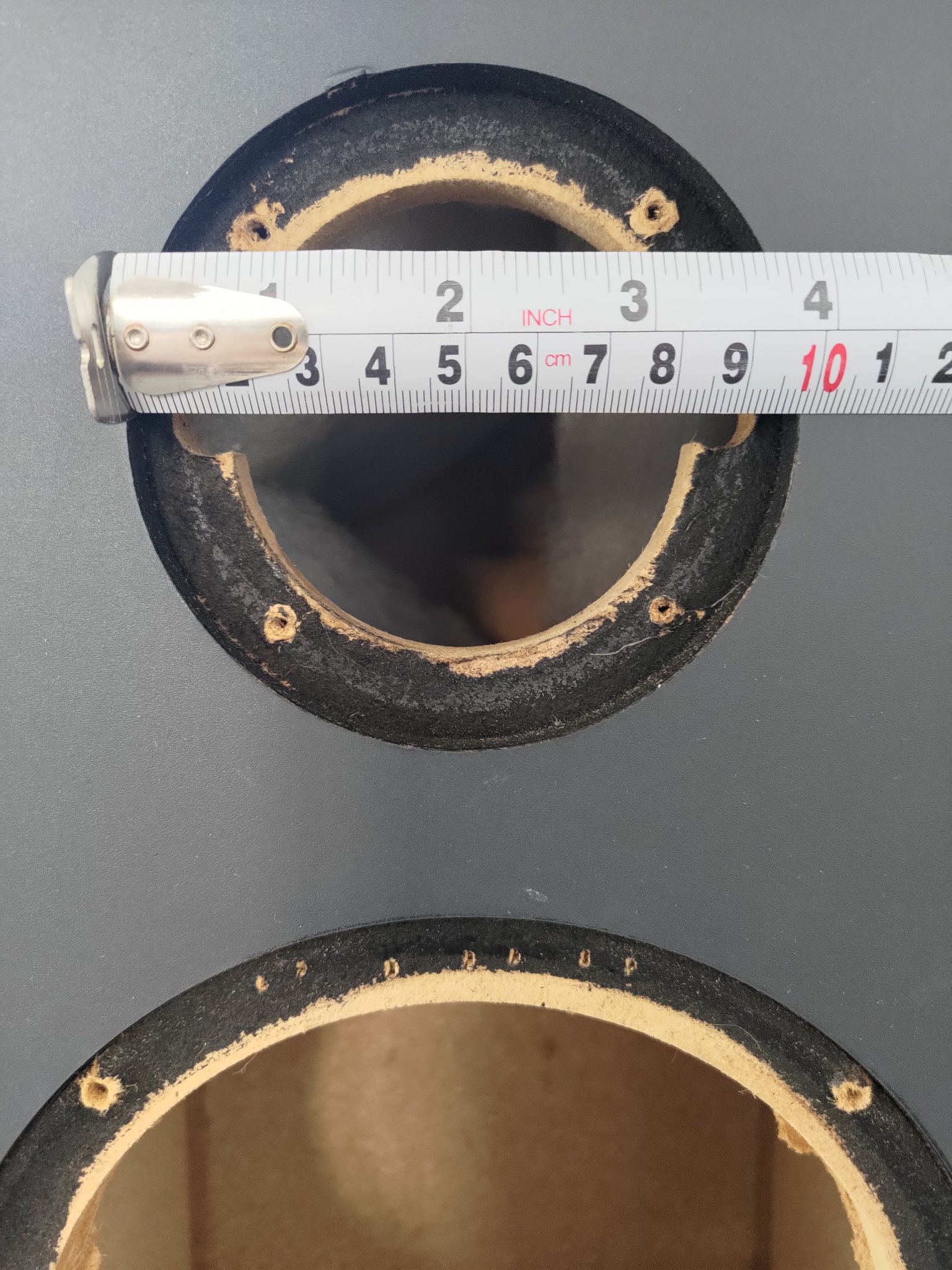

Okay, I96 mm is a known faceplate diameter, but there will be room to install a tweeter with a larger diameter faceplate e.g. 100 mm.

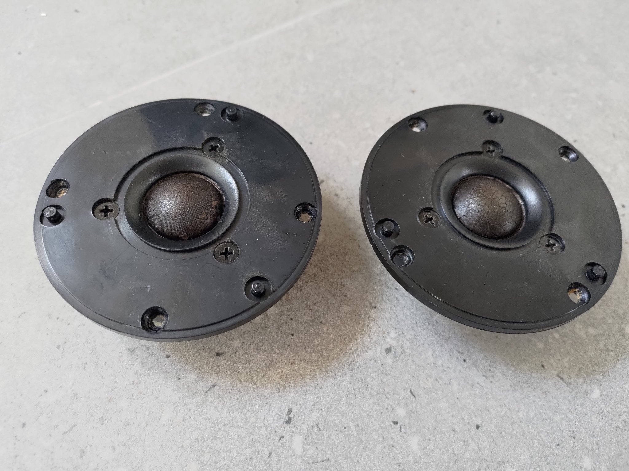

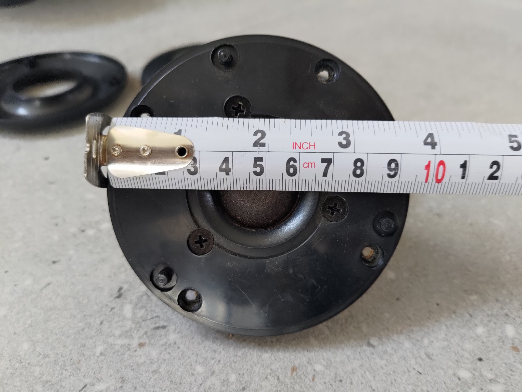

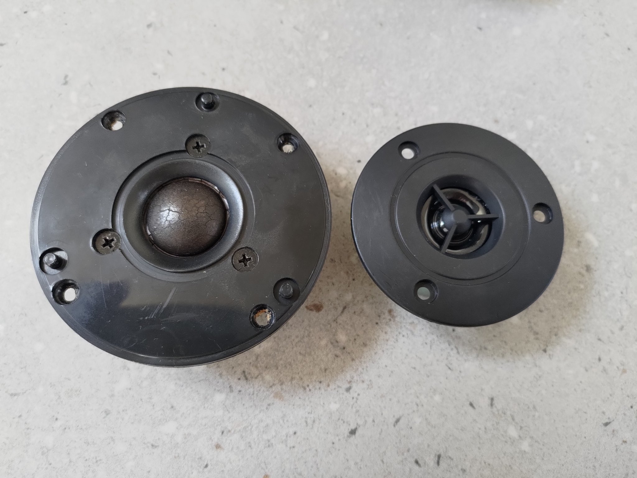

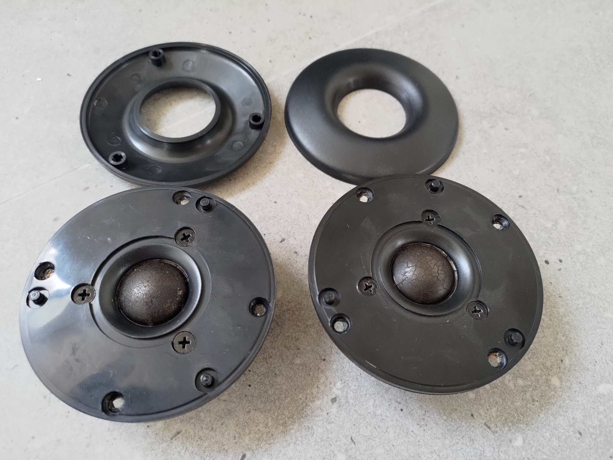

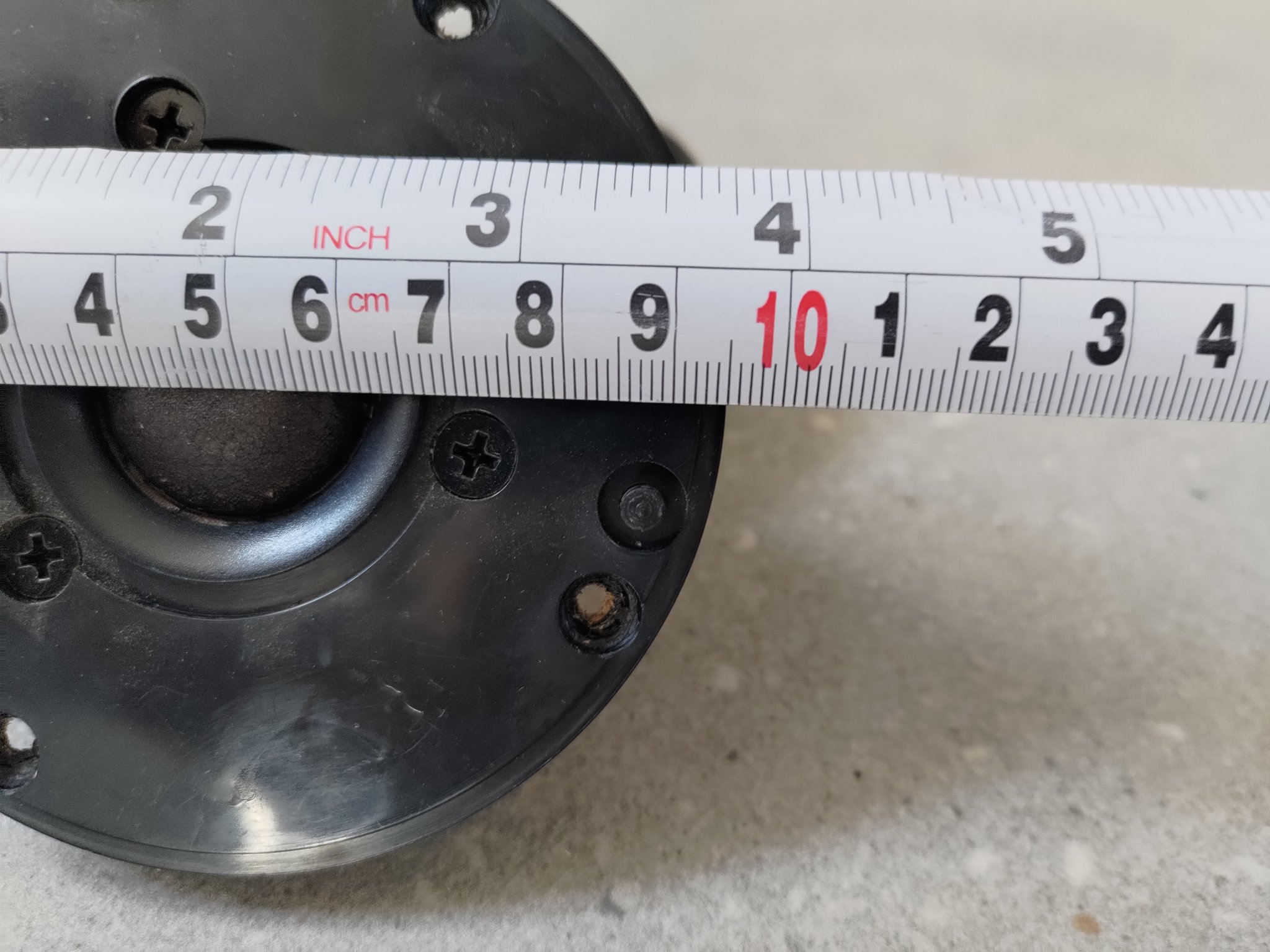

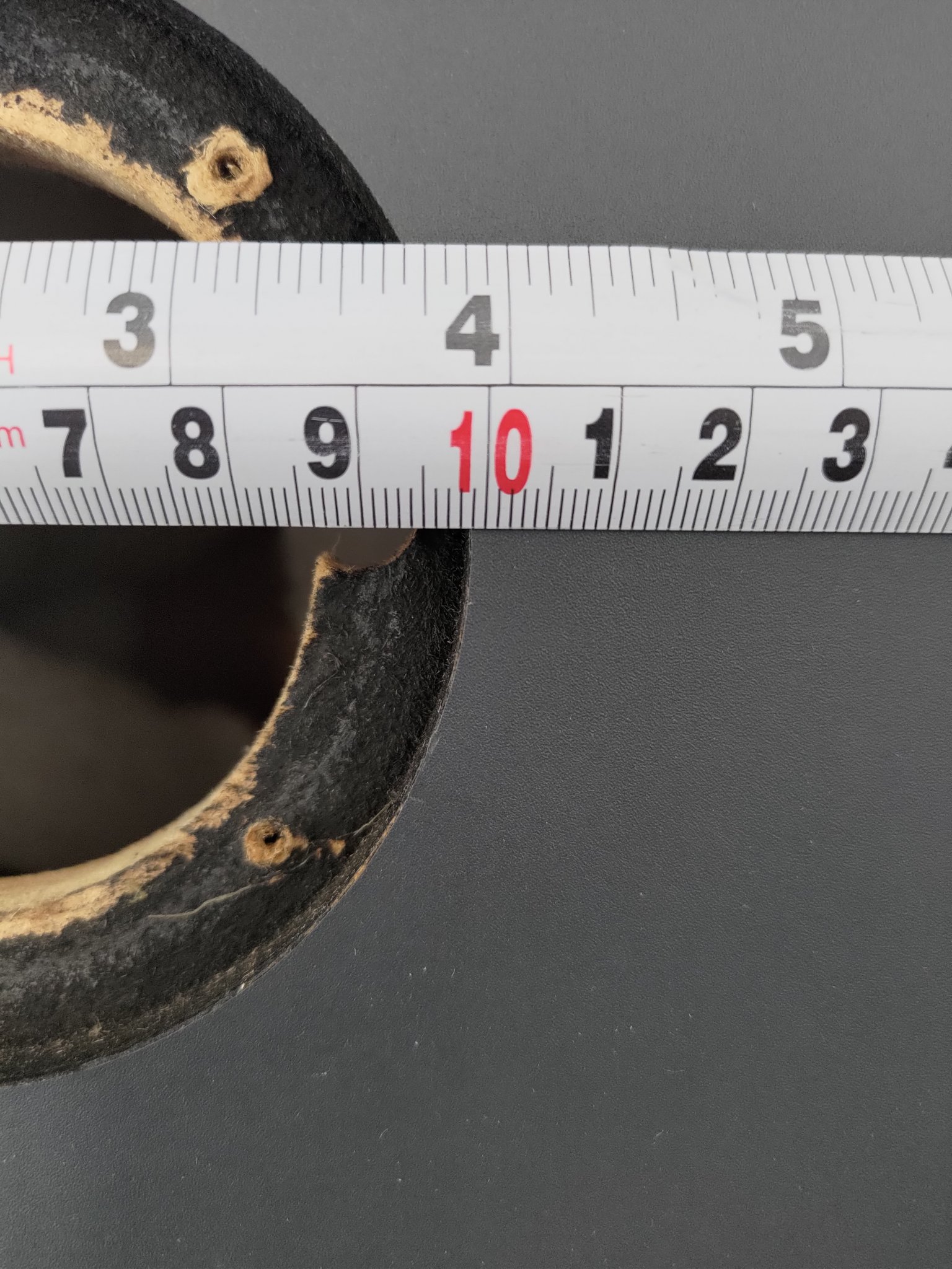

Here are pictures I took of the measurements of the original tweeters and the enclosure cut out.I understand now - by mounting hole diameter, I meant the diameter of the enclosure cut out, not the diameter of the rebate.
It would appear to be a 96 mm tweeter.

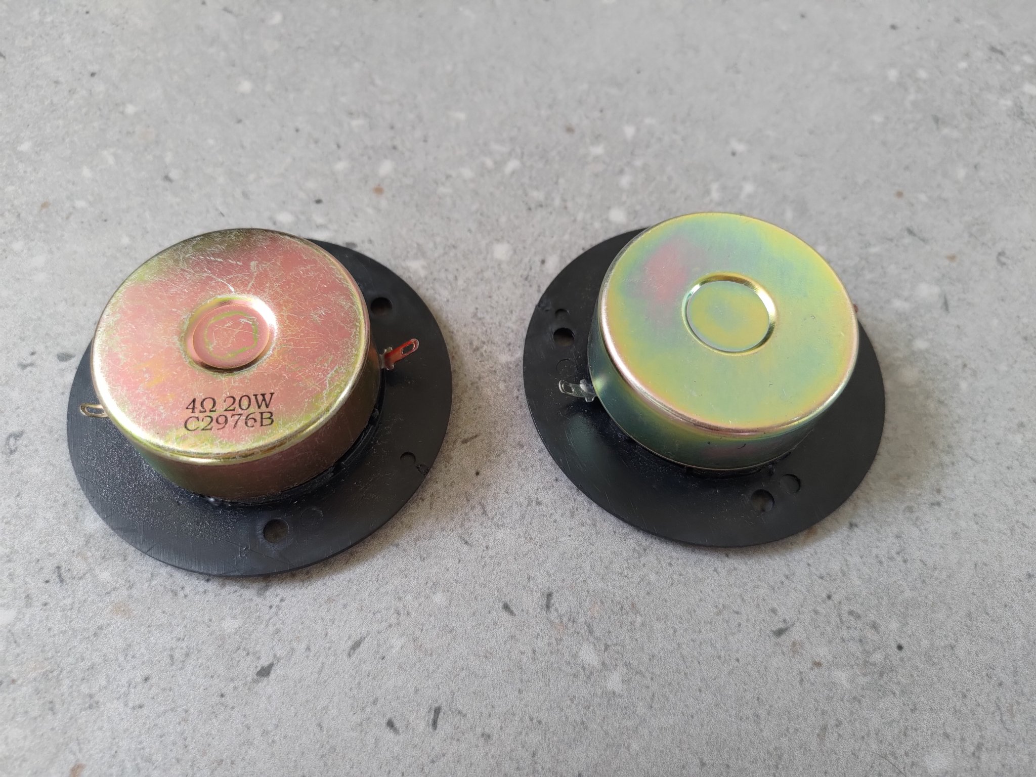

I also took pictures of the new test tweeters, which as can be seen in the pictures are much smaller.

Sensitivity could be explained as how loud they go for a given amount of signal driving them. If you get a tweeter with too low a sensitivity it will be too quiet compared to the mids. This appears to be something you've called 'muddy', and you want to avoid this. You can't measure it with your meter, you can find it on the datasheet.
According to the datasheet the sensitivity comes in at 90db. I'm not sure if that means each driver is 90db, or if the overall speaker is?
That means then, when buying new replacements I should make sure the sensitivity is over 90db if I want to less muddy sound?

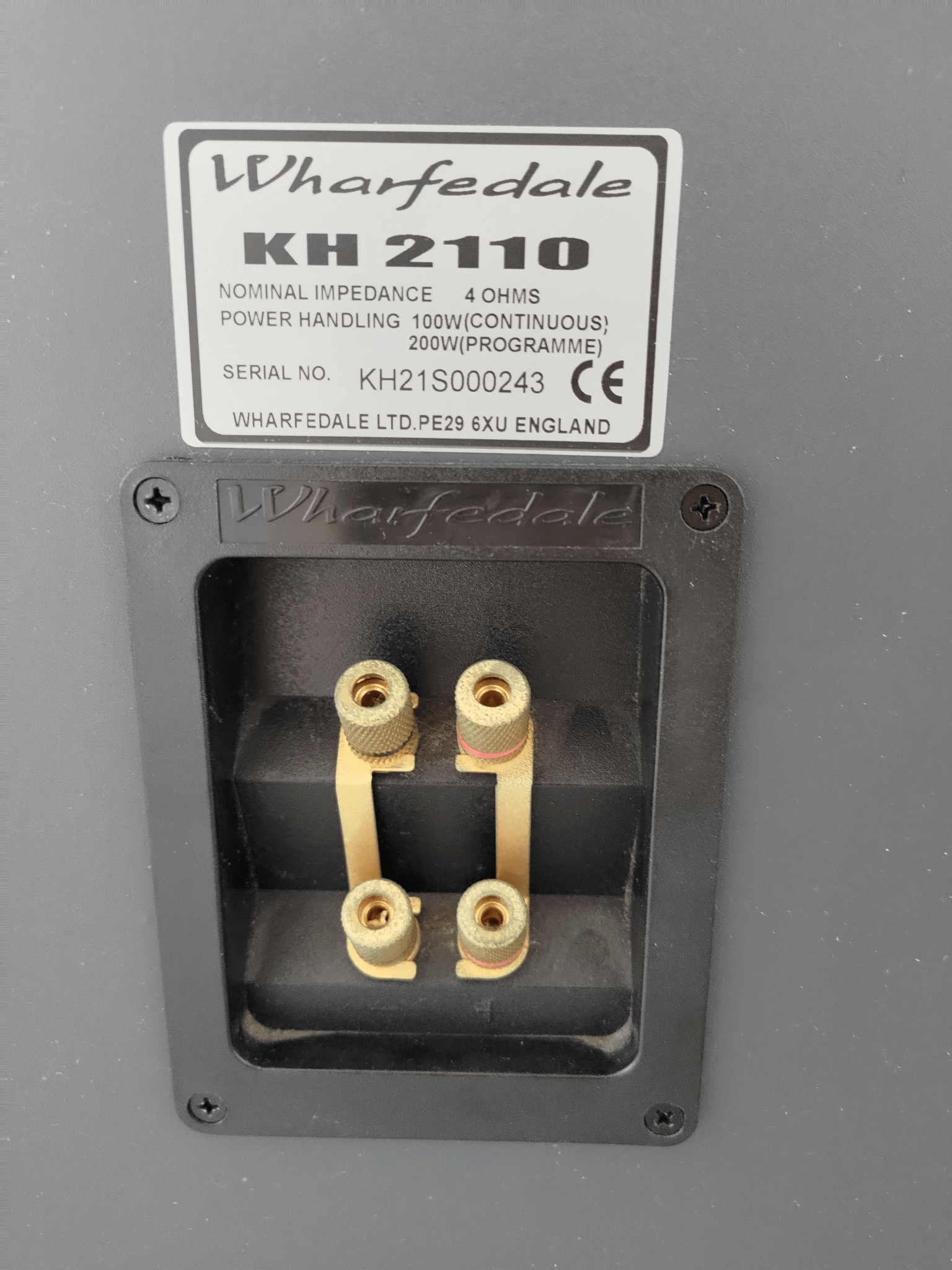

You can do the test without woofer playing, just remove the jumper bars from the terminals and connect the amplifier to the upper speaker binding posts.
Yes, I tried this back in the beginning when I first got the speakers and noticed there was something off about the sound.
I tired both ways, just the highs connected, and also just the lows connected. The highs (tweeters) played at a much lower sound level than the lows (midranges and woofers). I think now with all the testing that's been done since it definitely appears to be an issue with both tweeters themselves, with one tweeter even being worse off than the other.

The temporary tweeters I bought, aside from the impedance, I've got no clue of any other specs really. I simply bought them off of a local eBay style site, and they only cost me about $8 for both. The volume level they play at seems fine to me, but I can also tell they do sound a bit harsh, and I definitely want to replace them with something of better quality.

When I tested using biwire, bridges removed, the highs and lows separately, the woofers and midranges were on the same connection (lows), while the tweeters were alone on their own connection (highs). It might be unique to this speaker how the drivers are separated?
The woofers and midrange drivers sounded fine to me, the tweeters did not. This was way back in the beginning when I did this, before I signed up for this forum, when I first started listening to these speakers not too long after I got them. That was one clue to me that there was something wrong with the highs (crossovers and/or tweeters).
