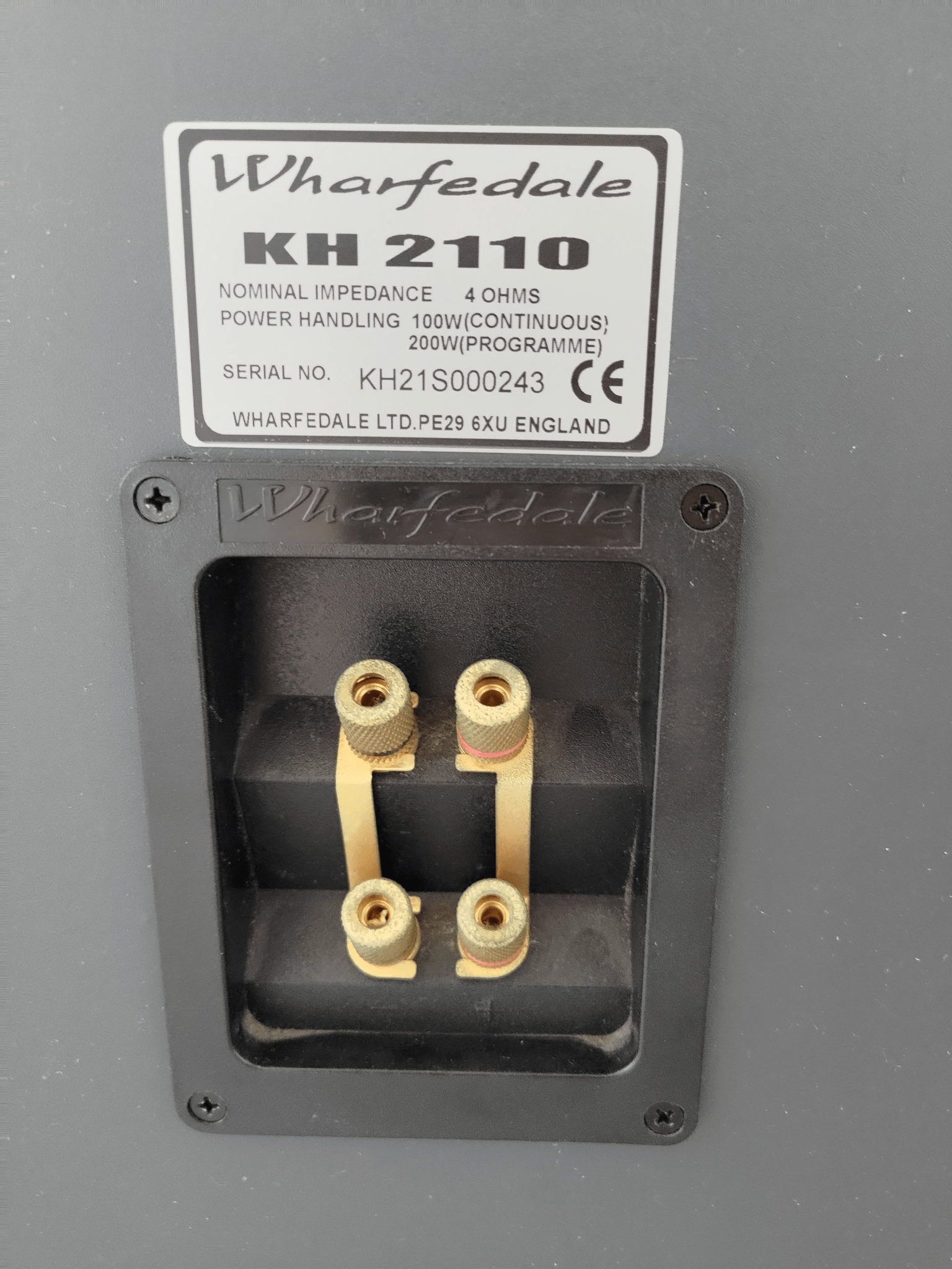

You could supply the old tweeter's faceplate diameter and mounting hole diameter to help narrow down the search for a replacement.
I measured with imperial measuring tape so the measurements might be off my a millimeter or two from conversion and possibly if they seem odd.
Original Tweeter Diameter > 3 3/4" = 95mm
Mounting Hole Diameter > 3 7/8" = 98mm

I still think that the polyswitches have been permanently damaged, and the fact that they now measure different resistances only reinforces that.
A likely value of a fresh tweeter polyswitch in your speaker system would be in the region of 0.2 ohm to 0.4 ohm.
When overloaded, the polyswitch resistance goes very high to protect the tweeter, but returns to normal when the device cools.
However, after an extended period of overload, the polyswitch resistance will not return to normal, but ends up at around 4 times the normal value.
That information would explain the 1.9 ohm and 1.5 ohm readings you are getting with your polyswitches.

96 mm is a known faceplate diameter, but there will be a possibility of installing a larger diameter tweeter.
The KH-2110 loudspeaker has a high 90dB (1W@1m) sensitivity so we need to keep that in mind while searching for a tweeter replacement.
The tweeter crossover point is 3,500 Hz, apparently with a 12dB/octave slope. The 1" soft dome tweeter's DCR of 4.6 ohm indicates a 6 ohm nominal impedance.

I understand now - by mounting hole diameter, I meant the diameter of the enclosure cut out, not the diameter of the rebate.
It would appear to be a 96 mm tweeter.
