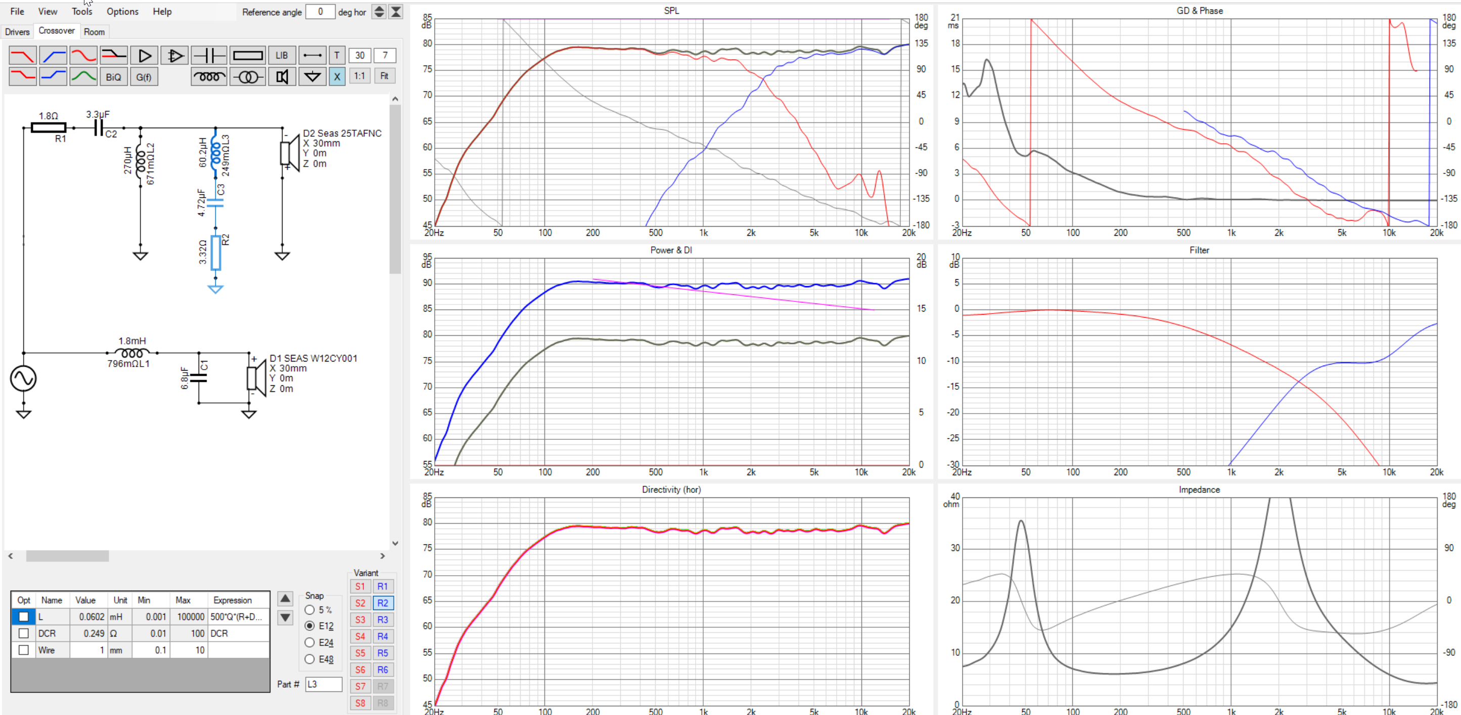

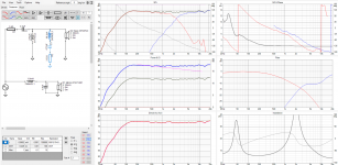

What to build with these drivers?

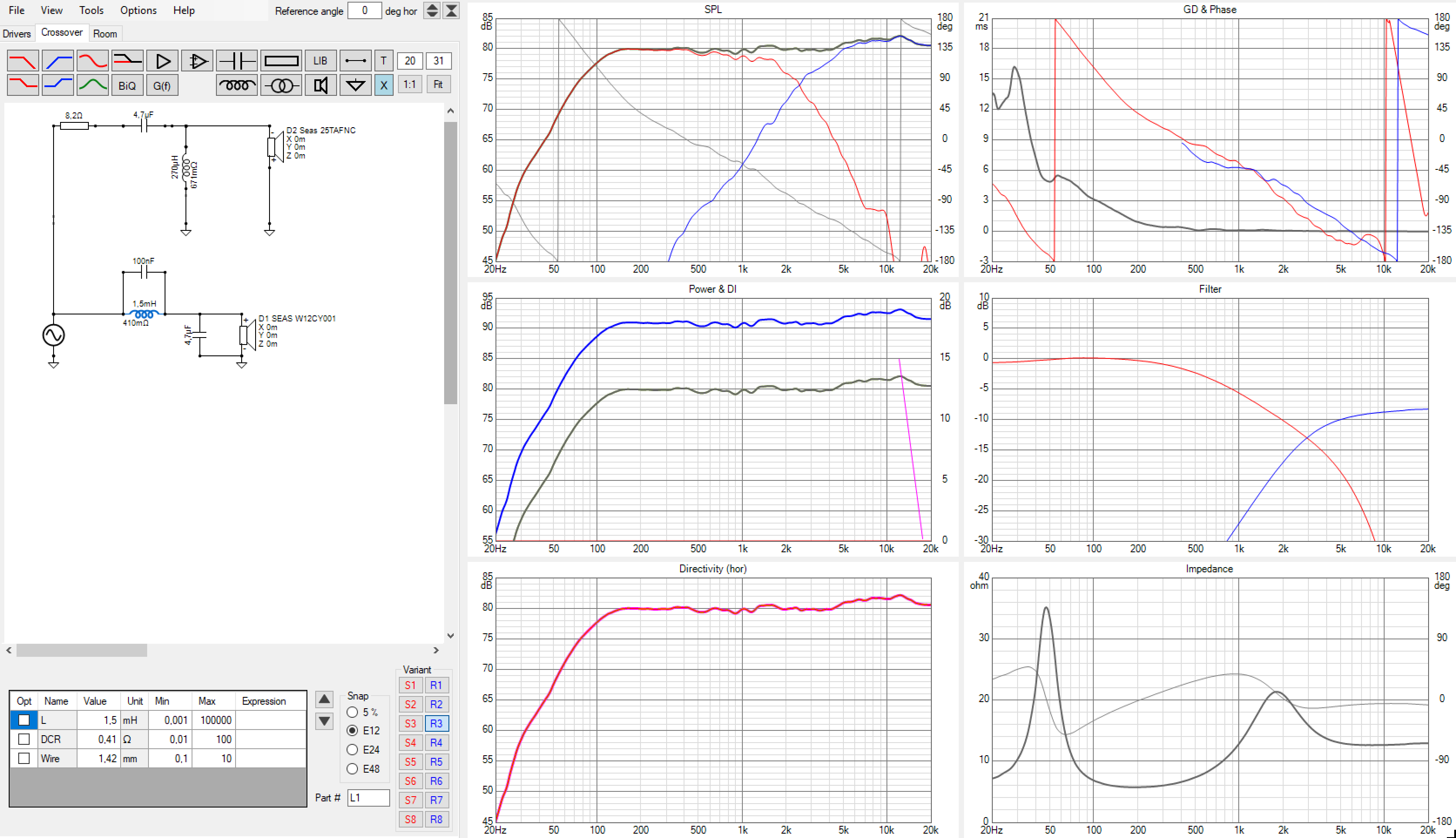

Preliminary xover, any suggestions welcome:

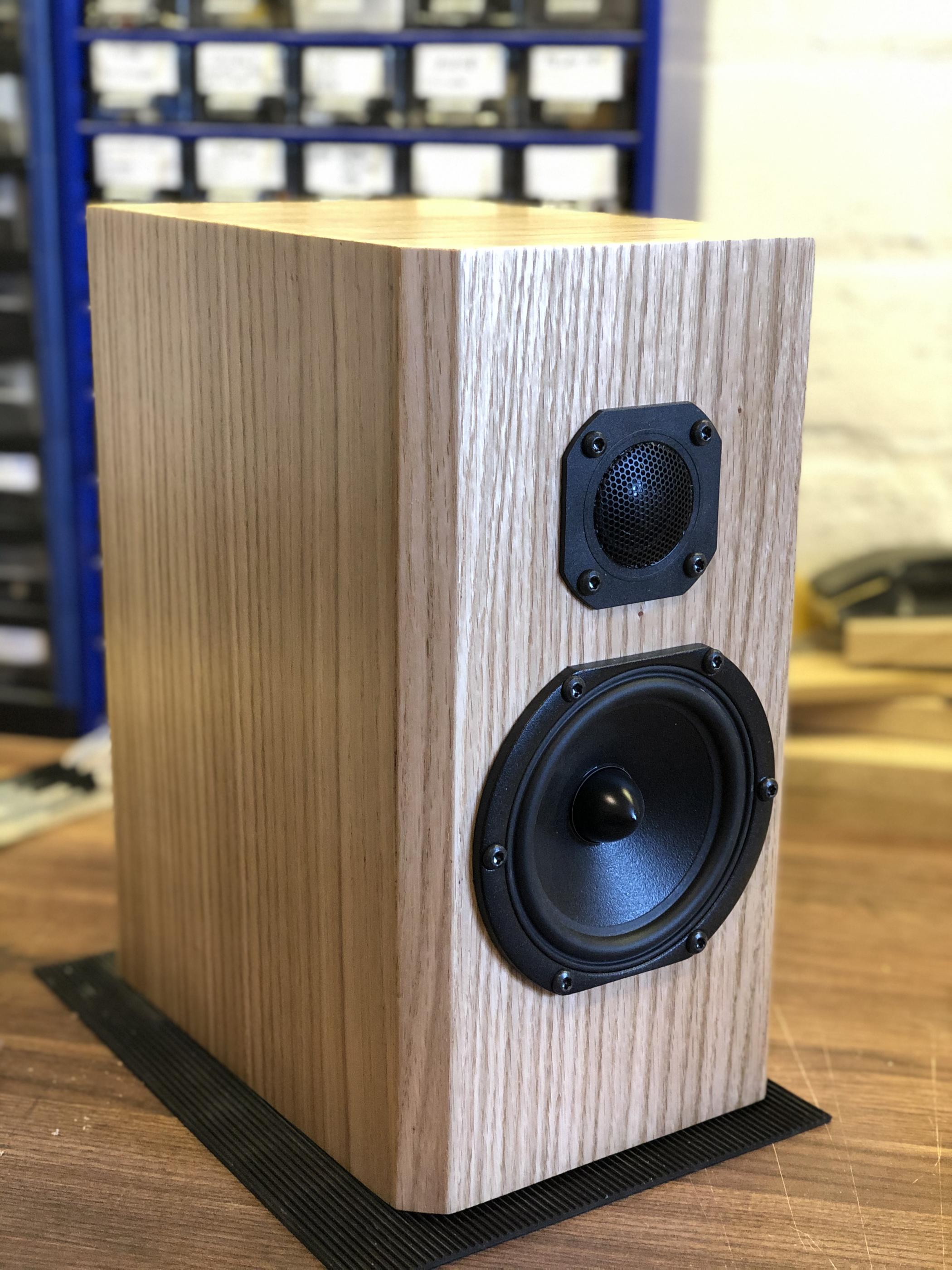

Nice,
790175d1571999879t-build-drivers-img_6375-jpg
Did you see Eekel's Mini at Troels Gravesen's site, zdr?
Eekels' Mini

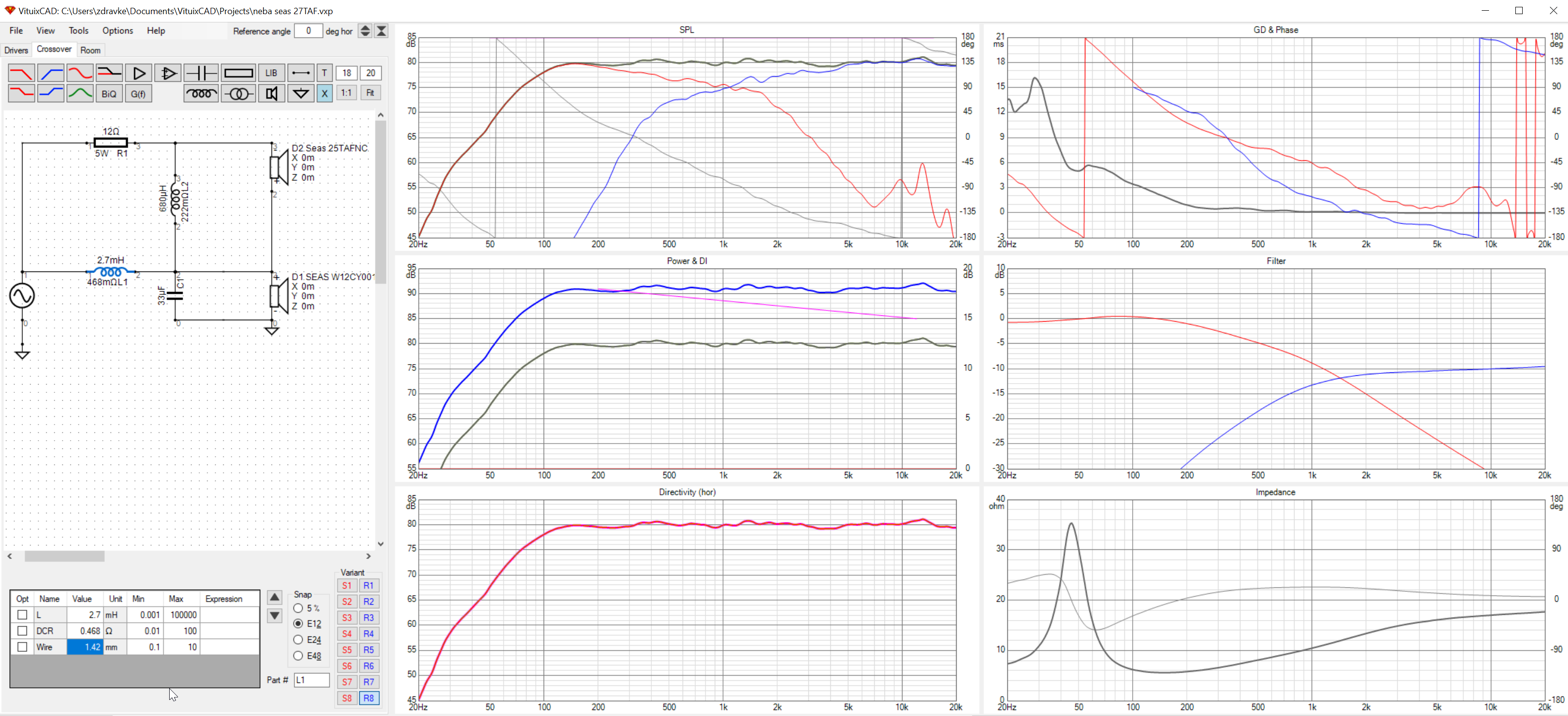

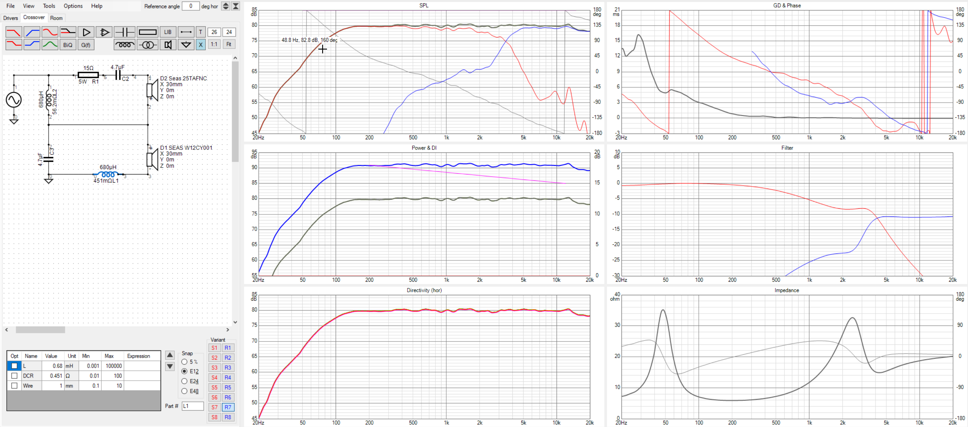

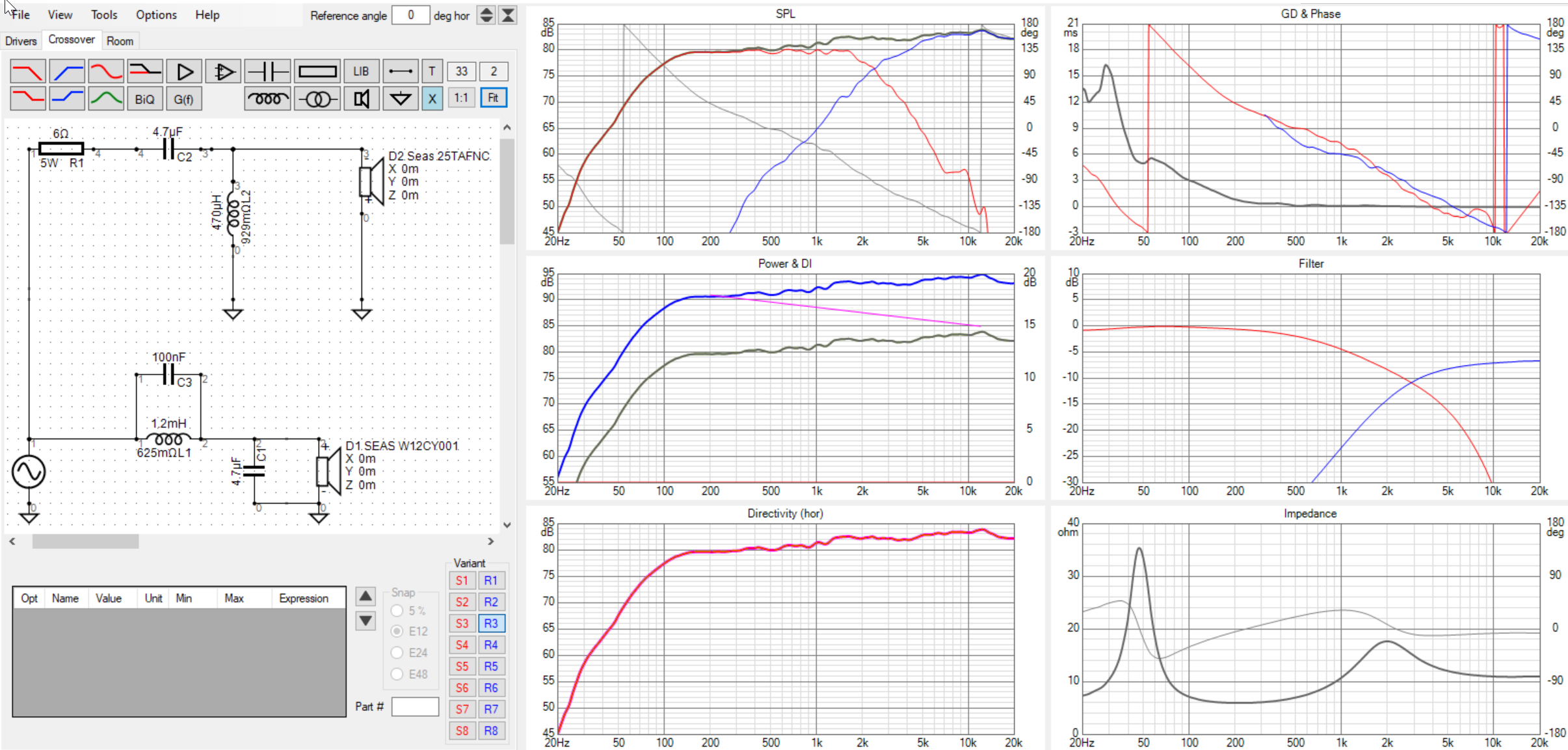

We don't seem to be a million miles away here. Reflex is indicated, presumably. But that needs a Qts around 0.38.
Offsetting drivers is a nice theoretical idea, DickHertz, but in practise, asymetric slopes work well enough too. Hence third order on tweeter, second order on bass. But, hey, I could be wrong. Time aligned is quite the rage these days... LOL
Nice,
Eekels' Mini
I have seen these, yes. But the idea is to be original and to use the parts I already have at the same time. I also do not like to overdo a crossover.
