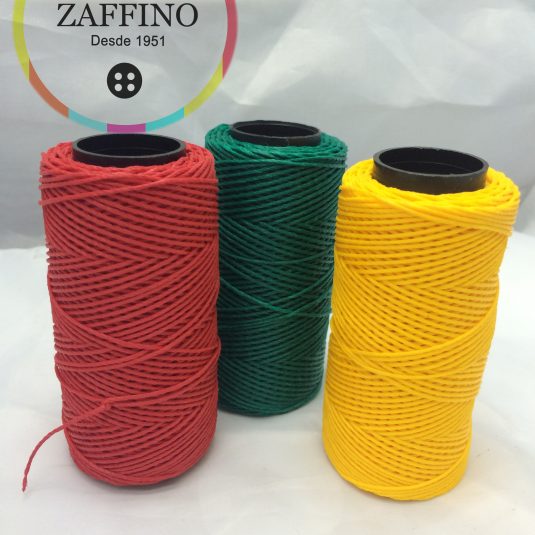

Not sure why would Nylon of any kind need (or even mix with) wax.
You can get waxed cotton tread (usually black) at any clothmaking shop which sells thread, needles, buttons, coloured ribbons, zippers, elastic ribbon,etc.
We call those "mercería", don´t know the English name but should be easy to find.
Also at hobby and craft shops, they use it for bracelets and necklaces or to sew leather.
Now that I think of it, wax may make it easier through leather .... although I guess they are bowing to Tradition, Nylon is quite slippery on its own.
Oh well.
.... clothmaking shop which sells thread, needles, buttons, coloured ribbons, zippers, elastic ribbon,etc.
We call those "mercería", don´t know the English name but should be easy to find.....
"mercería" seems to mean either 'notions' or "hardware store".
'Notions' in relation to crafts is a store full of needles, buttons, ribbons, zippers, elastic, bricbrac..... and likely waxed cotton or linen string.

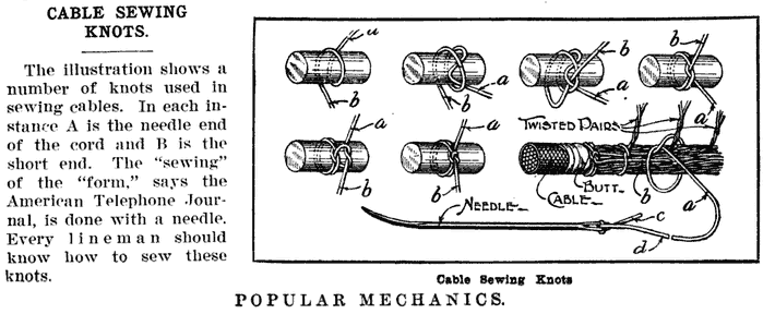

Proper wire lacing should be flat.
Cable lacing - Wikipedia
waxed lacing cord - Google Search
LACING CORD / NEEDLES
https://www.newark.com/c/cable-wire-cable-assemblies/cable-management/cable-ties/lacing-cord
https://books.google.com/books?id=oN8DAAAAMBAJ&pg=PA550#v=onepage&q&f=false
PRR, this illustration you posted looks like from a time before cables/wires even were invented (exaggerated of course)! Wonderful!

Gosh! I just realized it not only mentioned CABLES, but the pictures actually is about them, and how to „treat“ them! 😀 :clown:
(I actually just admired the typo-/graphic style of this really wonderful illustration)
And the knowledge you shared with it is precious…
Wire loom/lacing at STC was one of my first jobs. I laced the AUSSAT satellite wiring loom on a big mapped pegboard and the company was confident to put a 25 warranty on the wiring. No returns yet, LOL.
It's similar to knitting, planned and serene tidiness.
