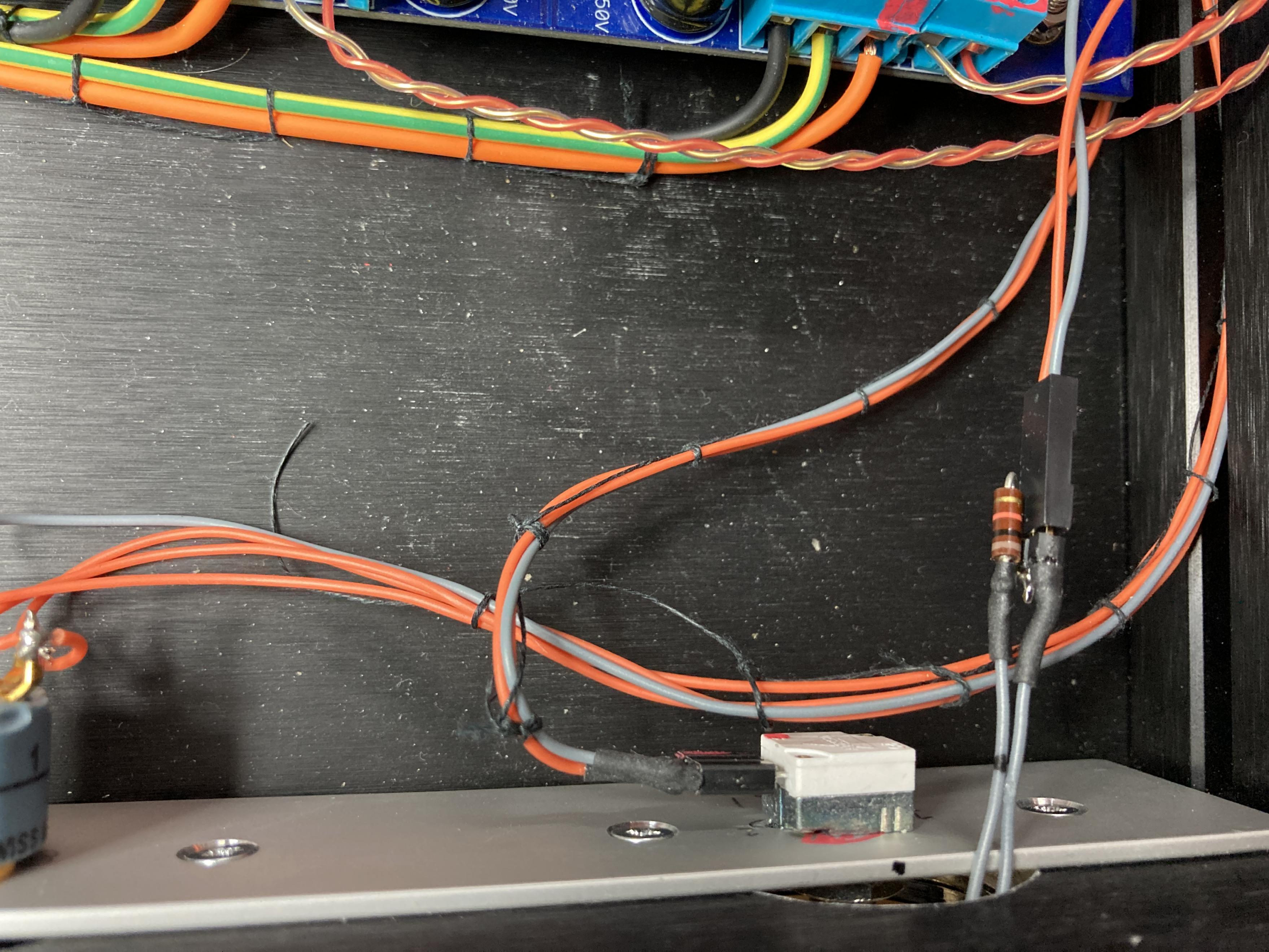

Don't get me wrong, but what you think if you cut down with all these wires.
I remember the 70' almost each and every box looked like the picture you placed.
IF I do not use plastic Zippers, then I use shrink rubber and get all input wires together, and so on. looks also neat and clean. I think I you know that each of these soldering joints on the wires is a possible Error Source...
I for one try to use as little as I can and as circuit allows..
Also that 10KOhm 5% Carbon Resistor *right side in the box* what is that one needed for? Hopefully not in the signal path..

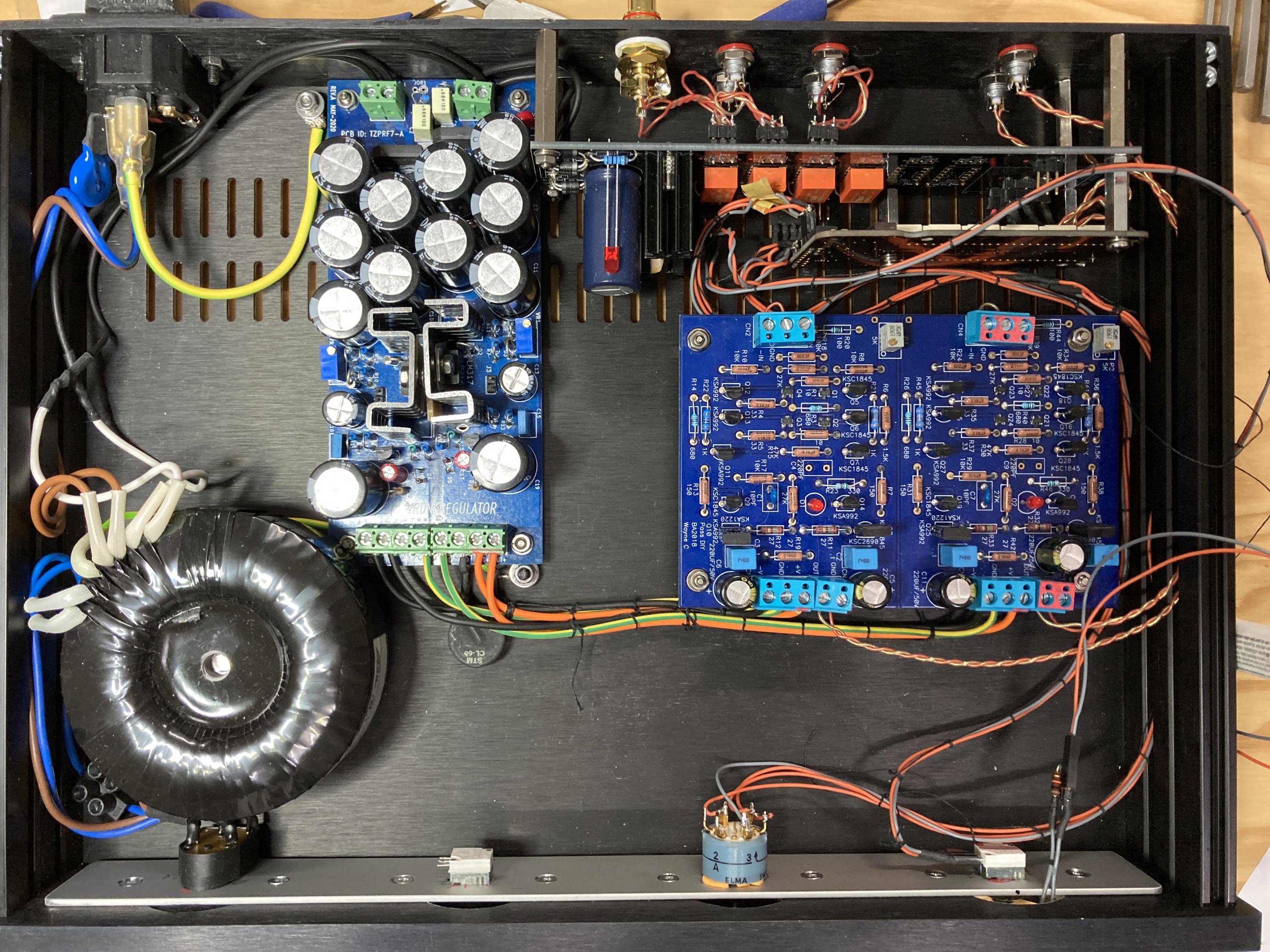

Thank you, Chris!
I think I get your point. You’re absolutely right, these wires don’t look very well thought out, but: All those wires (lower part of image) aren‘t signal, they're a) the pot controlling the relay-attenuator, b) the switch controlling the source-selector-arrays (salas‘ i-select), and c) (together with the resistor) the wire feeding an led.
Only those twisted wires are carrying signal.
And, I'm grateful for any critique as long as it’s constructive—in fact I'd like to get more critic comments on my clumsy builds …
Please again, it's not Critic.. at all

Lacing wires together used to be all the rage.
However putting 2 wires (or more) in close proximation can pass signals between them.
Thought needs to be put in as to which wires can be laced together and which cant.
i.e. I wouldnt lace in amp output signal to input signal unless it was screened.
Yes of course you are right..
My amps have 6 wires per side which are directly connected to the board. - not counting the Wires for the Fans.. they have separate ways
Vrail +-, GND, Output and input all with at lest 10cm distance to each other..
Also I do run shieldet wires for Input, and these are not soldered, I use mostly gold plated RCA JACKS soldered to the board. of course at tback input connectors these are soldered using Silver Solder / it only 4 % silver but it counts..

It looks pretty, but it makes service work a massive pain in the butt, so I don't do it unless I have very good reason to. One or two zip-ties, just to keep things in a general location, is plenty and doesn't make service a nightmare.
Sometimes I do end up servicing equipment where I want to preserve the original look, or I'm adding onto it and want it to match. In such cases, I just use whipping thread, and it works OK. I keep quite a bit of it in stock since I do all my own splicing for halyards and the like, so it's a convenient option for me. You can get it at West Coast Sailing, Fawcett, etc. West Marine is pretty much useless.
