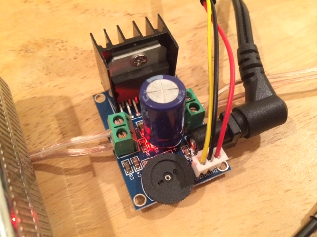

I just got a couple of these from Aliexpress for $2.23ea (shipping included). They are SMT except for the main power cap and chip amp. They are quite a bit smaller than the usual thru hole version we have all been using. I still need to hook it up and listen but how can you go wrong for $2.23? Quality appears to be good and has SMT LED power on indicator. I actually like the 3 pin input header more than 3.5mm input jack. Useful for putting inside a speaker. I am thinking of mono blocking these.

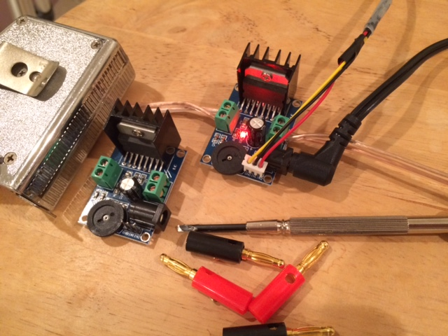

Oh there is no comparison. These $2.32 TDA7297 amps are kind of mediocre sounding, not as good as the bigger thru-hole version. I even tried upgrading to cap from 220uF stock to 2200uF and it improved the bass somewhat but still did not have the clarity of the larger thru hole 7297. I would not use these in anything more than a table or clock radio type background music application. Converted to monoblocks maybe they might be perfect for single speaker application. I suspect the SMT input cap is no good. Also, the cheap plastic pot is probably not up to snuff and adding noise and grit. My next attempts will be to replace the SMT input caps with quality TDK X7R caps or C0G caps. Remove/bypass the pot. That will probably help a lot.
Here is the amp undergoing testing with music:
Here is the cap upgrade:
