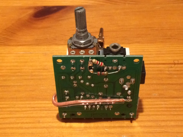

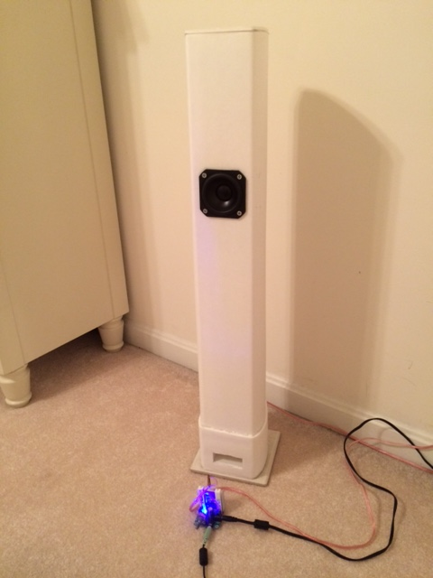

Mono Conversion for Lunch Money Amp
How many of you want to use these inexpensive amps to drive a single mono kitchen or table radio speaker from a stereo source? Especially nowadays, Windows does not even have a way to play mono from system settings anymore.
I have a mono speaker I use in my office (a flat wall-mounted Alpair 7.3 MLTL) and sometimes I want to use a single Tabaq. But my sources don't make it easy to play mono from stereo sources.

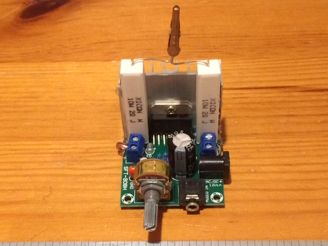

I got this tip from Sreten and tried it out and it works like gangbusters with the TDA7297 or any other class AB amp that can have common ground on both channels. Won't work with class D BTL amps.
Basically connect a 4.7k resistor in series between left and right inputs and common them together. The on outputs use a power resistor like 0.33R in series and tie those together for the singular mono output +ve. Tie the negative speaker outputs together.
I only had 2k resistors and 2R power resistors on hand so did it with those values and it works very well still.
I took an xacto and cut the traces on the PCB between the 3.4mm input jack and pot. Then replaced the cut trace with the 2k resistor for each side. Then connected the resistors together at the stereo pot input. I found that a 10 watt Xircon wirewound sandcast power resistor slips perfectly into the space between the TDA7297 and the heatsink, a few dabs of hot melt glue to hold in place and connect the bottom leads of the resistors to the +ve outs. Tie a common wire between the negatives on the speaker outs. Now connect your speaker to the negative screw terminal for negative and the common outputs of the power resistors for the positive. I used a small alligator clip since this connection no longer has a screw terminal.
Photo of 2k resistors and PCB surgery (reversible if you bridge cut later):
Photo of 2R power resistors with common alligator clip out:
Here it is being tested with Tabaq with P830986:
I tested it by panning the stereo input and found no change in speaker out sound. I also tested by switching between mono and stereo out from my phone. No effect on sound.
Works quite well and a cheap mod for a nice kitchen speaker amp. In normal operation at 12v and with 4ohm speaker, the heatsinks and resistors are hardly warm so hot melt glue is still holding. If not, use high temp RTV.

You can also connect the R & L input together after the pot. And then just connect the + and the - for each channel to binding posts. It does work. However it may degrade sound slightly; not that in this application you'd care.
Whatever reason for connecting the + output together for resistors is silly if not also doing the -, because it's balanced output.
So you are saying either forgo the output resistors or use resistors on negative also?
Yes.
I don't think you need any resistors at all. Danny from GR Research didn't. He made a paid of monoblocks without them, and liked them.
Oh that makes it easy and sweet - just a few wires and solder bridges and I am set. I have a couple more amps I can try it out on then ans see if I notice and difference in SQ. Danny is really a good designer, and if he likes it then it must be fine.
