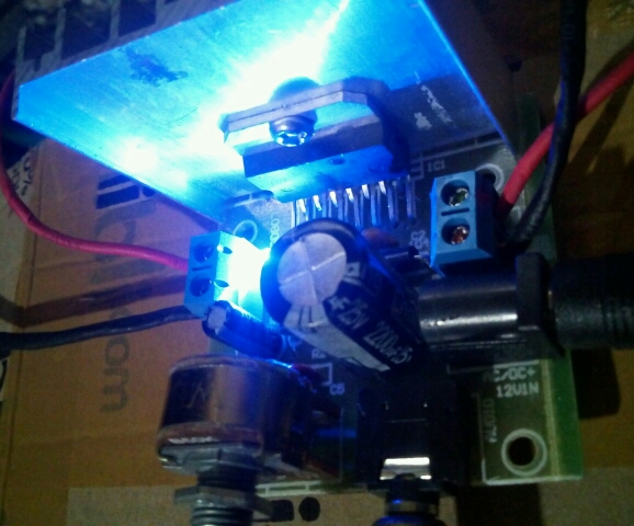

It's the same as the homemart that was just linkekd to be myself and another guy.
The mods consist of new capacitors, removal or unnecessary partls when using DC power supply, and correction of ground mistake. The website with the guide should be up shortly, if not I'll make one on here for whomever wants.

My "lunchie" is now housed in a cheap ally box, fitted with a cheap stepped attenuator and a Panasonic 3,300uf FC cap and singing sweetly powered by a 12V smps brick.
2nd board has had the Panasonic cap fitted and a pair of JB 1.0uf polypropylene coupling caps fitted, actually think I prefer the stock coupling caps which on my boards were polyesters as supplied.
As I type this we are listening to a Linn Klout power amp in "lunchies" place that came for repair, apart from the massive power difference we all agree that in comparison the Linn is aggressive (yes it is working to spec) and tiring to listen to for extended periods whereas "lunchie" has been on for hours at a time, day after day and seems to get better as those days pass!

I have several 7297s. They all sound very good, whether stock or modified. While waiting for my "Wiener" TPA3116 from gmarsh, I had a brainstorm regarding power.
A slightly modified 7297 is now powered by the Somfy solar rechargeable battery wand that powers a nearby blackout shade. The wand (aluminum tube) holds 10 Amazon Basics rechargeable AA batteries.
