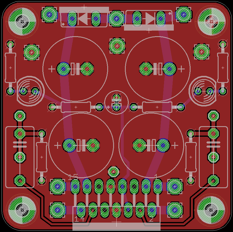

Here's my pcb design for this amp. I made it with the help of danielwritesbac, without him I couldn't have done it like this. I post it so anyone can make it and enjoy it, as I am!

I just used whatever I had laying around that fit the footprint.
The diodes are to220 package, I think I used MUR860 or something like that. You can use any diode that fits the power requirements. Calculate the maximum amount of current that is going to go through them, and see what power they will dissipate for 0.6V drop on them.
Also choose the power supply knowing that 0.6V will drop on them. You could omit the LEDs, they are only as an indicator for each power supply rail.
Lots of discussion on the big caps, you can choose from 470uF to as large as it fits on the footprint.
The rest of the values are from the datasheet, the small cap should be a 10uF I think and the resistors...I don't remember. Look up the datasheet for tda7297 and you should see them.
The board can accommodate a single supply (you must install links instead of the diodes, double supply for each channel (you have pads after the diodes) or you can install one supply with the diodes to separate the rails.
Input is near the NP capacitors, you also have two pin width options for the input caps.
Signal input ground is right next to the chip pin.
