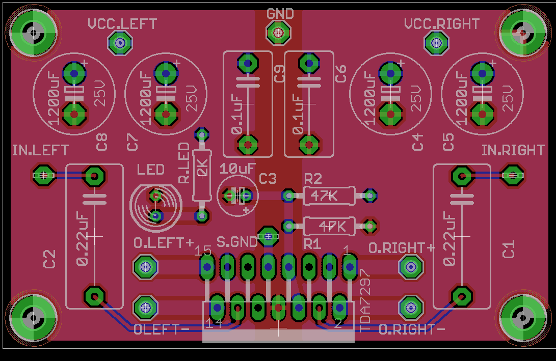

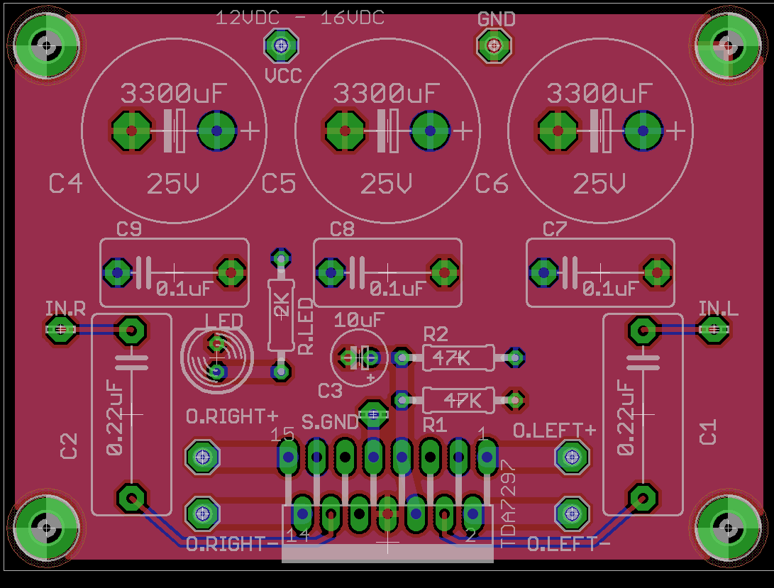

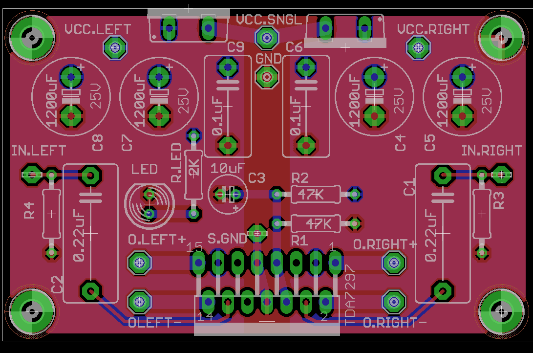

My tda7297 came yesterday and I'm having fun with it. I removed the diode, removed the power socket and also replaced the input caps and the reservoir cap and I've bypassed it. But I'd like to give it a proper regulated supply and put it in a case. I'm planning on using a buffer in front of it so no pot on the pcb.
Also I'd like to put more capacitance on power rail so I figured, since it's not that complicated, to make a pcb for it. I added a picture of the board. Now, I would only need about 2 or 3 of these tops, one for a friend and maybe I'll make one for my father. Would anyone else be interested to get together and get some more so we come out cheaper? I see many of you got some tda7297 here so maybe some of you would like a bit more space for nicer capacitors. Also if you have some ideas regarding the board layout please tell. The current footprint for the power rail capacitors are for Panasonic FR 3300uF/25V, and the input/bypass ones are Wima, but I guess you could put in whatever you wish.

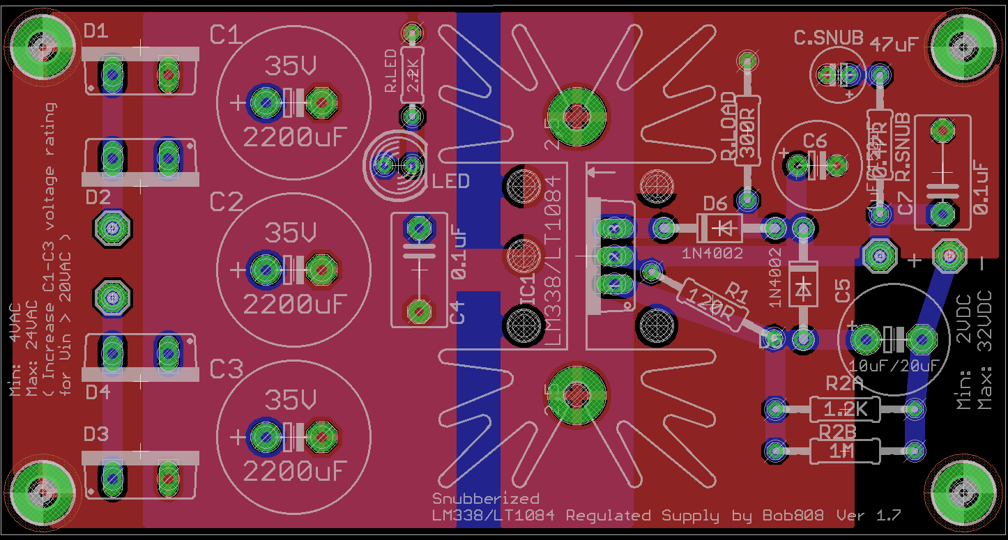

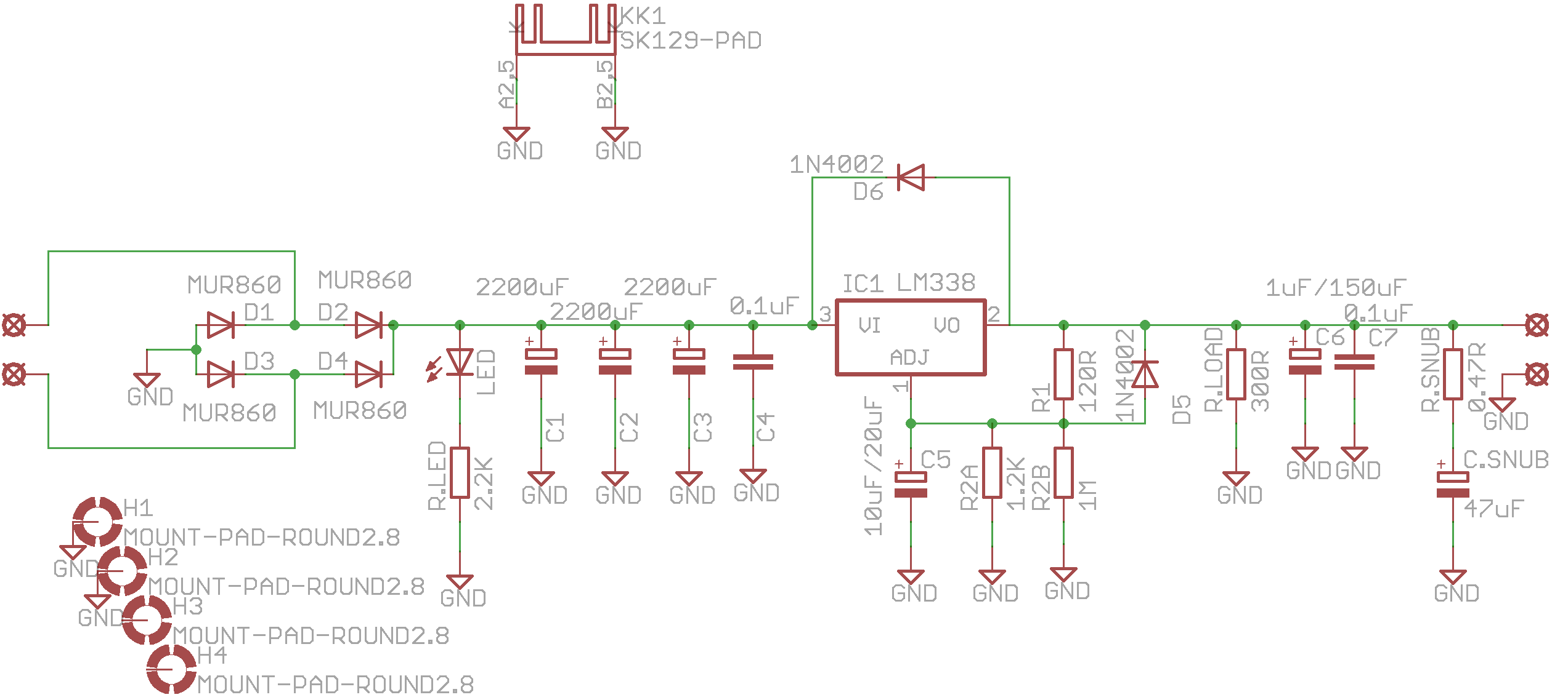

This is only my second board in eagle. I also designed a LM317/LM338/LT1084 etc one that I'm planning on running this amp and another ta2020 from. If interested we can make some of those too. Those I'd need about 5 or so 🙂

For stereo separation and higher end imaging, we might want to address the fact that there's 2 amplifiers in there. This particular amp is unit ground so we're not going to change that. However, it has TWO power pins because it is two amplifiers. This needs separated so your stereo imaging can be big.
Before starting that.
For any of this, we're going to want 220u~470u caps, one cap on the right amplifier's power pin and one cap on the left amplifier's power pin. Caps go directly from power pin to ground.
Here's a few ways to do the separation.
1). Traditional Dual Mono (like monoblocs in only one box) with two power supplies.
2). Traditional Virtual Dual Mono with a capmulti for left and a capmulti for right.
3). Advanced Virtual Dual Mono with a regulator for left and a regulator for right.
4). Simple Virtual Dual Mono with a schottky diode for left and a shottky diode for right.
Items 2, 3 and 4 above use an active device as a series element.

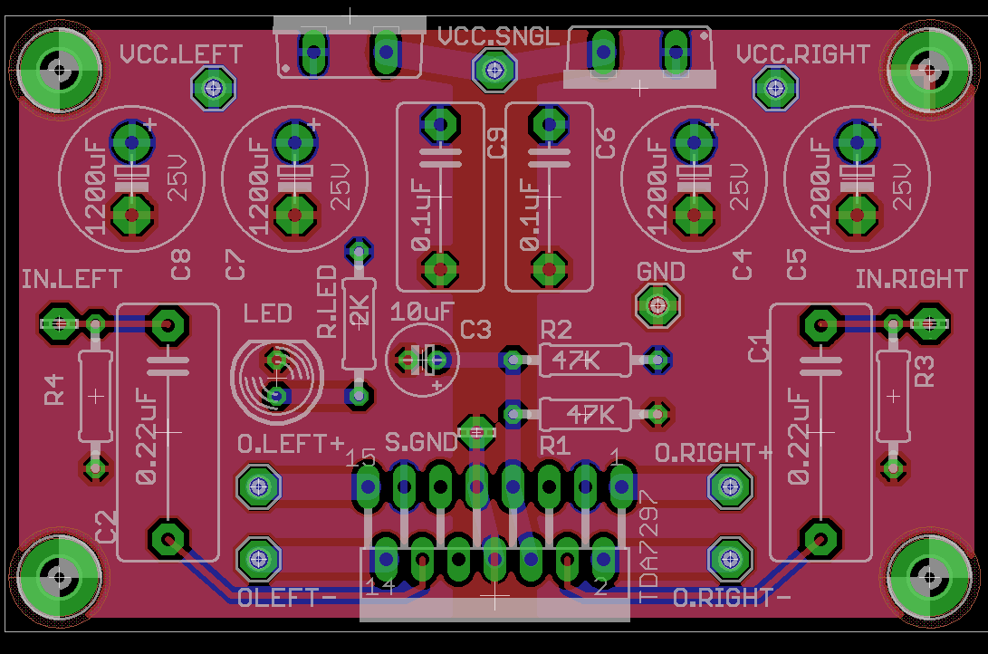

How does it look now? I would use two separate lm338 regulator board, or one with V+ going both ways from the regulator board. As I've replaced the larger caps with smaller ones the board got smaller as well.
I'm curious, why 470uF maximum? From my experience with ta2020 it's better to use more capacitance. The ta2020 datasheet also suggests about 180uF but I have about 5400uF and it also improved lower bass response after upgrading the 470uF it came with. Anyway the footprint of the smaller capacitors are good for 1200uF/25V Panasonic FR.
Yes, one ground is good. And two V+ is good.
I like your tandem pairs of caps on the rails! Very good!
I like that you have made the dual mono options available.
Edit:
Next, please install "input load resistor" to avoid a noise.
I will try to make the mods so you have these options.
Anyway, only me and activexp are interested in this board so far. Would anyone else be interested?

Oh yes. The input load will help. That's good.
P.S.

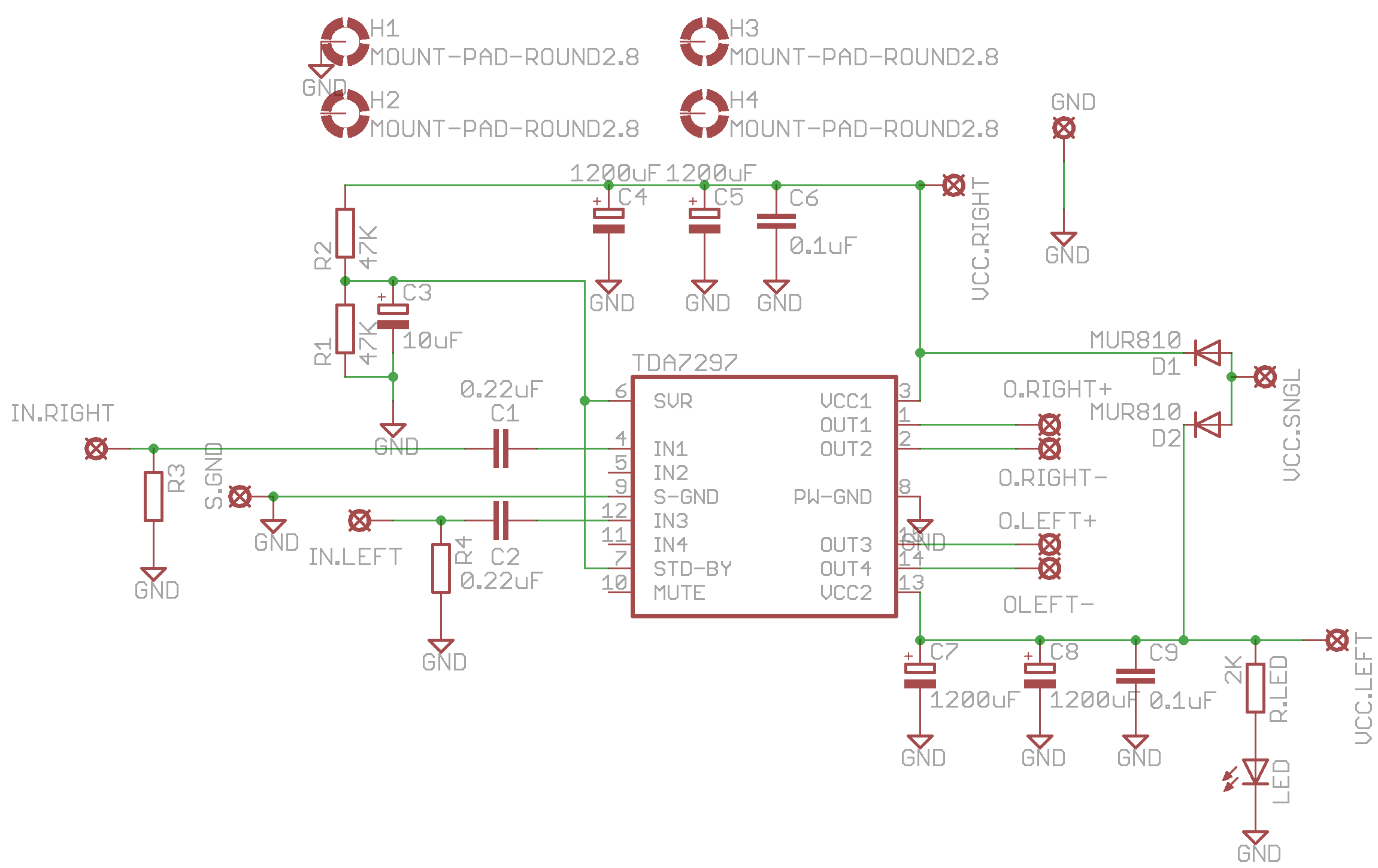

You know you can put a diode in the vcc-left via and put a diode in the vcc-right via to make a "Y" for using just one power supply, if you wanted to. And, in that case, R2 and Rled hooks up to main power.
I put a to220 footprint for the diodes, should allow for most kinds of diodes. 1n400x are rated 1A and that's right up there with the amp. It is internally limited to 2A (I guess 1A per rail).
It's getting pretty crowded on the board, I had to move the GND connection. Any ideas of it's ok there or should I move it somewhere else?

Yeah, get the 0.1uF (100n) caps closer to the amp and use 50v~100v size box caps, not the big 450v caps. So, anyway, using the normal size 100n caps will give you some more space for the power and ground connections.
EDIT: Also please add vias so that nice little Nichicon ES electrolytic or Elna Cerafine electrolytic can be used for input caps. The Nichicon is available in 0.47uF, and I think they make even smaller values too. The very smallest values of electrolytic has really great performance. The bigger ones, not so much. 🙂
