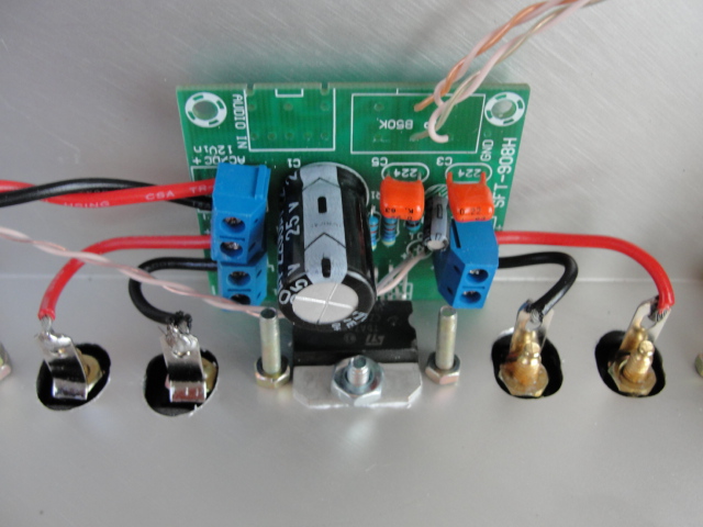

I'll eventually mount the amp on a permanent chassis. I'm wondering if the metal part on the chip is ground ? or do I need insulation if I'm going to mount it to the chassis directly (using the chassis as the heat sink)?
The exposed Copper in the corner by the thru-hole of your defective board is ground. As AudioLapDance recommended, cover it with electrical tape or get some clear fingernail polish and brush two or three layers on the exposed area to cover the exposed Copper. If anything, just seal it to keep the Copper from oxidizing.

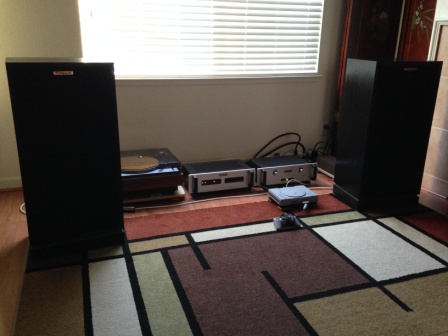

By the way, my friends and I got together this weekend to compare the TDA7297 amp to my min setup using the ARC LS7 tube line stage amp and refurbished, EFB-modified Dynakit Stereo 35 6BQ5/EL84 tube amp. I intentionally kept the Stereo 35 and TDA7297 amps tucked behind one of my Klipsch Forte II speakers, so they couldn't see which amp was connected, and I had my LS7 powered on. We played several great jazz and rock LPs, mainly reissues on heavy virgin vinyl. They are familiar with my Stereo 35 tube amp and like it very much. To their amazement, they couldn't believe it when I told them I was using the TDA7297 amp in place of the LS7 and Stereo 35. We compared both amps (nothing scientific, so please spare me the lecture on double-blind listening tests), and the TDA7297 did an admirable job. The large soundstage, the warm tonality, impressive bass response and overall musical presentation really won them over. With efficient speakers, this amp is capable of performing as a fine main amplifier.
Thanks for info Rich. I'm still listening to it in stock form. Just really enjoying every song played through it. Currently trying a 12V 10A no name SMPS which also sounds very good. I do feel the SMPS gives a sound more resemble class D while the linear supply gives a more relaxed analog sound (a little more tube like).
About the copper thing, the pics does not show it all. Actually it is about 1/2" wide running along all the length of edge on the left speaker connection component side.
I found the metal part of the chip that bolted onto the heat sink is ground (V-). I think I can safely use the chassis as heat sink when I mount it permanently without insulation.

I don't think it worth the hassle to contact the seller to exchange the board. I de-soldered those parts that were sitting over the big piece of copper and used a bigger drill bit to cut away excessive copper so the components are now not shorted. After the surgery, everything works as it is suppose to be. Please see pic below.

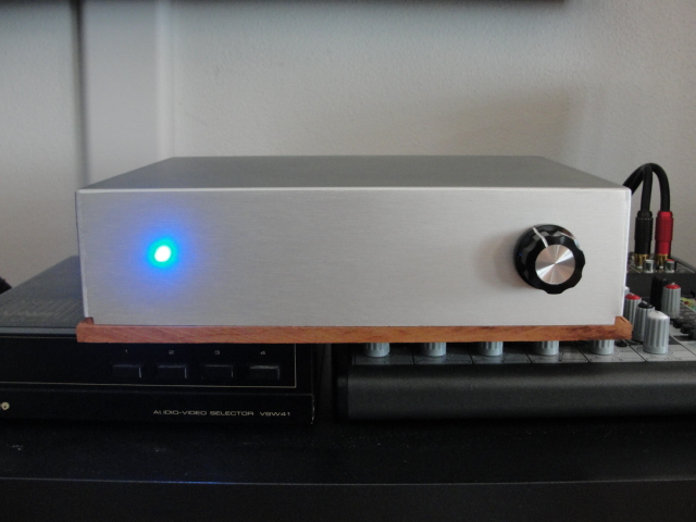

I have not got around to housing my amp and the only modding I have done is to dab a black felt tip on the annoying blue led. Strange, I'm sure it makes the amp sound better.😀
Hey!, I'm a little sensitive about my apperance.
Honestly I don't have the gut to show my face therefore I admire you in that aspect. I guarantee that you are 10 times more handsome than I am.
I'm fixing to put the amp inside a chassis. The blue light doesn't bother me. Actually, it projected the Neptune to the ceiling when I had all the lights off last night.😛

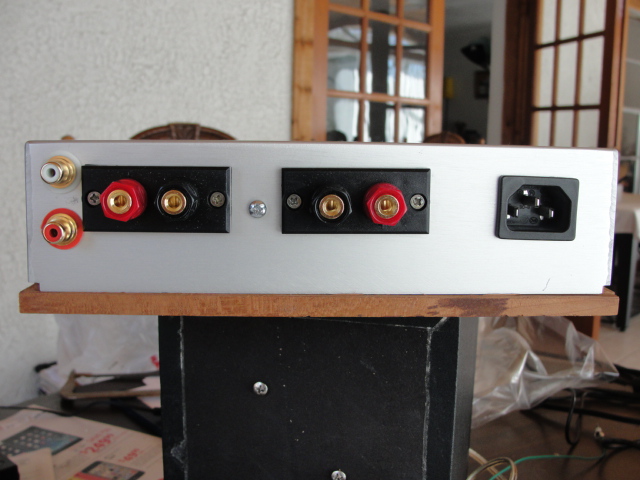

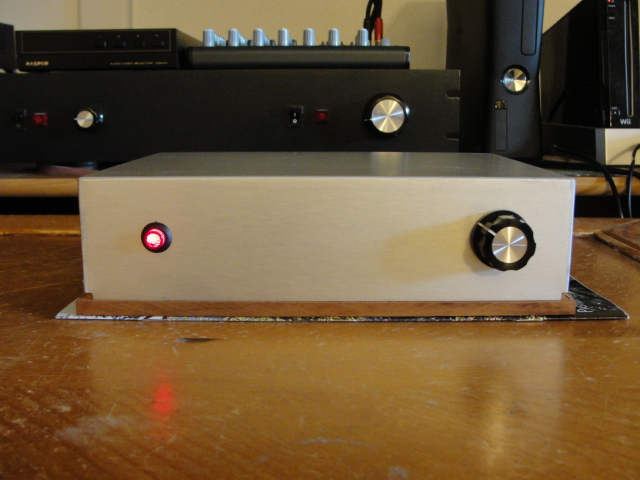

in a housing now...

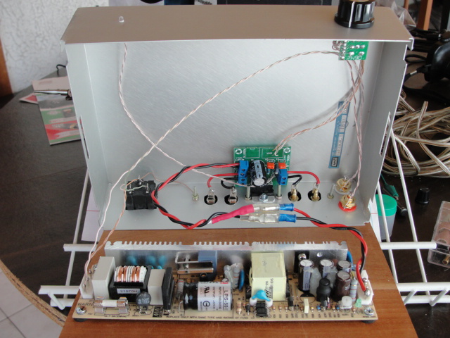

Well, don't laugh....I put it inside a chassis. The SMPS is a Meanwell 12V 4.6A supply got from a local surplus store. As you guys can see, the board is still all stock and the diode was not even bypassed. I took the stock heat sink off and cut off part of the PCB so the chip can be mounted directly at the chassis. The chassis is perfect as a big heat sink.
The pot is an old pot salvaged from the sonic impart 5066. It also acts as the power on/off switch when the volume is turned all the way down. I noticed some volume imbalance between L/R. I've probably forgotten the reason I took down this pot was the channel imbalance. I may put a regular power switch and use the stock pot instead (which is L/R balanced).😛

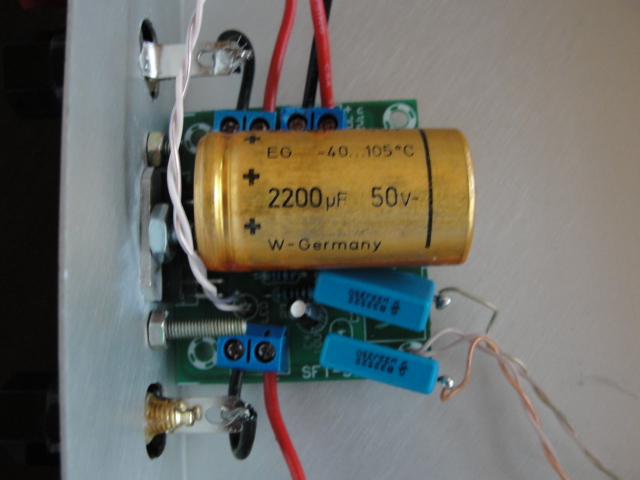

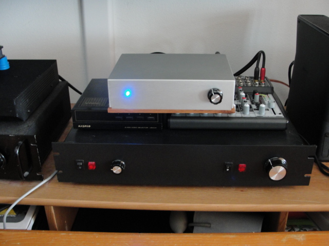

I have been fuzzing (messing) around this amp on and off past few days. I didn't like the salvaged pot so I decided to use the stock pot. I also removed the diode and shorted it with a link. The 2200uF tank cap was replaced with a German ROE gold 2200uF 50v NOS cap. I used this cap in my JLH class A build and I like it. Input caps were replaced with Siemens B32522 MKT type, same value at 0.22uF. I also changed the power switch with RatShack 275-0009 LED lighted switch.
I feel a bigger sound stage. Bass is strong and tight. The amp is very comfortable to listen to. The wife is shopping and the volume is up now....😛
